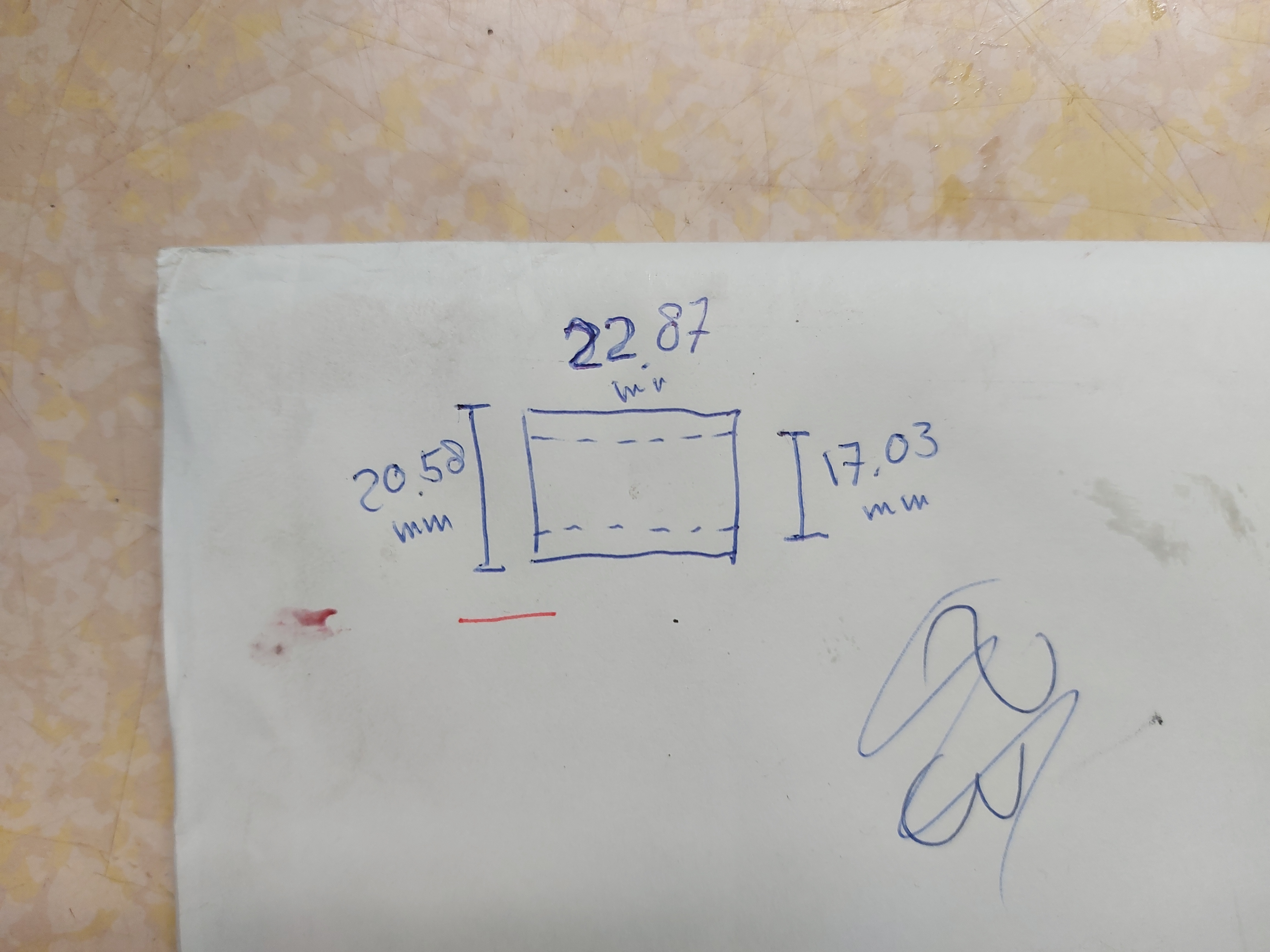

Hello David,
Steel bush:
Steel bush:

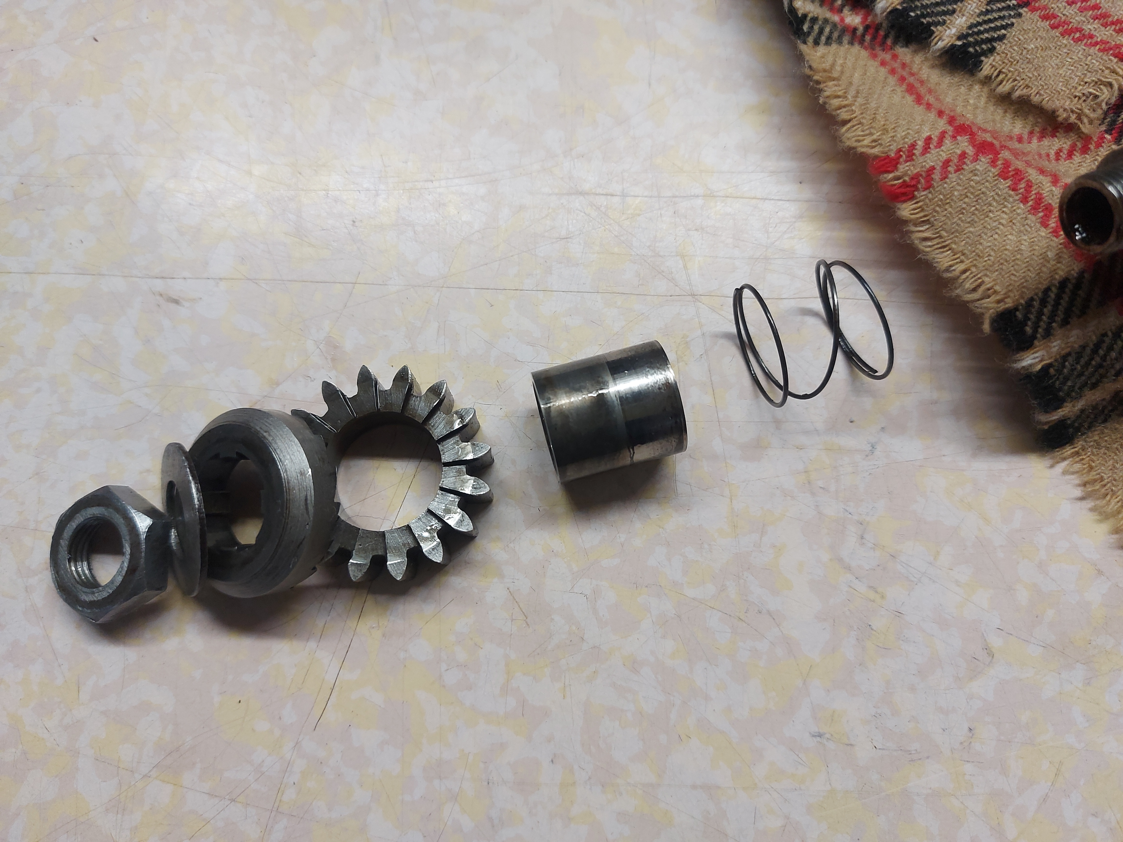

Sorry but wrong bush. I should have looked at your photos.
The bush that I need dimensions for is the bush that goes onto the mainshaft behind the nut, and the ks pinion gear freewheels on it. Just the length and whether there is a stepped shoulder for the spring. If so the shoulder dimensions.

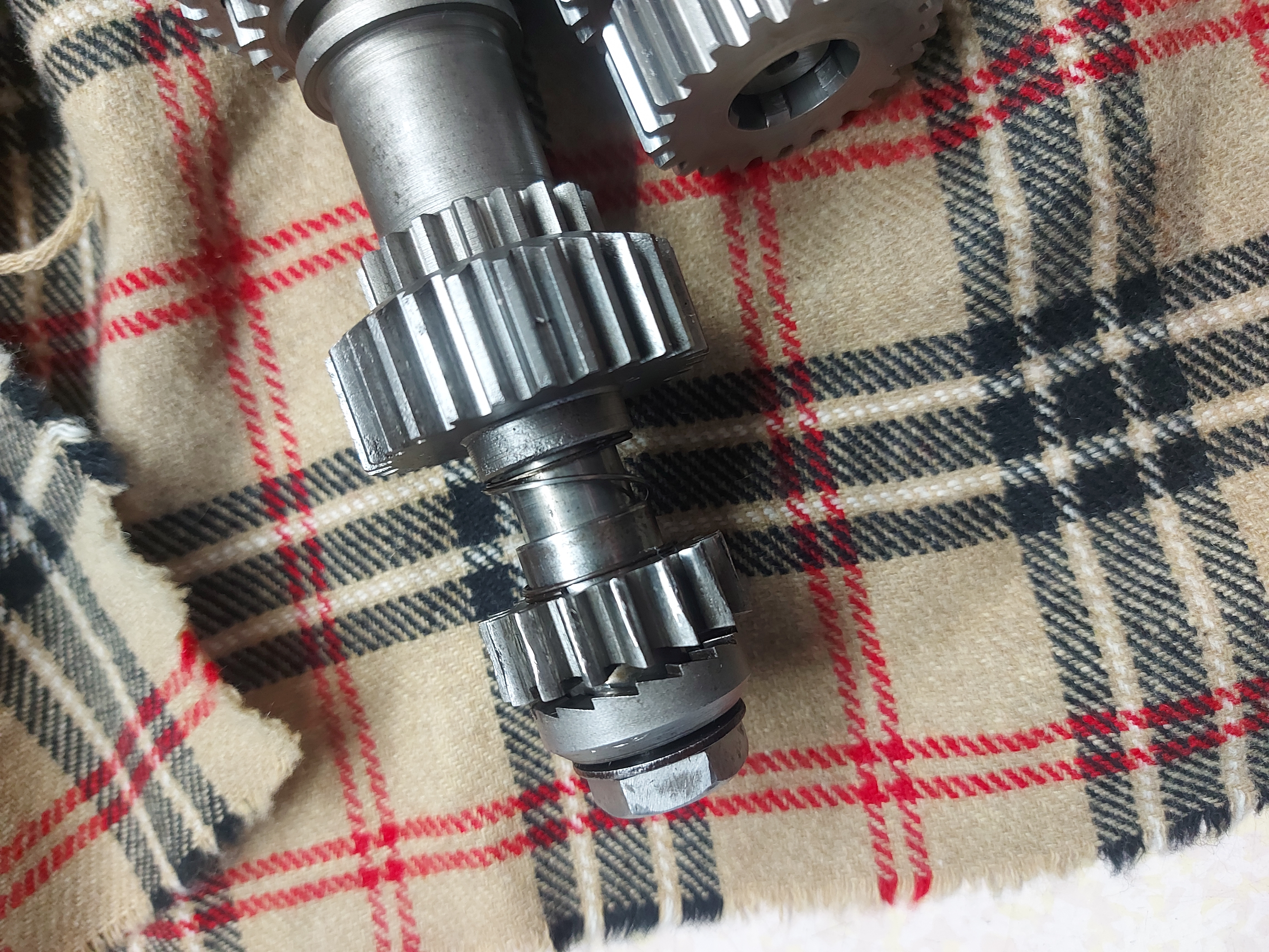

that 'floating' bush that works with a light spring ?
- Posts: 4891
Re: Re: CP gearbox
this one I think..
No shoulder just a straight piece of 'tube'

yes that is the bush I was after. a quick lathe job will have it.
