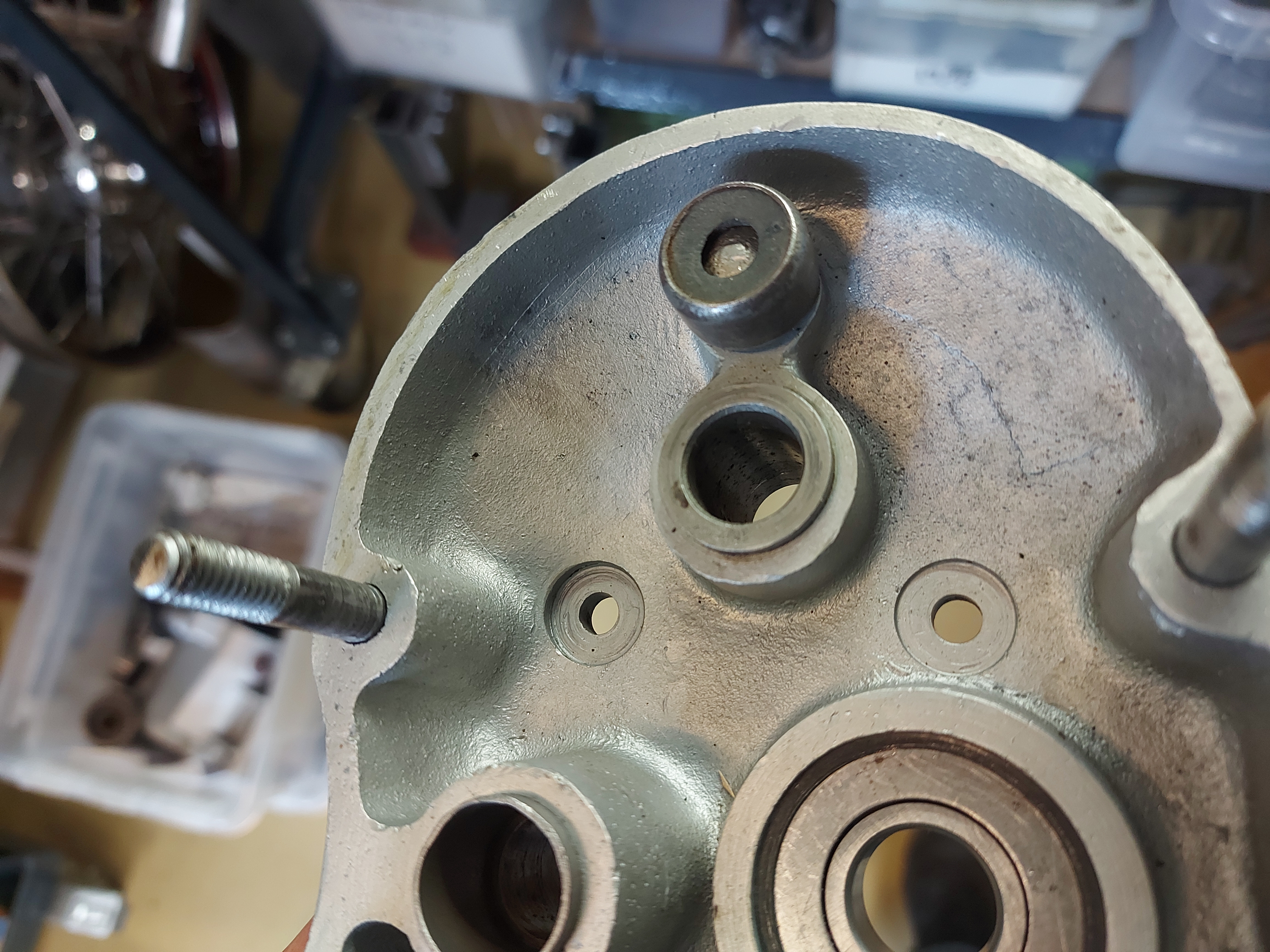

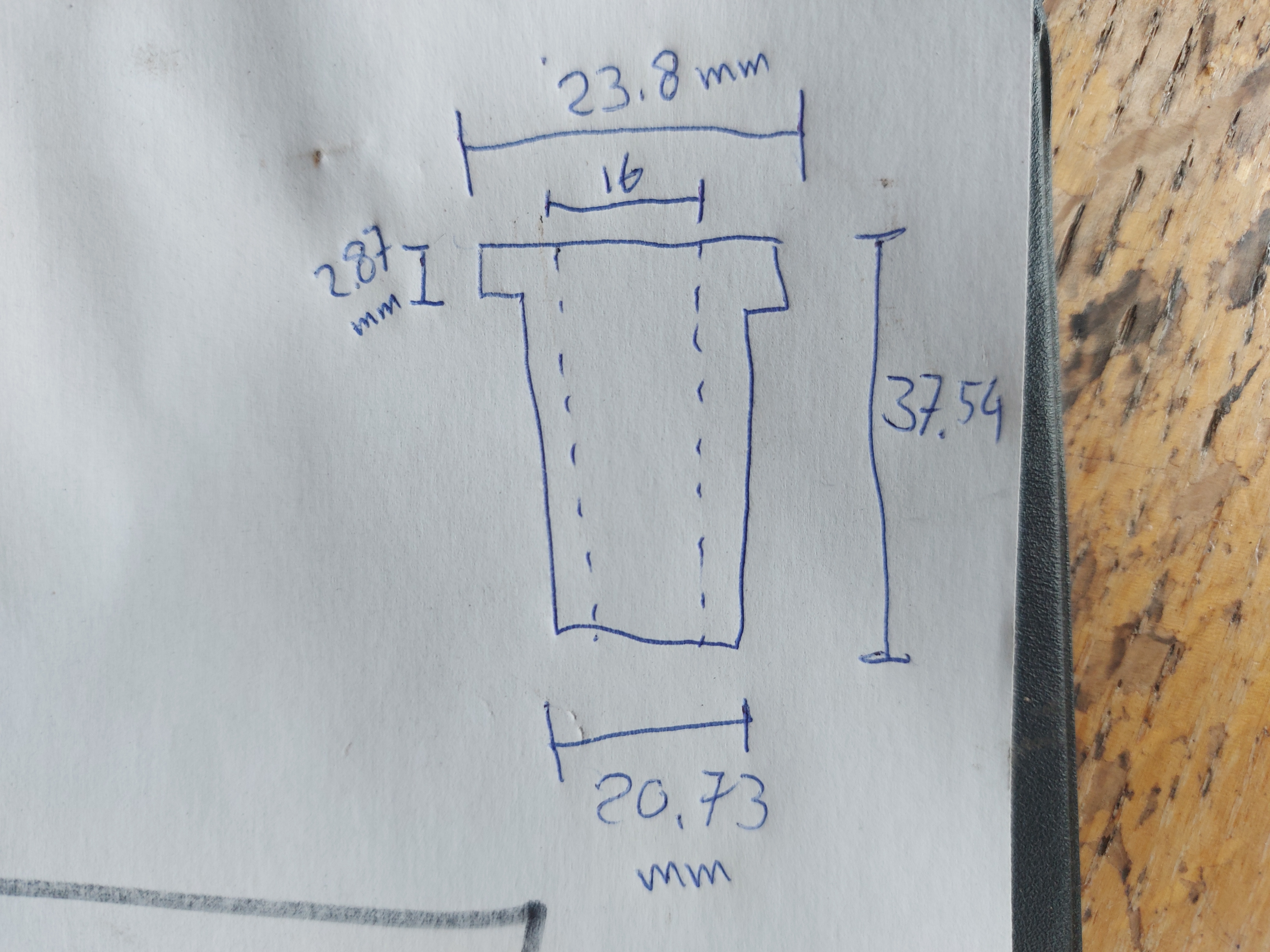

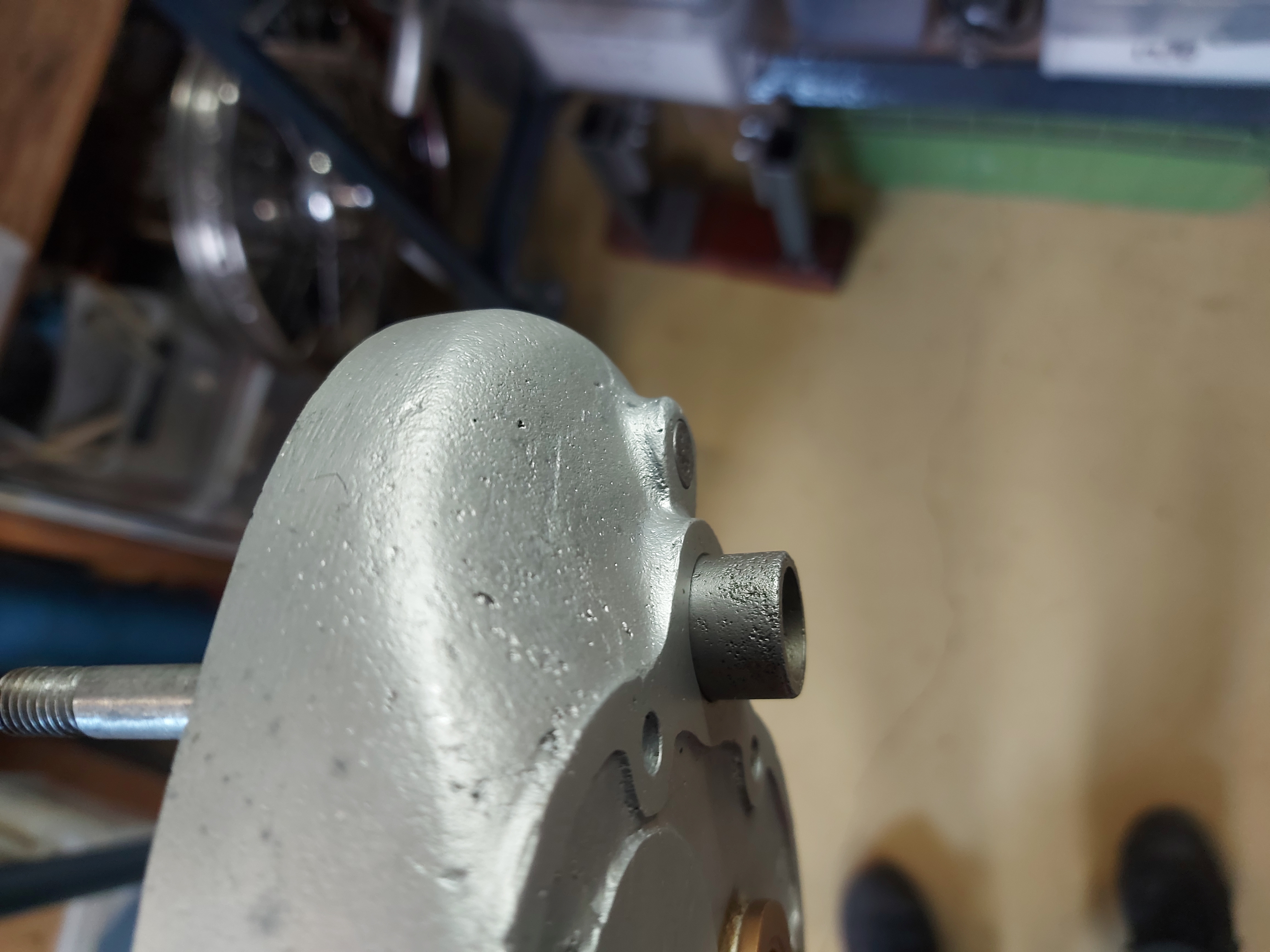

Can anyone provide dimensions for the kickstart ratchet pinion bush for a CP gearbox, part no 3193-33. In particular the length of the bush and any shoulder on the bush. Draganfly are currently out of stock. Thanks

Hello David,
Steel bush:

thankyou very much, that is just what I need. it will now not take long to make one.
