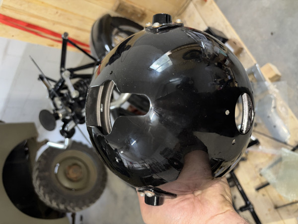

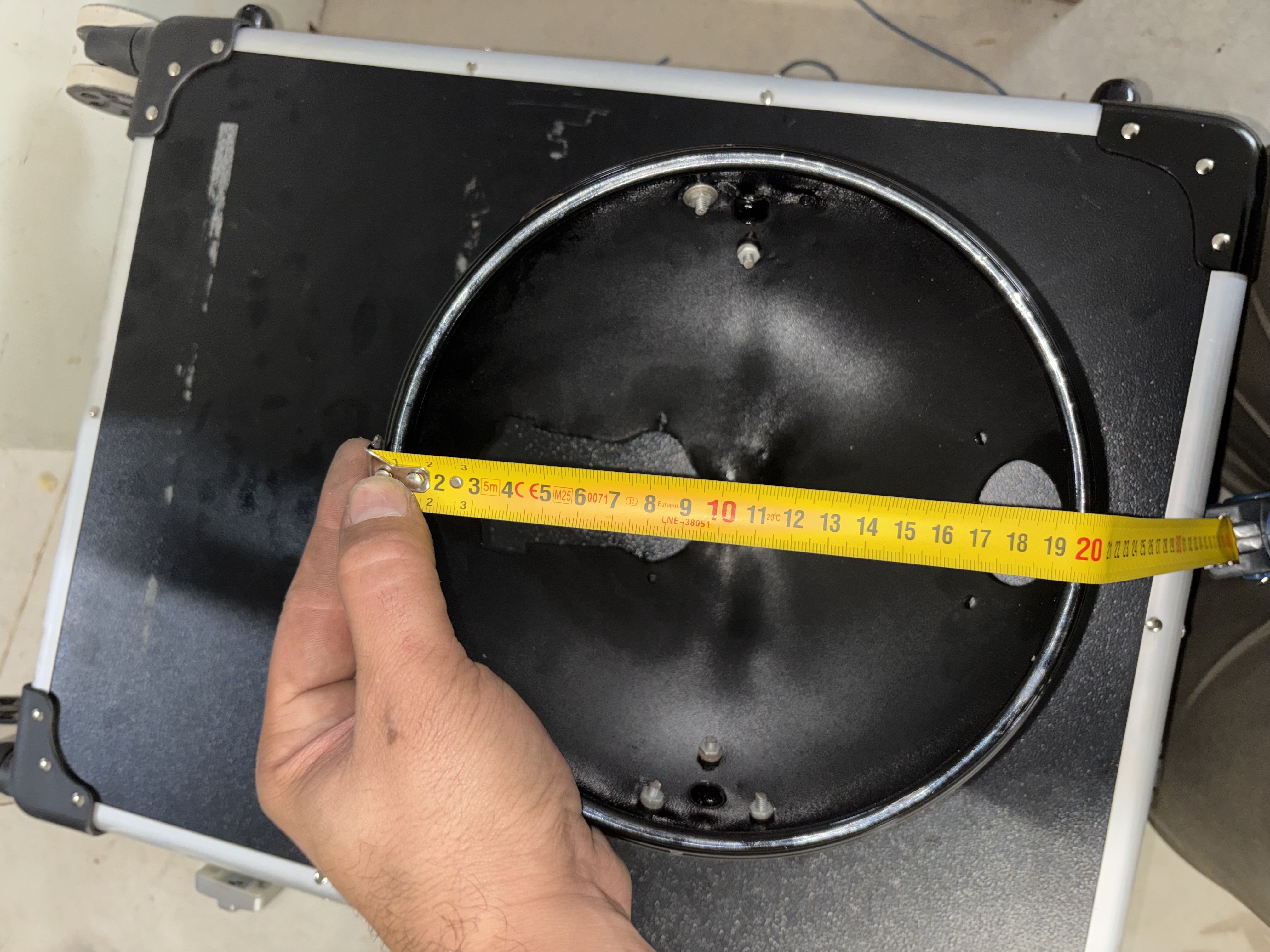

The headlamp i have is the quick detach one which i think its not historically accurate? it is 8" which should be correct though.
The lamp itself is very lose inside, something doesnt feel right.
Also I'm not sure if i'm missing out something when installing the inspection lamp,
I was expecting some holes like it shows in this post: viewtopic.php?t=15255
Posts: 2146
Re: Project 1934 VG 500
Your panel is for the 1932-38 lamp, your lamp is the 1939-50 type bayonet fitting.
There should be 2 thin nuts 1290-26 holding the sprocket on, as per the parts book.
I don't recognise your headlamp shell, obviously an early one given the riveted side sockets. If it is a Lucas one there will be a model number stamped at 6 o'clock at the outer edge
Posts: 5259
Could you take some more pics of the headlamp shell Albert?

Some more pics and a video of the head lamp.
Thank you all for your help!
