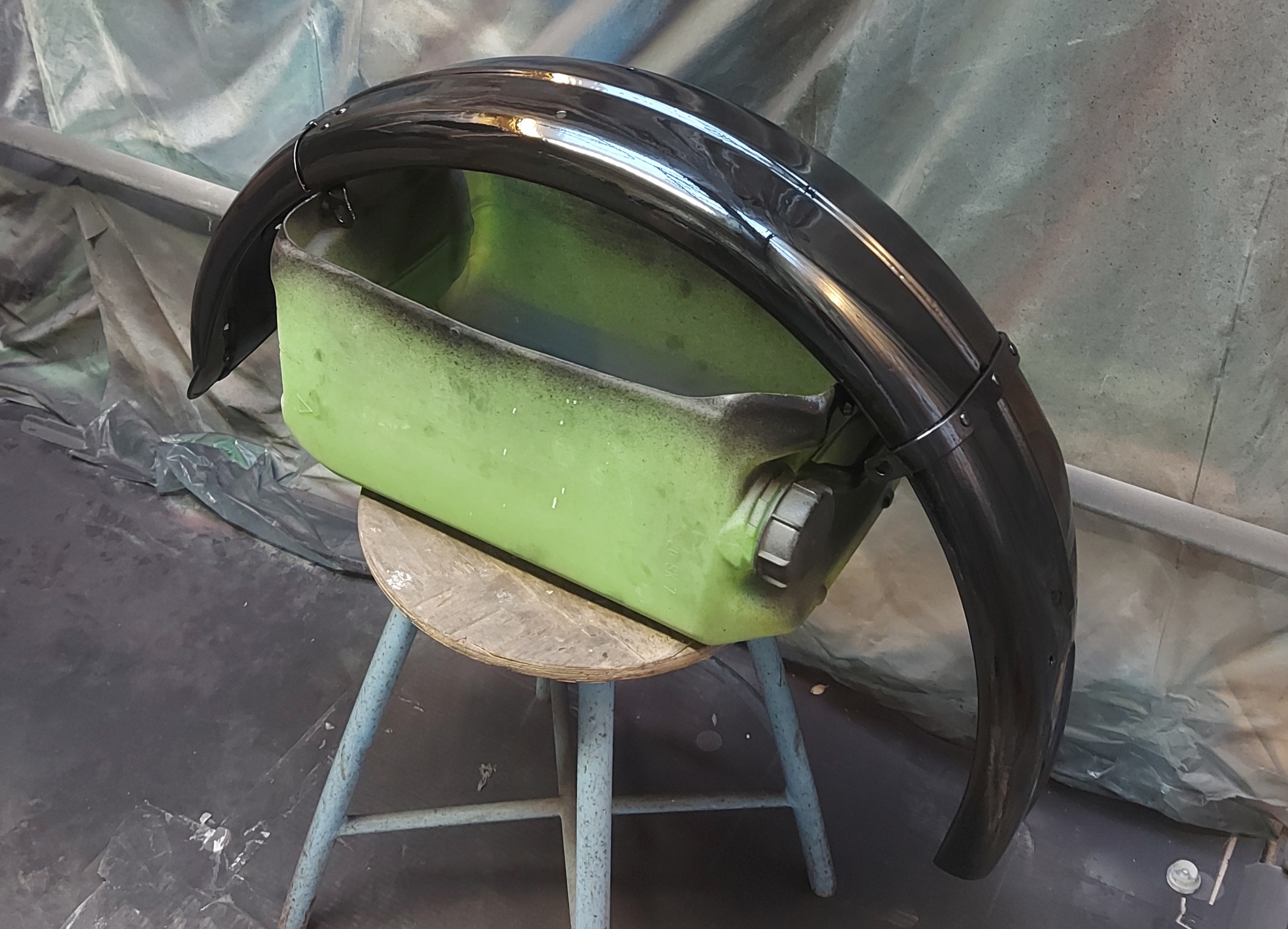

mucking about trying to get a wng mudguard fitting the teles.
forced two dents sideways for the tele covers :
My mudguardstaypincher comes in handy again.
Needs a big lever :D
well..... I think its in the centre now :)

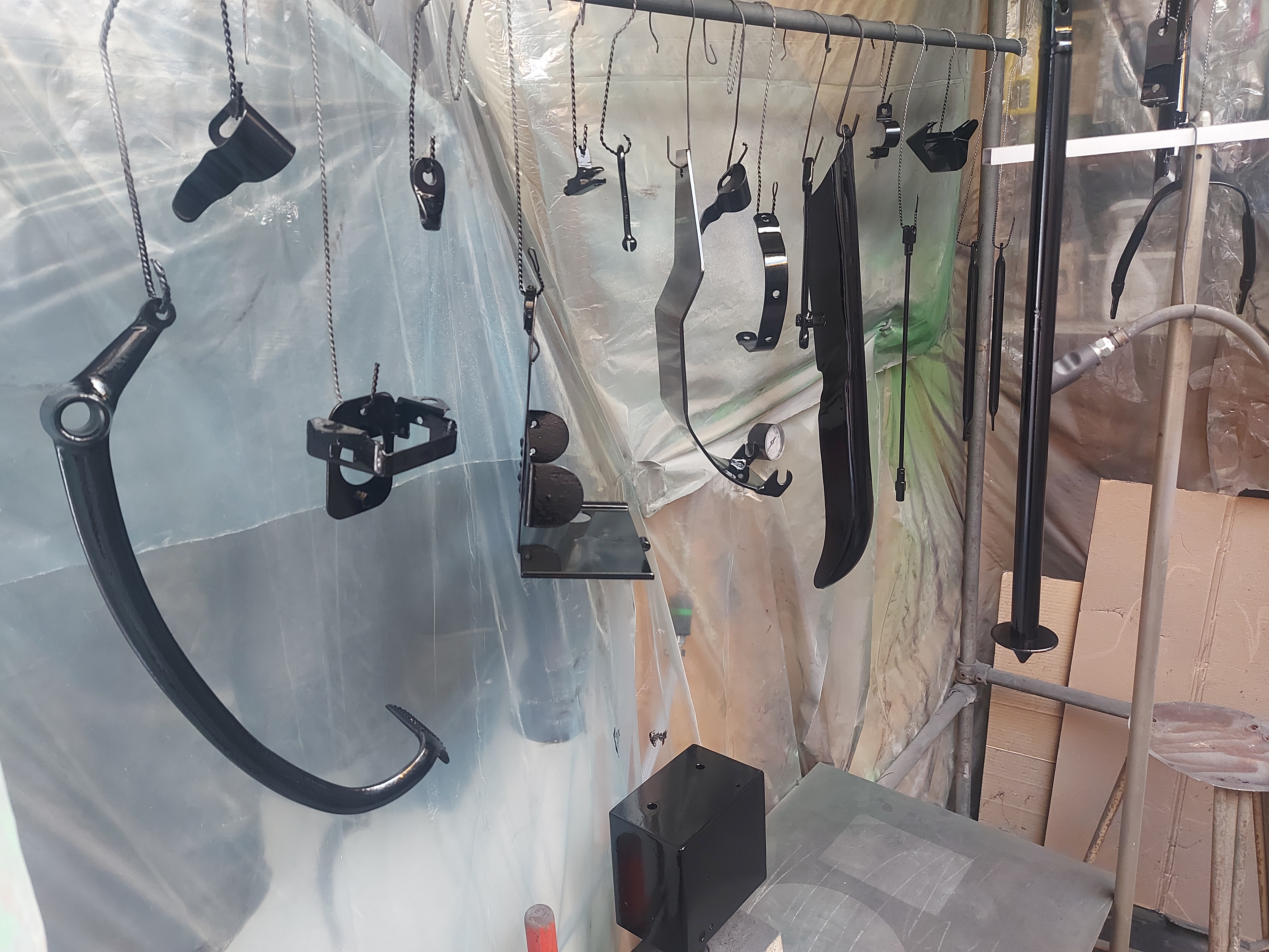

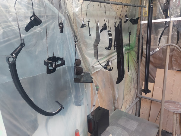

slowly I am getting there....
numerous small bits ready for primer :D

Assembly day is nearing :D limit myself not to do that before the paint has fully hardened ...
