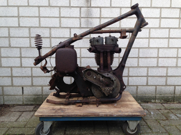

I found half a WNG frame + crankcase in the legacy from Carlo Jusche, AKA Mr. Bulgaria for members of a certain age...
Turned out that frame and engine were 'matching' which is a rarety with WNG models.
Ah! Oh! well I felt more or less compelled to build a proper WNG out of the remains because of this.

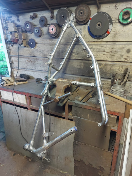

So I went ahead and repaired the frame, that took some time.

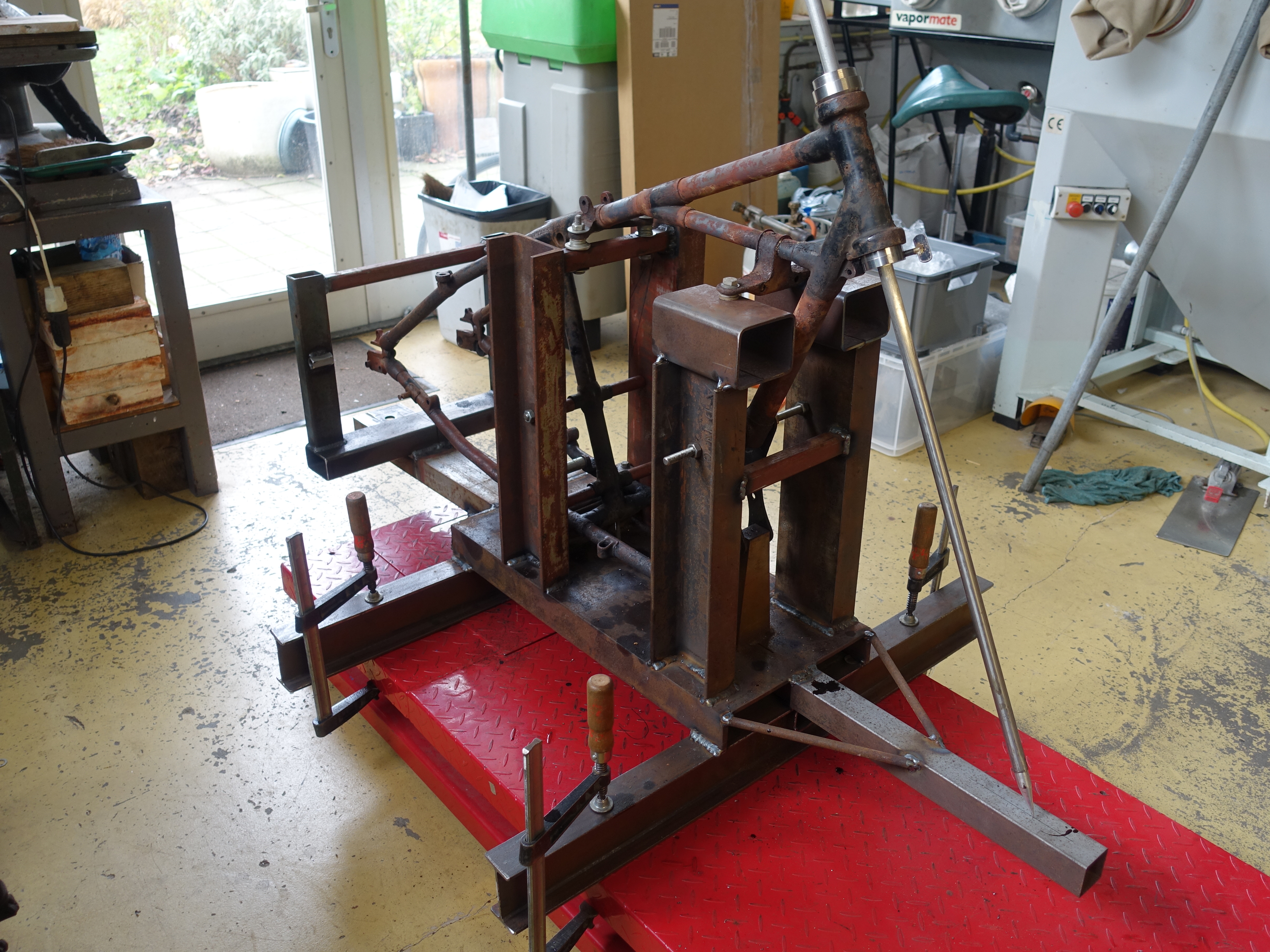

Had to straigthen it out 'a little' so the mould I made for the first WNG came in handy.

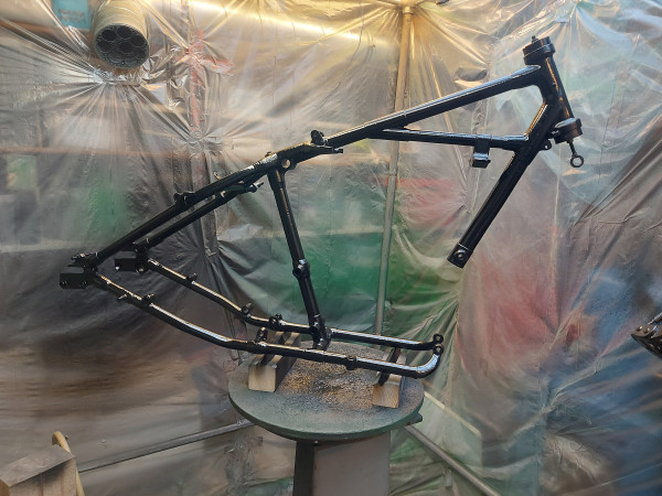

cleaning up.
spraying.

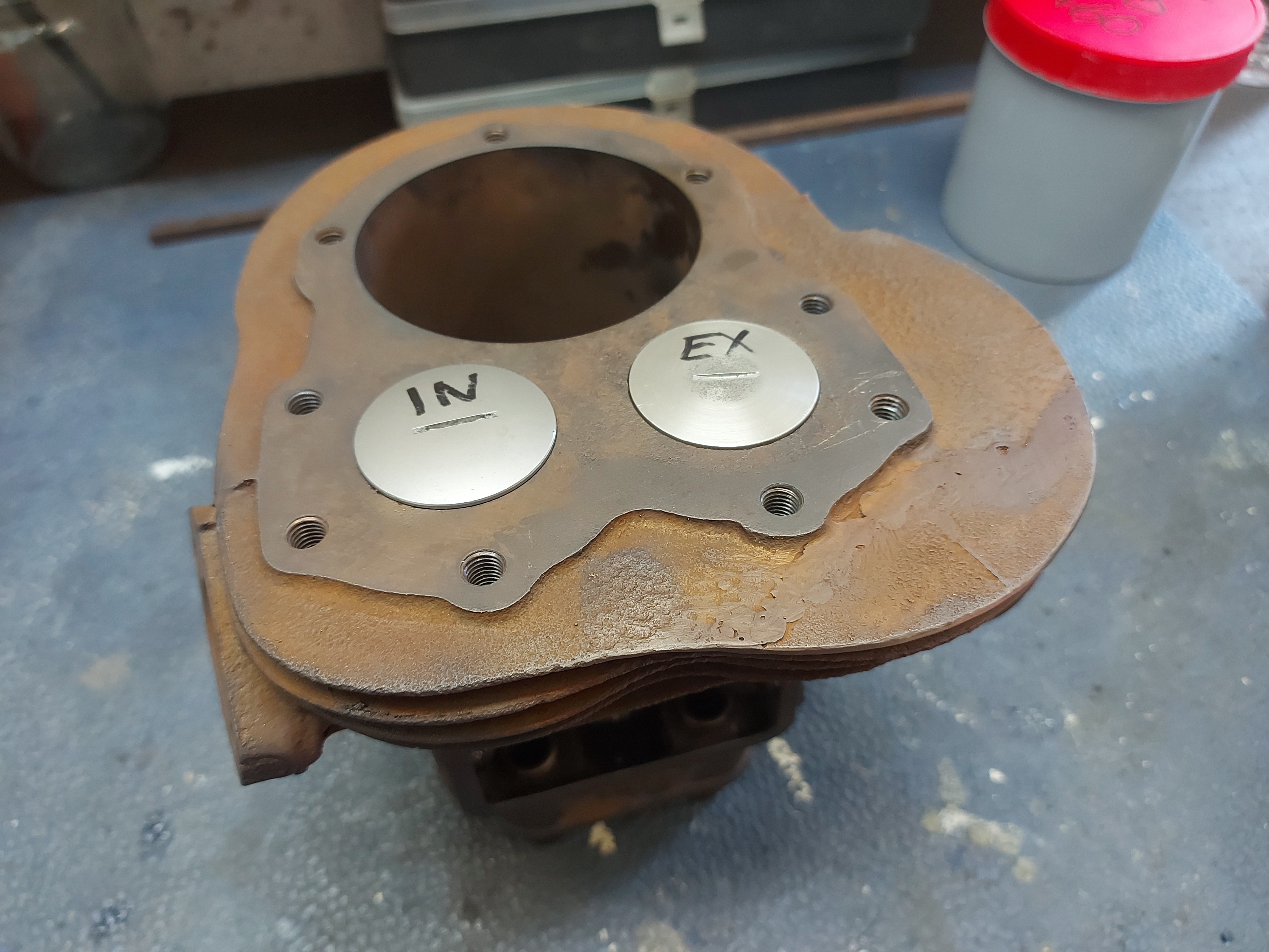

some welding.
fitting new guides.

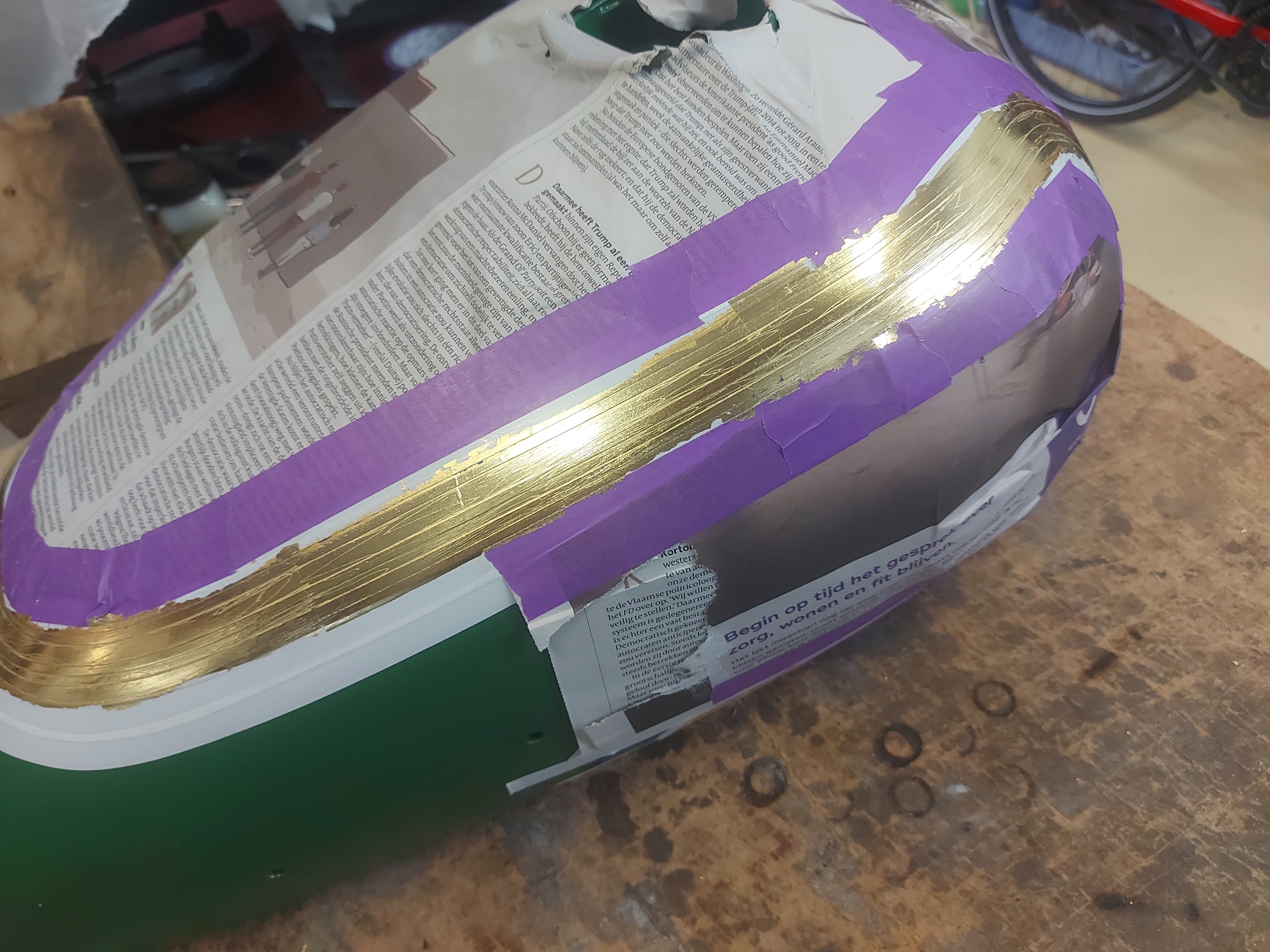

Some pinstriping with 24krt gold leaf.
but I did not like it so I wiped it again....I'll be back!

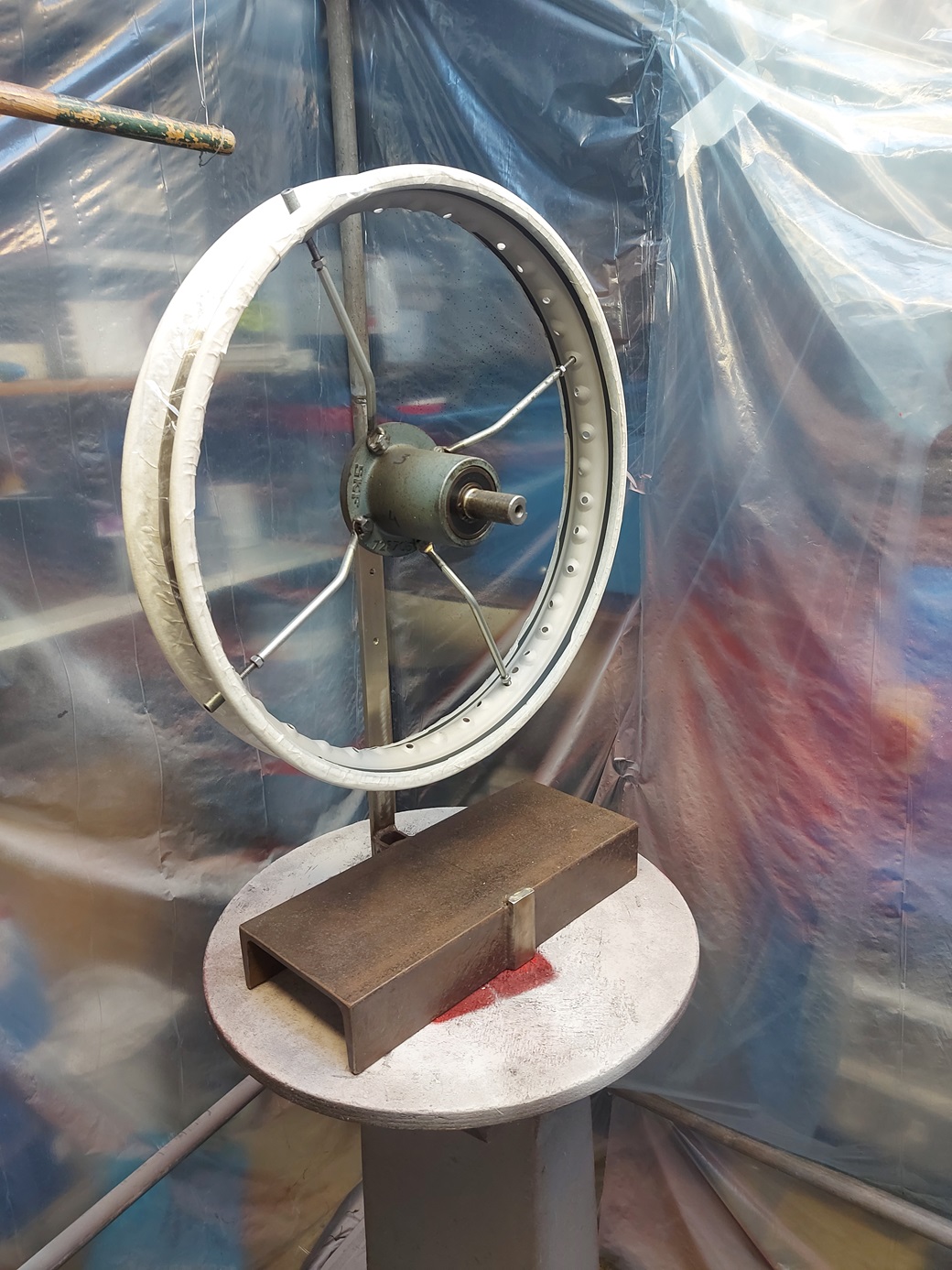

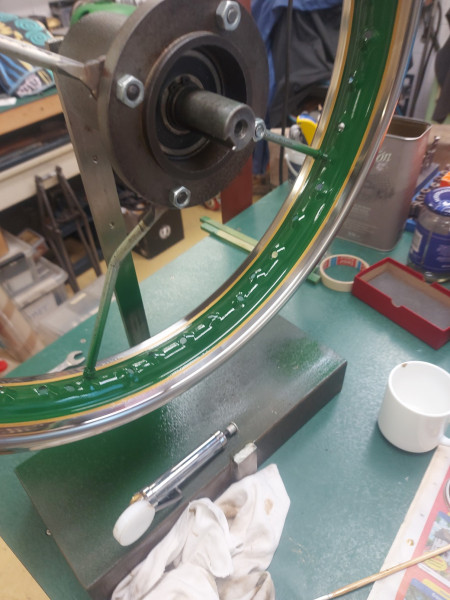

Devon rims painting.
first step is dry blasting the centre for better paint grip. (stainless rims)
taping the sides. made a spray frame for it to handle it, one for each rim.
4 spokes upright to be able to use the pinstriping tool that needs to be held at 90 degree.
leaf green the export color.

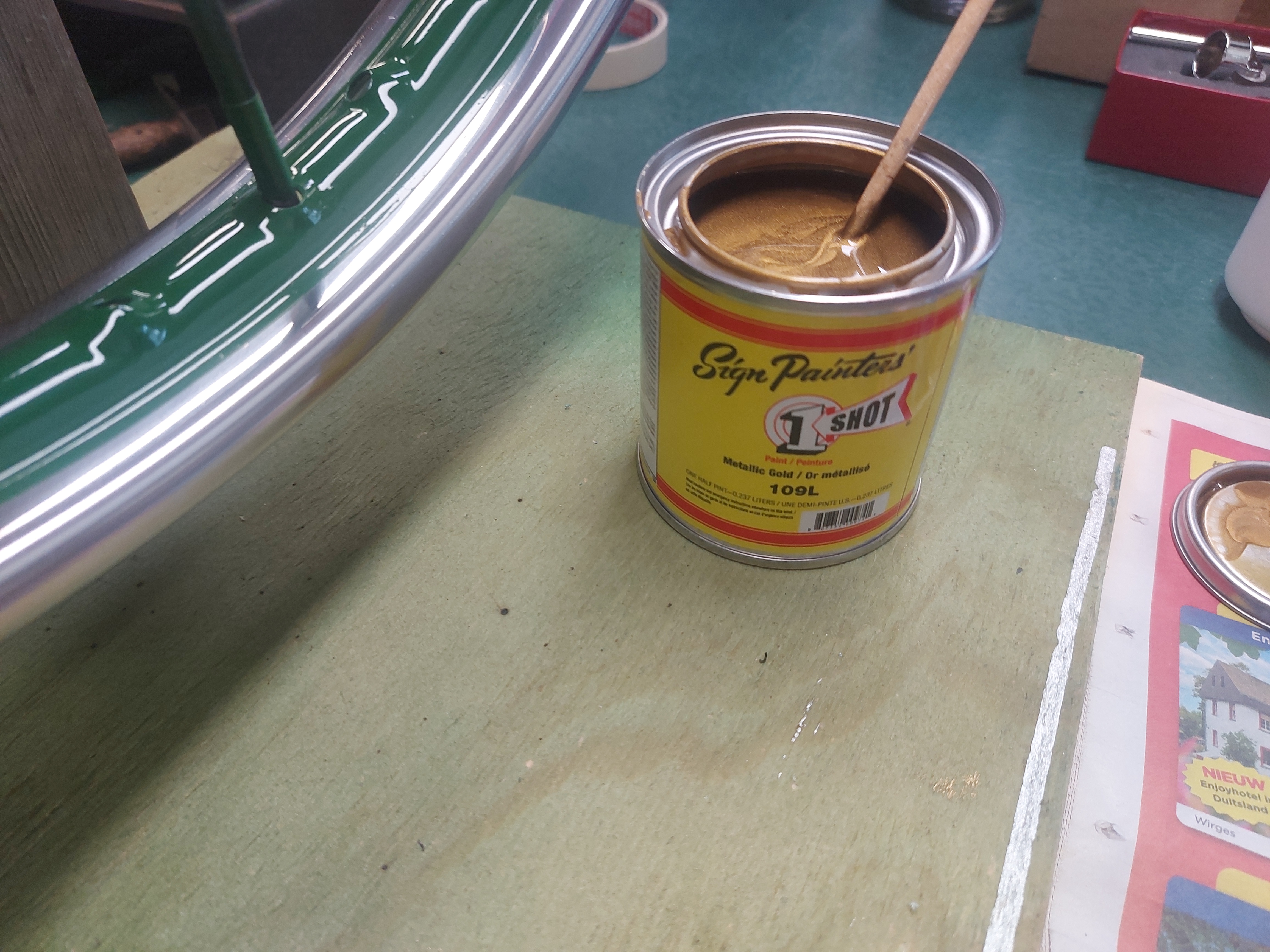

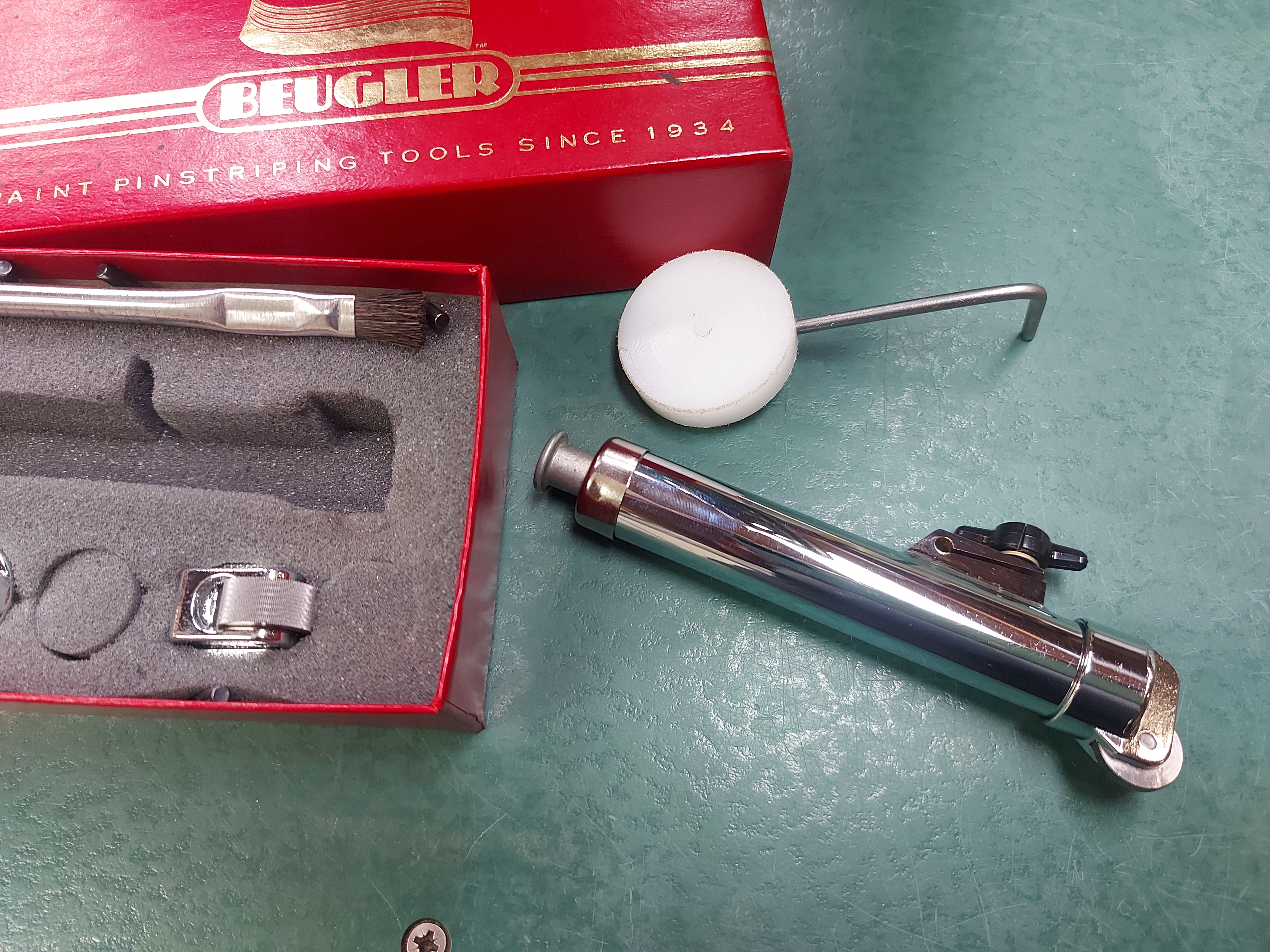

Beugler pinstriper and 'One Shot' pinstripe gold paint.

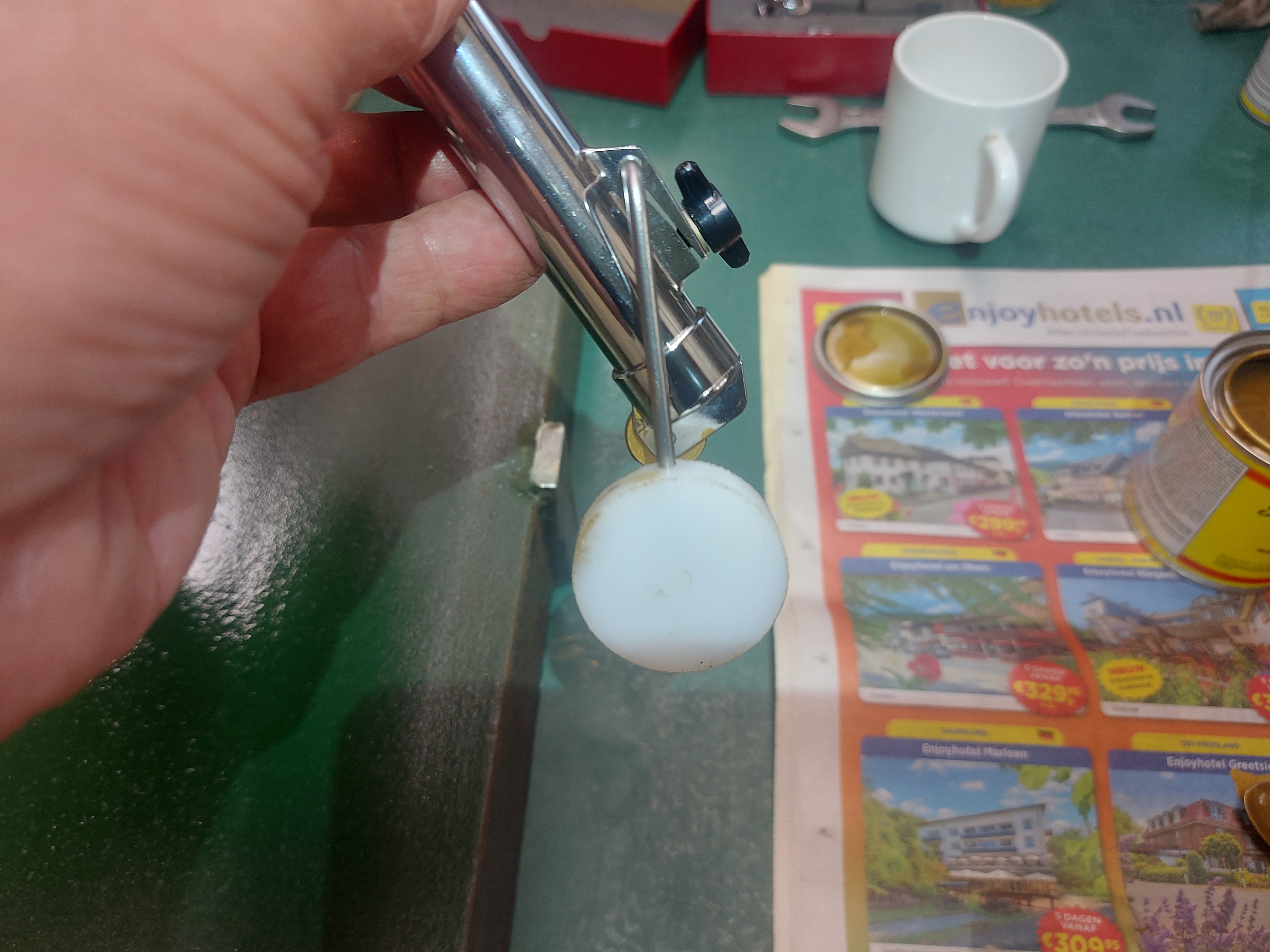

made a guide paddle from teflon to keep it stable along the side of the rim.
easy ! :lol:
on to wheel building, turned out that it's best to have it fitted in the forks.
atm building the forks....

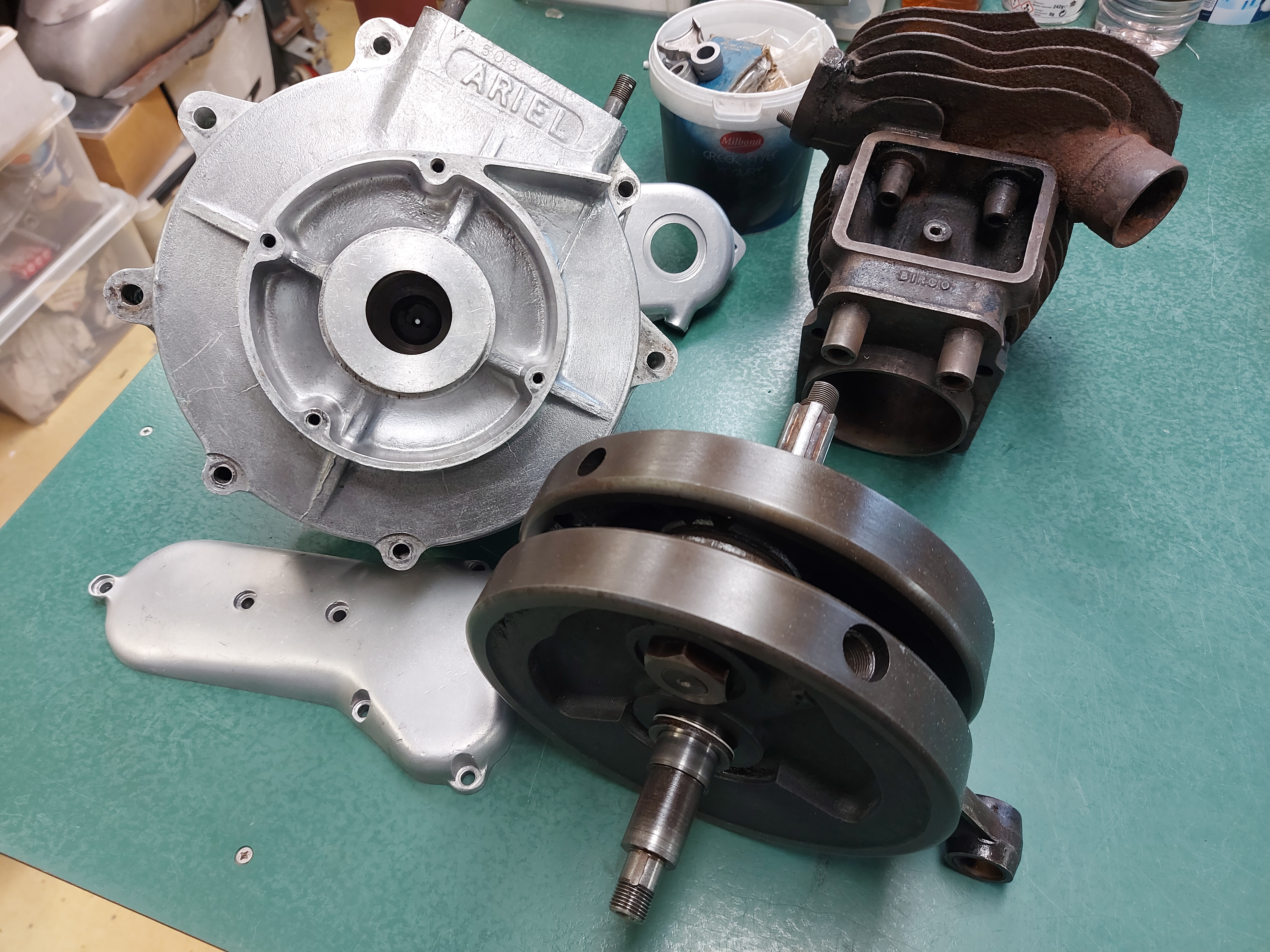

The Engine:
after some cleaning.
VB , a fitting engine code ! it was originally exported to Denmark.

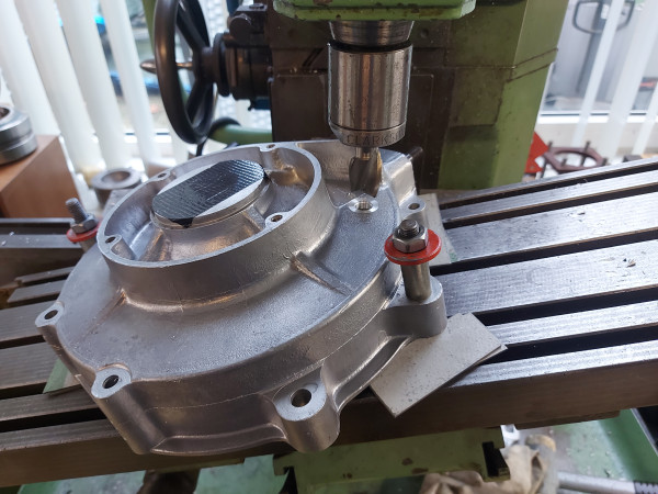

adding vent hole

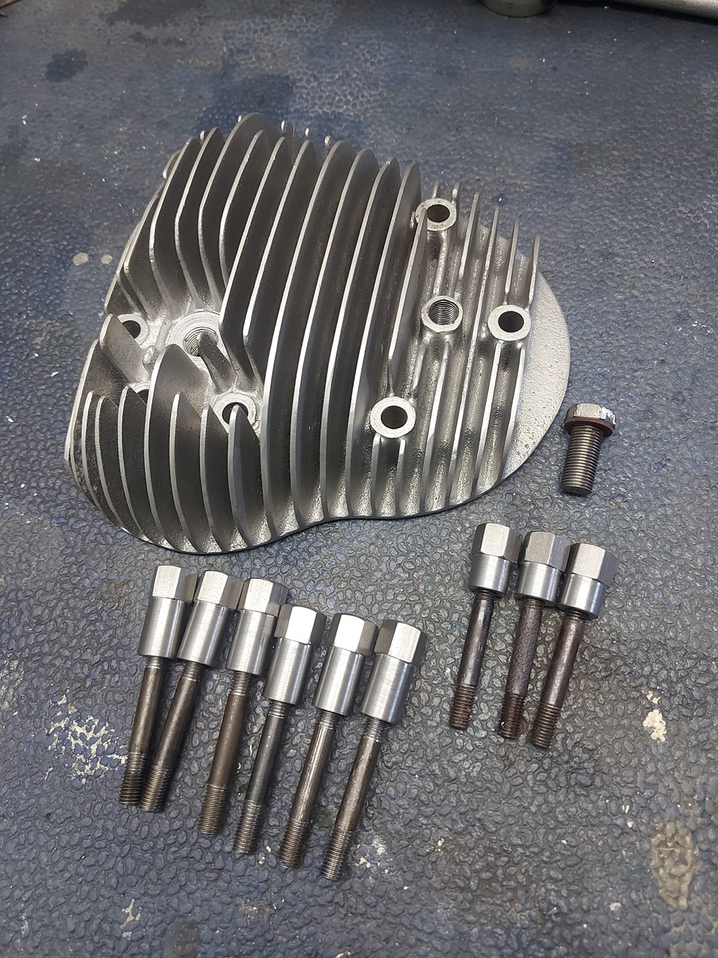

cilinderhead sponsored by John Bradshaw. Thanks!
made longer headbolts.

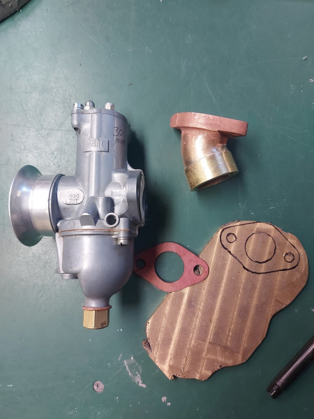

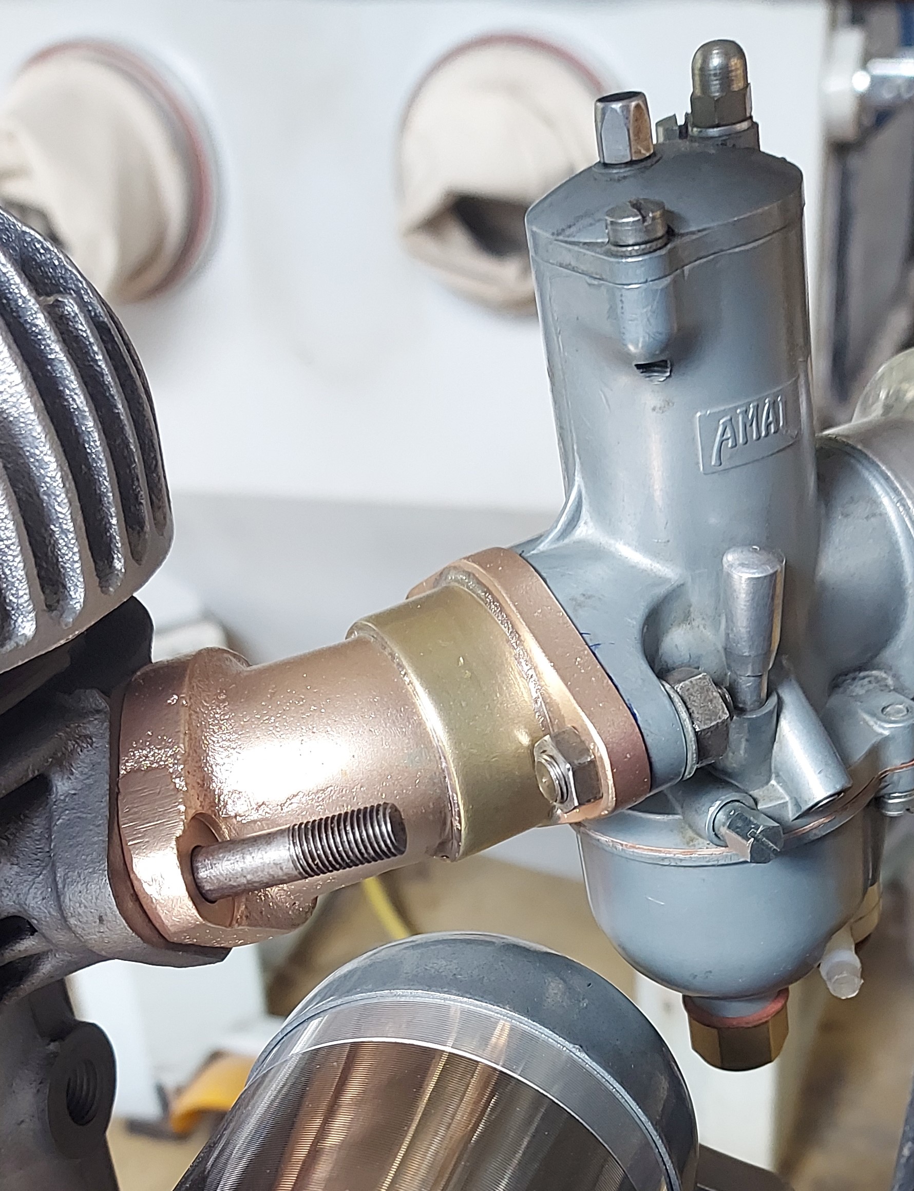

making a inlet elbow from a piece of water tubing a Vincent Comet inlet stub and some thick copper plate to fit a Concentric above the magdyno.
silver soldered.
