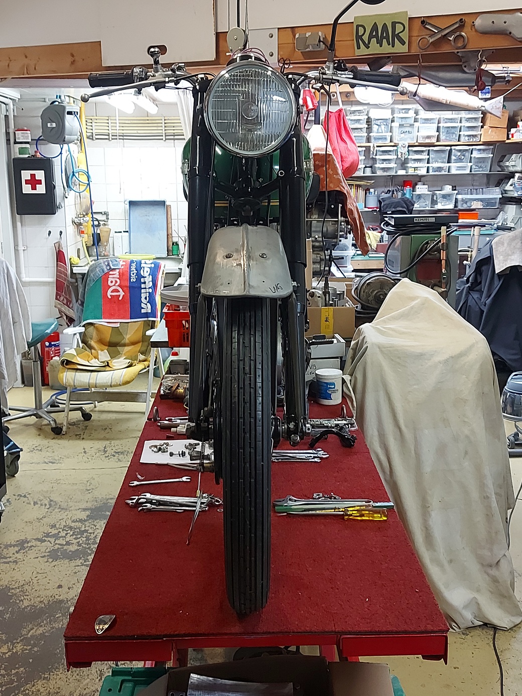

Hi Simon, welded the rim to the guard, like I wrote : fiddling!

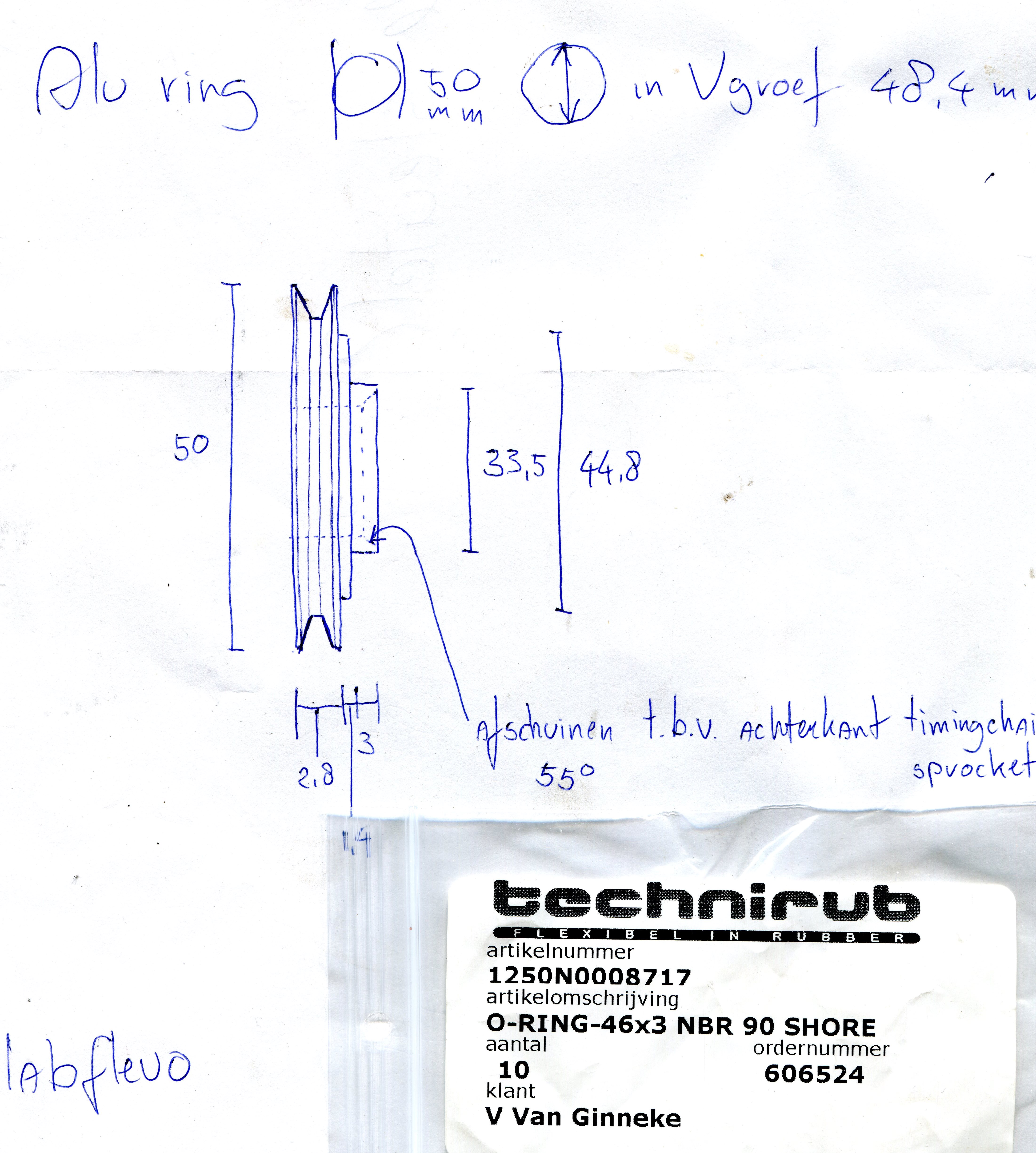

drawing for the O ring seal:
The inside measurements can differ a few tenth (mm) between different TS cases

Re: VB build
Thanks for the dimensions.
I will give this a try next time I have got the magneto off.

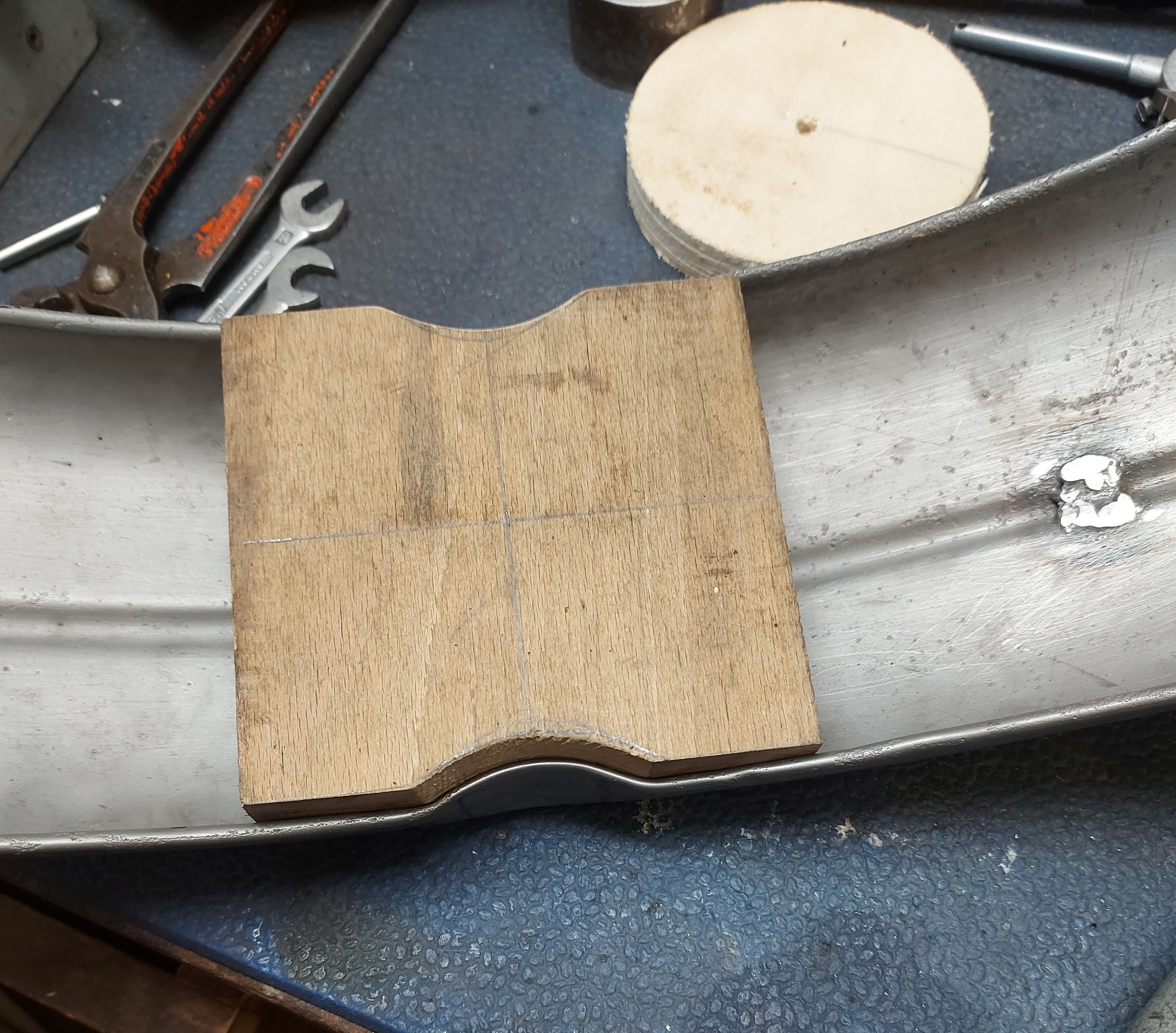

mucking about trying to get a wng mudguard fitting the teles.
forced two dents sideways for the tele covers :
My mudguardstaypincher comes in handy again.
Needs a big lever
well..... I think its in the centre now

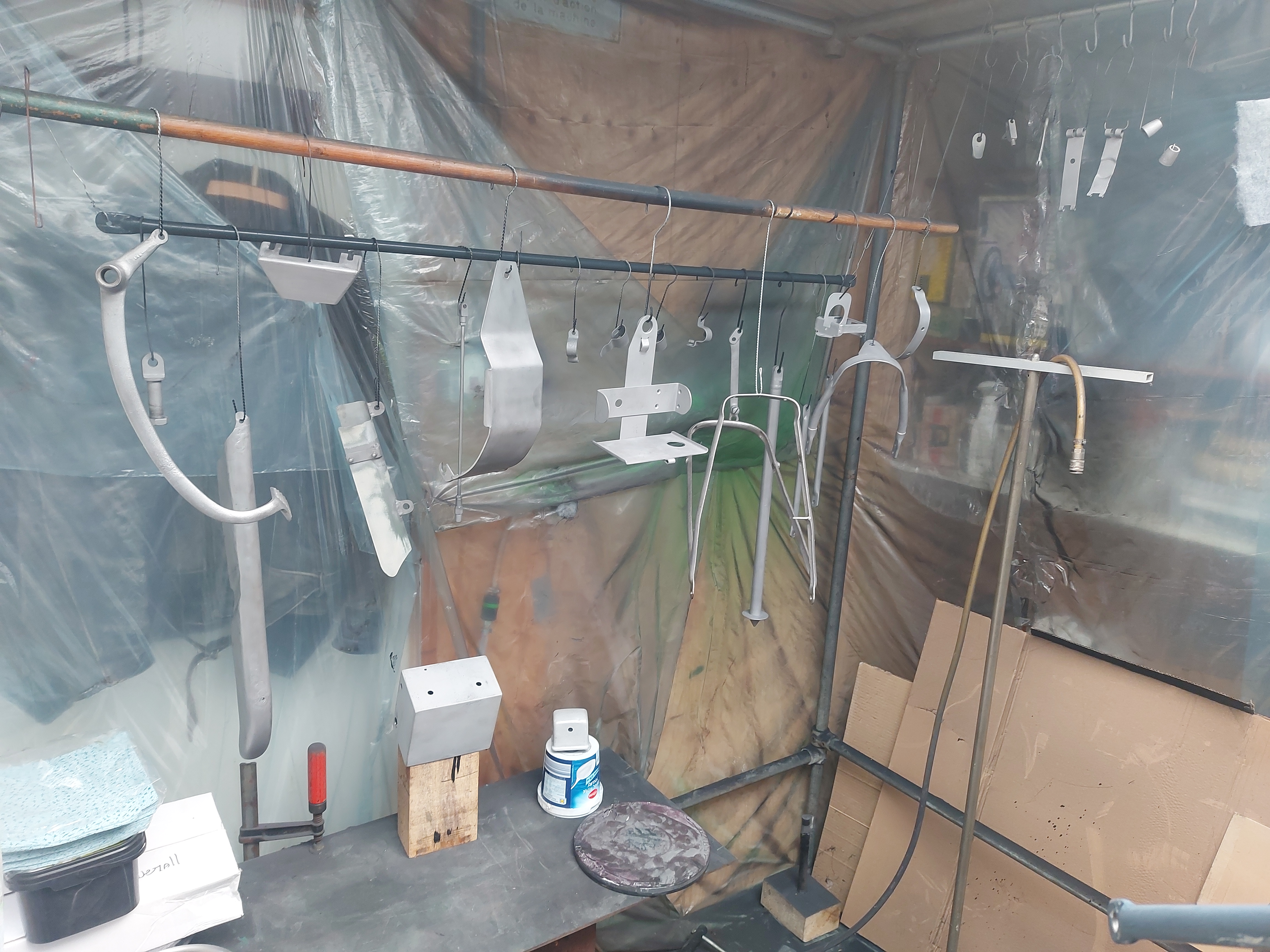

slowly I am getting there....
numerous small bits ready for primer
