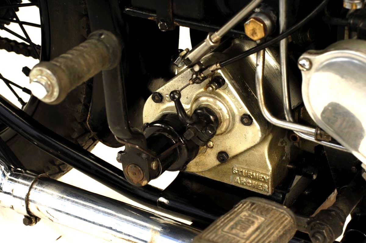

I don't know about you but Charlie is missing a bit of the spring cover if this 1930 model A is anything to go by. The k/start is clearly different to Charlie's so this may just be someone else's solution to the problem. The parts book shows a spring cover like Charlie's, could it be that LS 263 is meant to fill the gap?

Charlie didn't understand what LS263 was!
