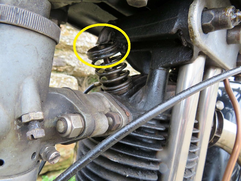

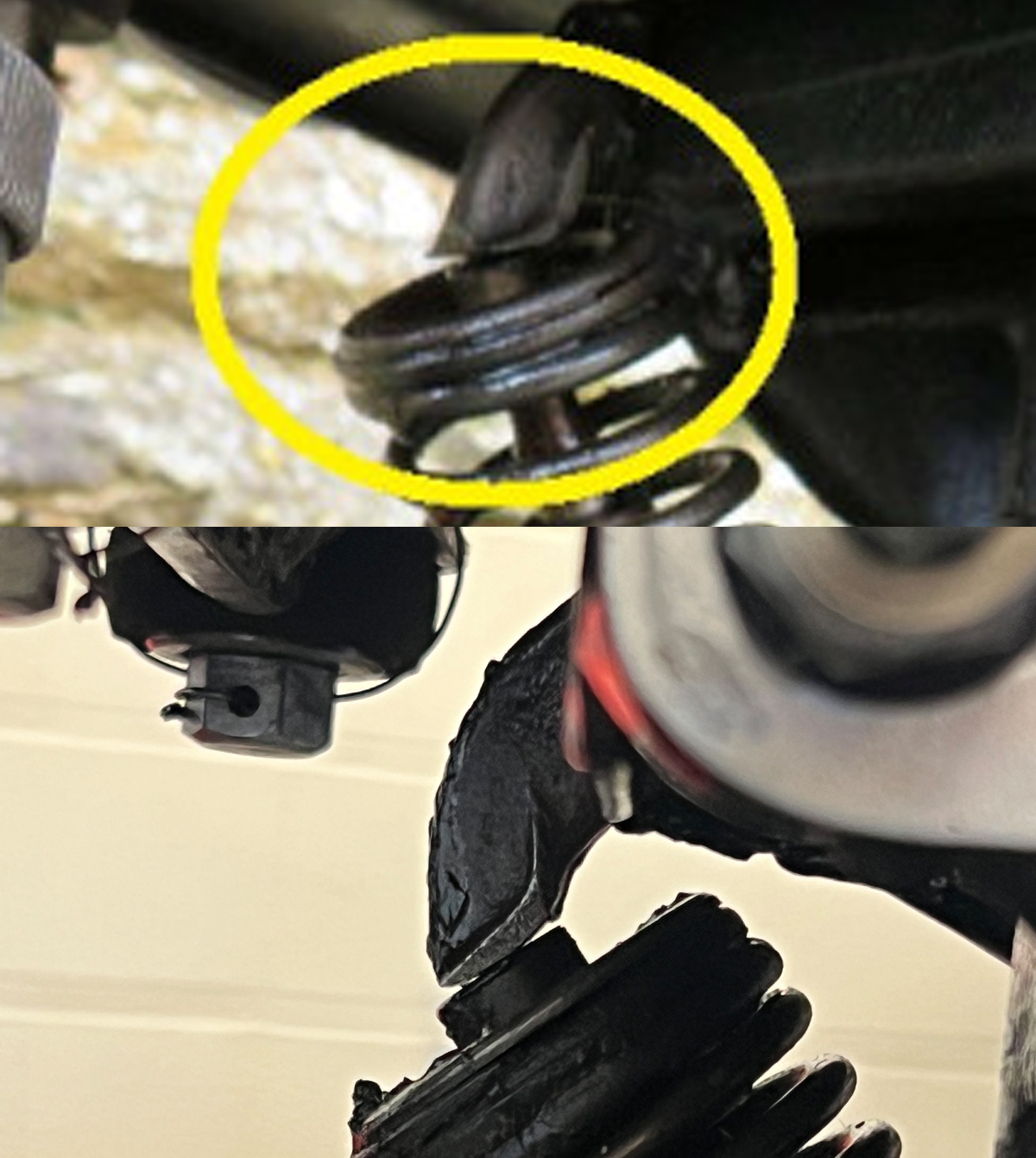

Hmmmm, sort of nice..
SA gearbox, and the rockers I have with my Model C look the same! Worn !

Vincent.vanGinneke wrote: Fri Jun 30, 2023 8:38 amthe rockers I have with my Model C look the same! Worn !
Someone has ground the face nearly flat, with the front edge now nearly a knife edge. As a result, the rocker geometry is incorrect, putting a lot of side thrust on the valve guide.

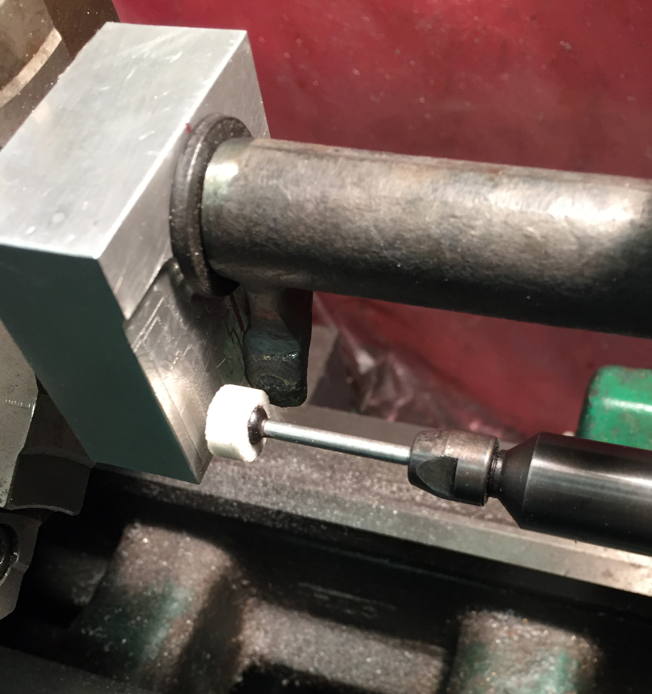

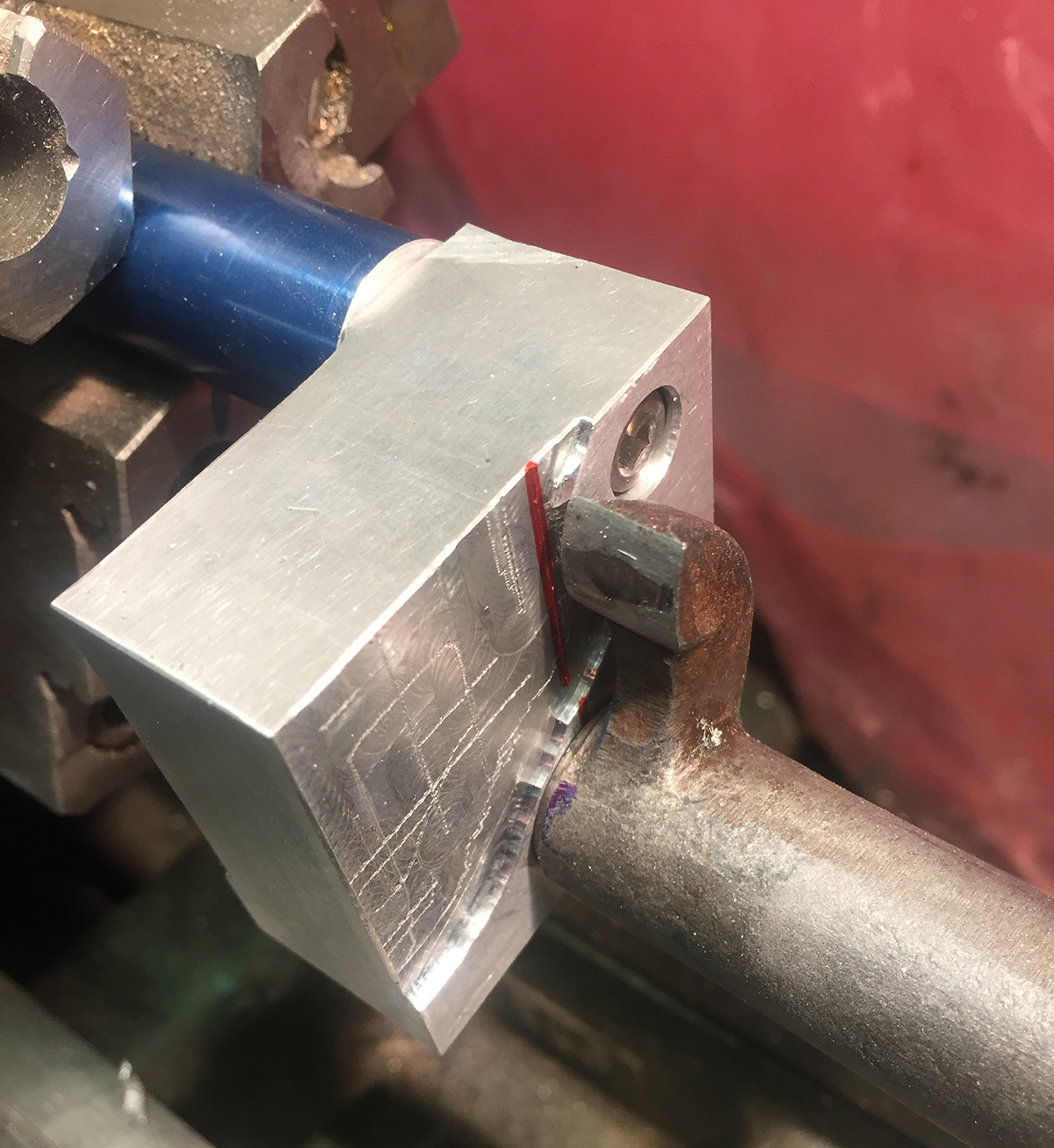

However, it's nothing that Stellite and a grinding jig can't fix.
