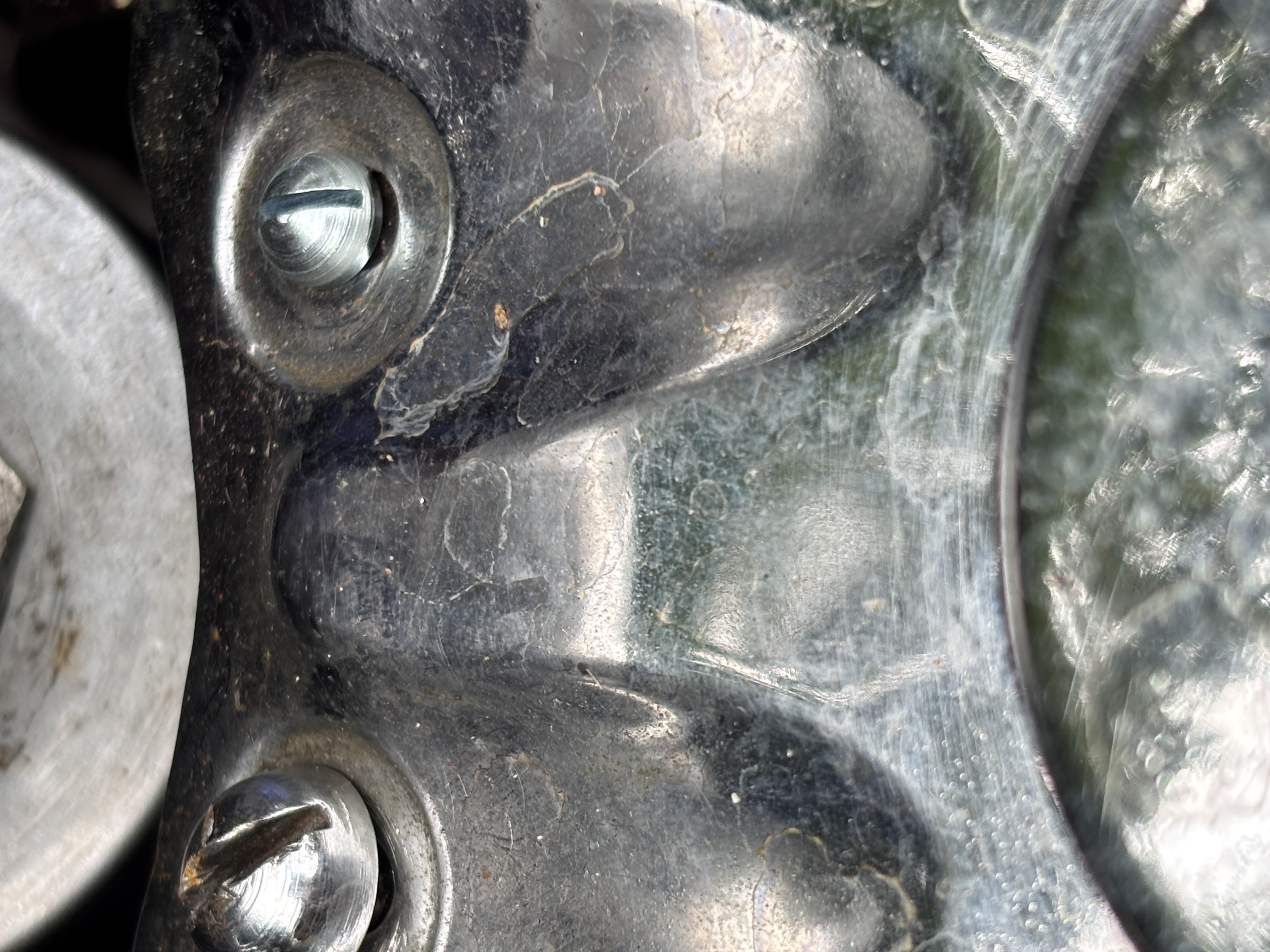

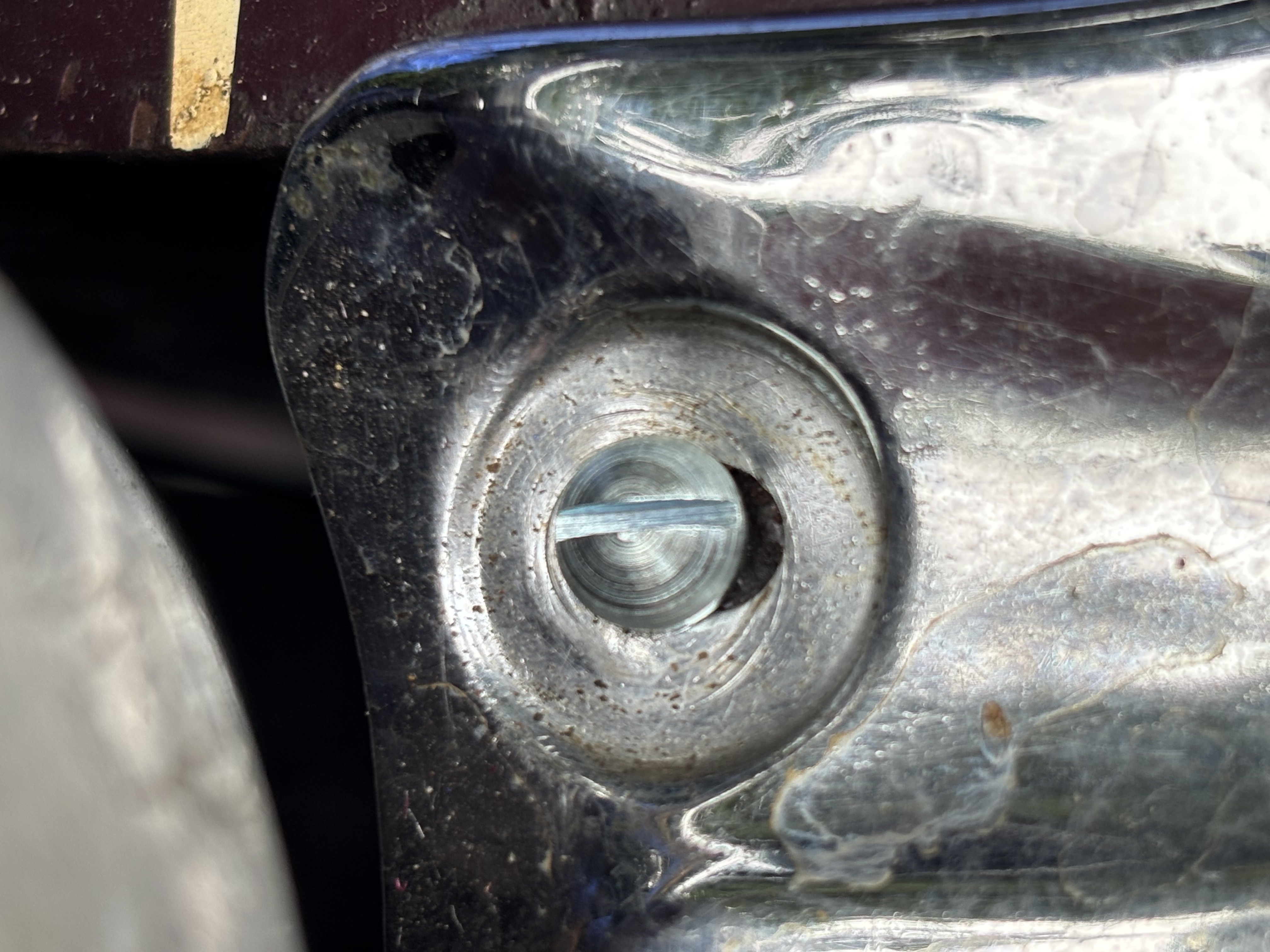

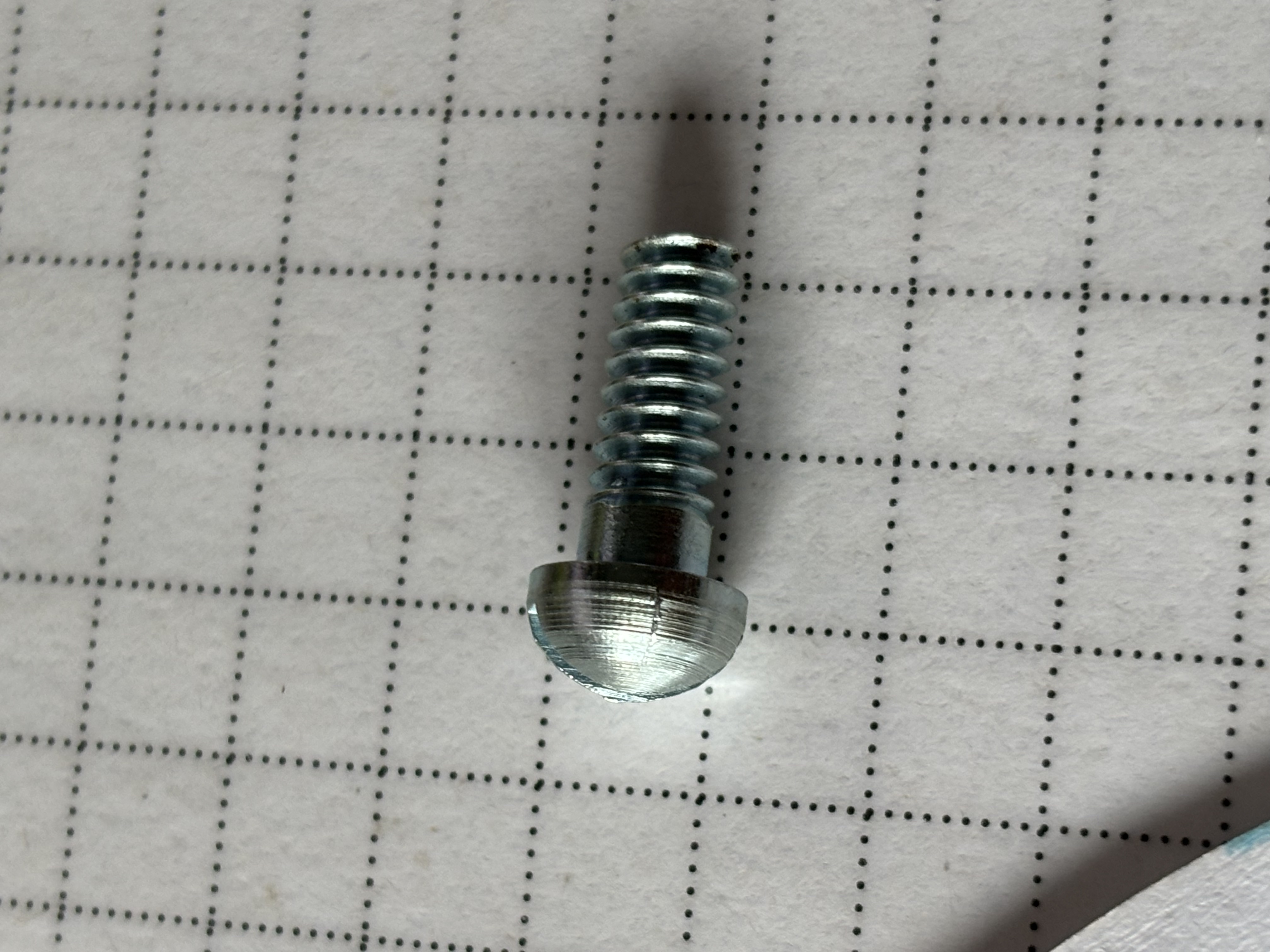

Right, so pictures show the bolt that I thought went in the strip, next to the new one. As you can see the new one appears to me to be rather small for the slot, it falls in the spire nut, and there is no washer. Another picture shows the one that Drags list, against the (rather nicer one imo) that is actually sent, both numbered 053, and yes it does exactly match the dimensions listed.
So, if the Drags one is correct, why is the hole in the Chrome strip so big, and no washer is listed, it doesn't make sense to my eyes.
I would like to see some of the other guys on here post pictures of theirs in situ.
To clarify, my bike is pretty much original, used for commuting between '58 and '68, then left in a shed untouched until last year. I admit that we removed bolts and screws to work on it and may well have muddled some up. I just can't get my head around much a big hole needing a small screw.
(Pictures not in order).
Thanks in advance for replies.
Re: FH Fuel Tank Chrome Strip?
From memory, I decided to fit stainless steel thin washers, this tidied up the installation though not strictly standard.
In my opinion, the holes in the chrome strip are too big, whether by design or error.
Regards Mick
Regards Mick
By design I guess. Helps you get the strip flat against the tank - you push it down and forwards, the screws slide in their slots, you tighten them when you are happy.Mick D wrote: Fri Sep 04, 2026 6:35 pm Hi
Regards Mick
That is a good point, though I can see me using a washer like Mick as the head of the screw really isn't that much bigger than the slot.simon.holyfield wrote: Fri Sep 04, 2026 7:25 pmBy design I guess. Helps you get the strip flat against the tank - you push it down and forwards, the screws slide in their slots, you tighten them when you are happy.Mick D wrote: Fri Sep 04, 2026 6:35 pm Hi
Regards Mick
