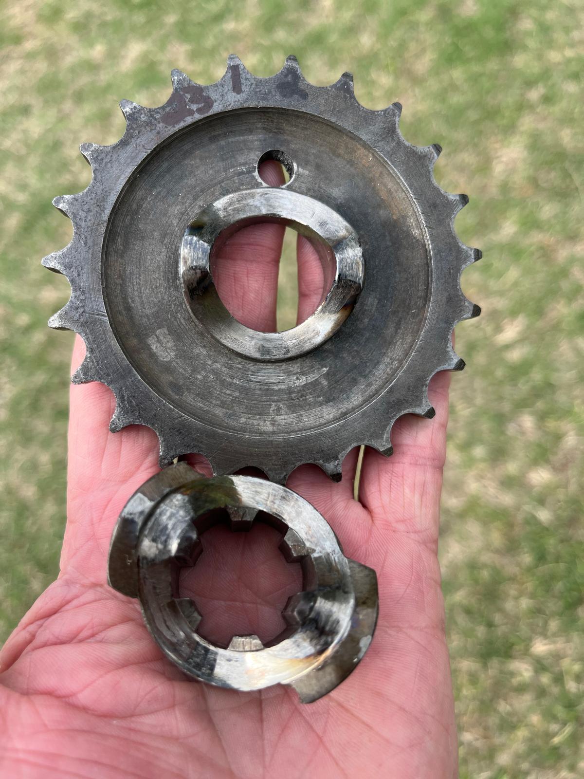

Re: 1946 VH 500 Restoration
That's a mess.
With everything in place except the spring the sprocket should not be
able to turn freely. Later singles from 1956 had a slightly longer mainshaft
to move the primary drive out to clear the FERC if fitted. One of these
longer shafts in an earlier engine will allow the sprocket to turn freely.

I have ordered new replacements which are on back order, but in the meantime, I made up a few shims so that it would not be able to turn over the top, I have been able to ride approximately 85 miles now, running-in the engine and keeping it under 50 MPH, she is doing great with no heat seizes!
