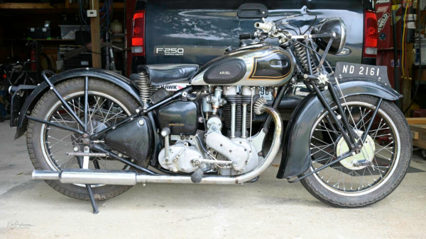

There is more to do now: the wiring, finding a speedo, attaching the tank badges, adjusting the forks that didn't seem to work, and the gearbox is not shifting very good so I'll have to pull it out and investigate. The attached photo is in it's current state.

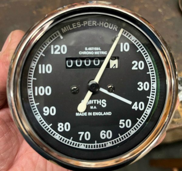

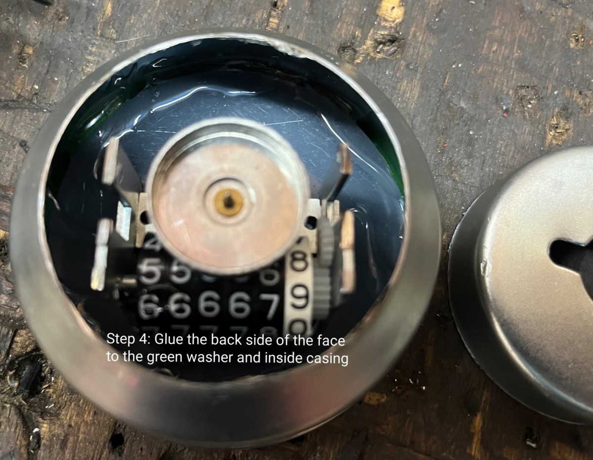

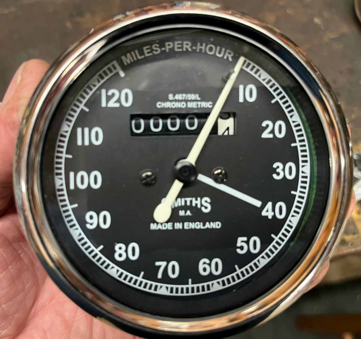

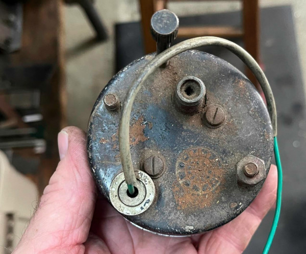

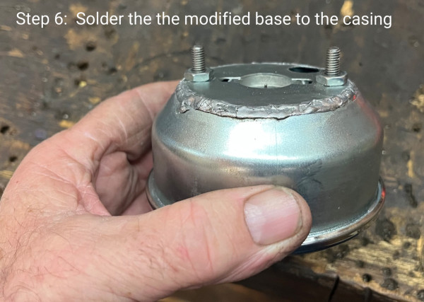

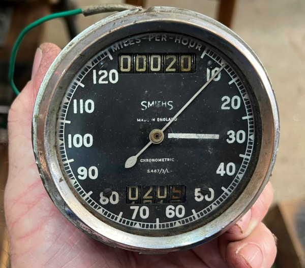

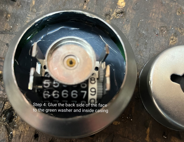

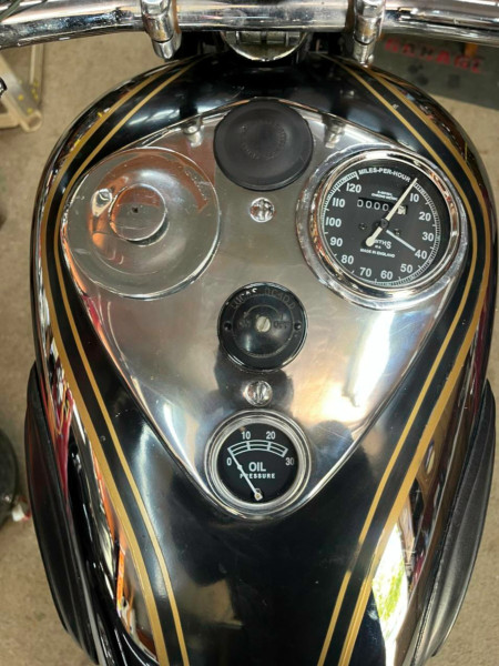

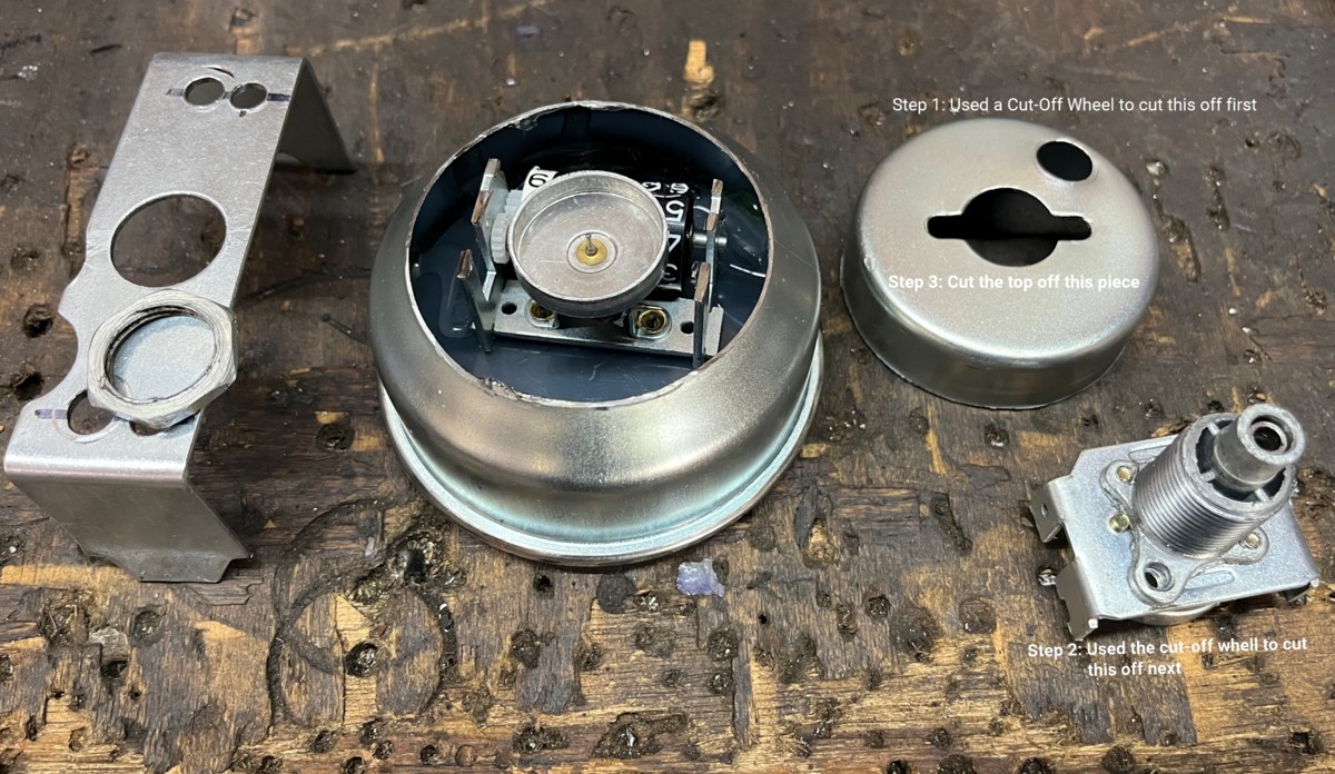

SPEEDOMETER: I had two Smith Cronometric Speedo's (that are in pretty good nick) in my box of spares, but, they would not work in my tank. Rater than waste a good speedo as a dummy, I decided to purchase a cheap Indian replica to fill the spot. It turned out to be to deep so I ended up cutting the casing to shorten it, keeping the internal face and mechanism in tact, adding two 10/32 mounting bracket screws, then soldering the shortened case together, modified an original speedo insert, ad mounting it into the panel. I also located a 0-30 psi oil pressure gauge from a vintage tractor spares vendor along with new copper tubing and fittings, making it much easier to remove and re-install as needed.

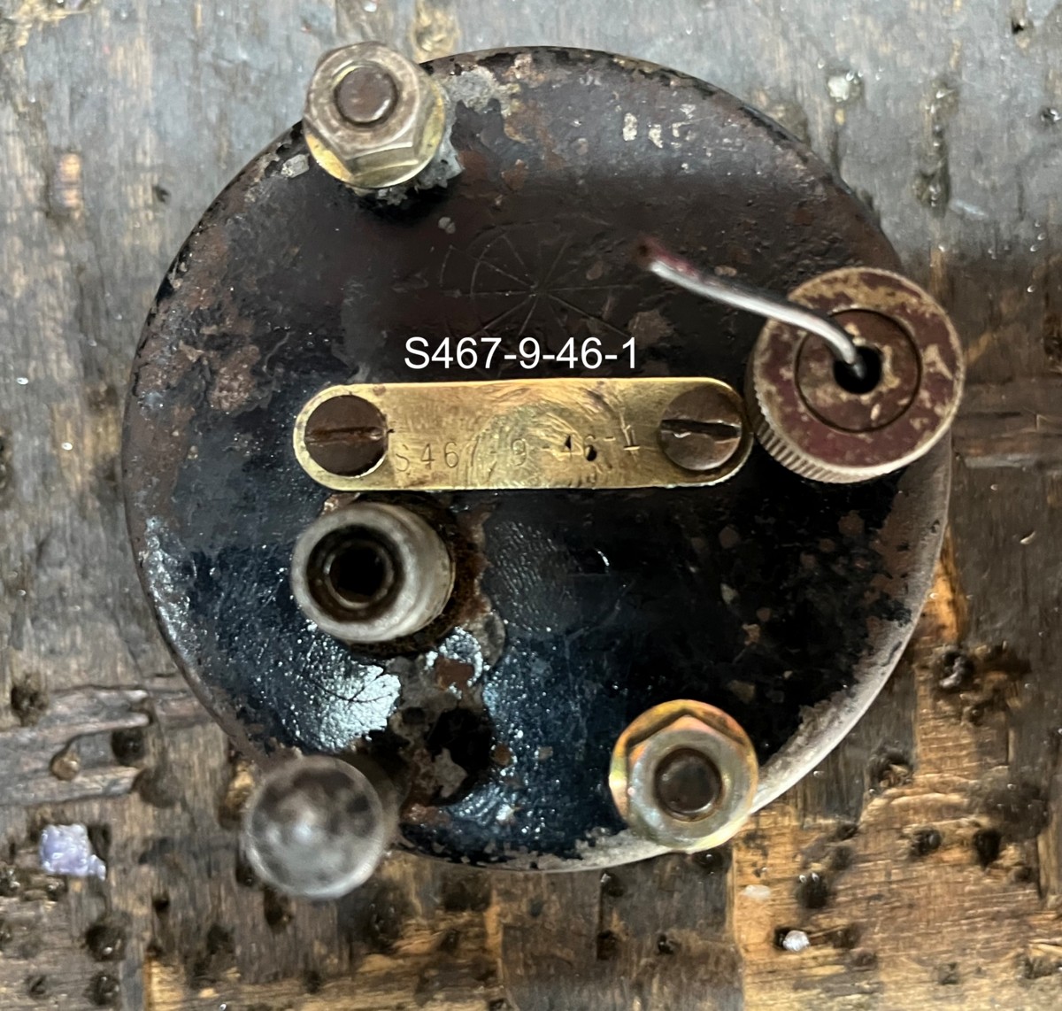

That is the problem with the Indian speedos, originally made for RE Bullets, they also use a different cable fitting. If you have a speedo cable entry hole to the rear of the tank and a panel hole that is other than round the original speedo would have been a PA. Your bike being 1946 could have had either a PA or a Chronometric, the cable for the latter passes through the tank directly below the speedo and the hole in the panel is round. If you have a round hole and the chrono speedo didn't fit you will have the wrong bezel that can be easily changed. The other point to watch is that the speedo drive gears in the gearbox are very different for PA and Chrono, I don't know what Indian speedos need.

My tank has the hole for a cable on the right rear side to pass through. Unfortunately, the Layshaft worm gear is damaged, teeth are chipped probably from an incorrect Speedo spindle gear (which I do not have anyway) which is why I just used a dummy for the time being.

The proper gears to repair the speedo and layshaft are available from gearbox spares. Like you, I use the old speedo for show and use a cycle speedo for speed measuring

Since it is highly unlikely of finding a PA speedo, its probably going to remain as is. Unless I could sell or trade/swap for the two speedo's I have.

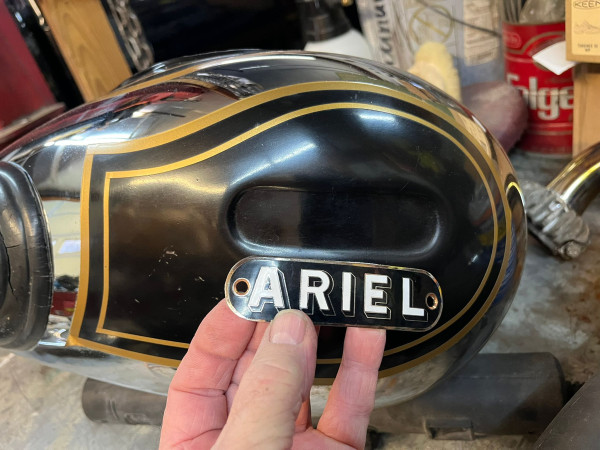

After searching for months, I finally found my petrol tank badges I purchased from Dragonfly back in 1987 today wrapped in tissue paper in an old tool box I hardly use anymore. Must be old age? My excitement was short lived when I realized that my tank has no "mounting fixtures" to screw them on. Can someone give me information on how or what is missing from my tank please?

The enamel badges did not re-appear immediately after the war or perhaps because the factory had some W/NG tanks to use up first that didn't have badges (except the very early ones). Transfers are available and I am sure Draganfly will buy the badges back for the price you paid for them!!! Did you know that Draganfly have been making these tank badges for longer than Ariel did.
