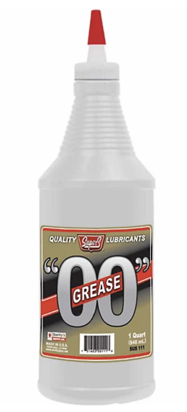

UPDATE: It's been a few months, during which I reassembled the engine post balancing then several short rides, each time experiencing minor issues. Heat seizing under WOT over 55 mph, what I thought was a slipping clutch only to discover it was the shock absorber, what I assumed was a bad Magneto but it was a bad HT lead, a pin hole leak in my tank under the RH knee pad, the SAE 140 gearbox oil I used was leaking really badly that was solved by draining it and adding 600 ml of #00 Cotton Picker Spindle Grease, adjusting the carb needle to richen it up, especially while I am breaking-in the engine that now has all of 81 miles since boring it out with .007" clearance for the JP piston.

I wonder where one can obtain Cotton Picker Spindle Grease in the UK.

Re: 1946 VH 500 Restoration
Roger, you may try antique/classic Tractor spares vendors. I purchased mine here https://www.tractorsupply.com/tsc/produ ... -grease-00Roger Gwynn wrote: Fri Apr 04, 2025 9:35 am I wonder where one can obtain Cotton Picker Spindle Grease in the UK.
