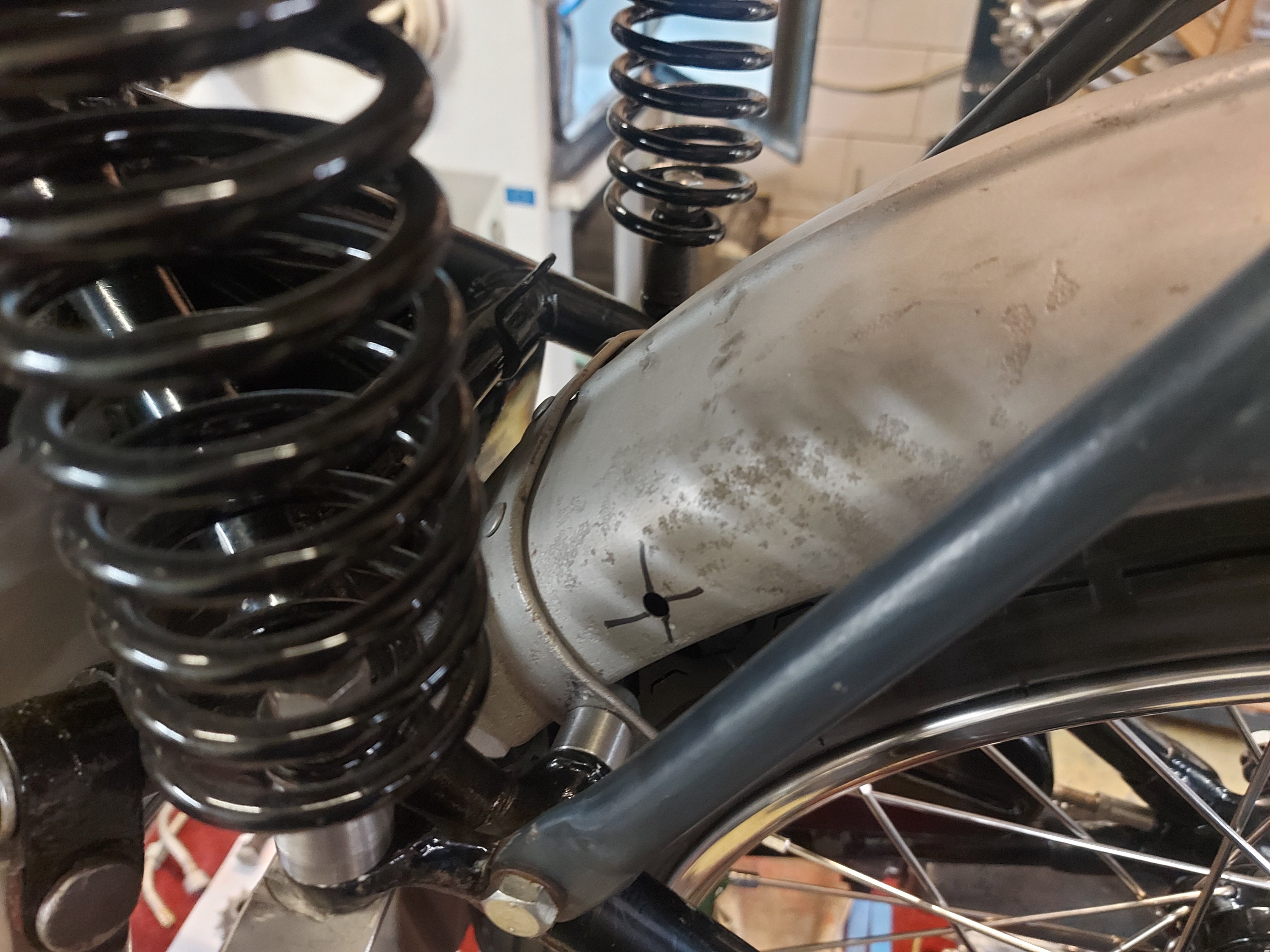

Hello Konstantinos,
Possibly the one with the bridge bracket on the outside is a WNG item, at least that is how my WNG mudguard is.
The rear 'Y' bracket on your Ariel needs to rotate a bit more towards the rear so that the hole near the lifting handle meets up with the bracket near the hinge.
As you can see the one in the centre stands vertical
(blue rack is a DIY item, as a lot of other things... :D )

Hi Vincent,
Yes, i know what you mean by vertical, like the plastic one I trial fitted.
I will do a final fitting on the 37’ frame later today with the correct bolts etc and then send them for blasting/patching up. As i will do for the front one. Unfortunately my forks are WNG :roll:
Also nice rack! I believe i have a 1950 one witch gets thicker where the holes for the bolts are.

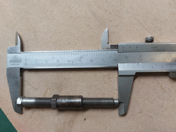

How long should the rear wheel adjuster should be? I measured my newly acquired ones at 1 7/8”. They seem short.
Posts: 4840
Re: 1937 VH Project
I think you have the ones for a swingarm ?
This is the one on my WNG frame, I think the same as earlier frame's
sort of 3 3/8"

Maybe.. I ordered 5740-30 as per the Parts list but i got the short ones.
