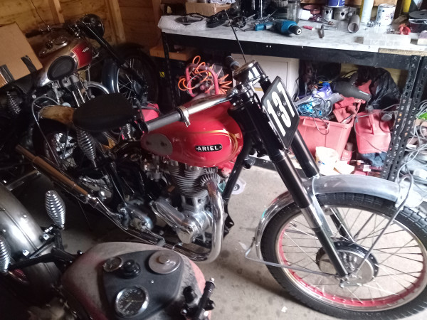

download/file.php?mode=view&id=34612
Hello Lee, You have to watch out for those early VHA/VCH motors they get a bit feisty even with a Concentric on.

Post by Leejm »
Getting there!

Post by Leejm »
Very close to the finish line

LEE have you got the raised handlebars with the Crossbrace fitted? Nev

Post by Leejm »
Hi nev , no I didn't go for them . I used standard ariel bars .

Post by Leejm »
Posts: 5629
Re: Vch replica
They are not that radical anyhow. Nev

Post by Leejm »
Well the vch is now finished, and running. Which wasn't as easy as it should of been .
The problem was down to the brand new carburettor. Amal never drilled the pilot circuit correctly nor was the pilot jet either! With theses issues sorted the bike kicked into life .
