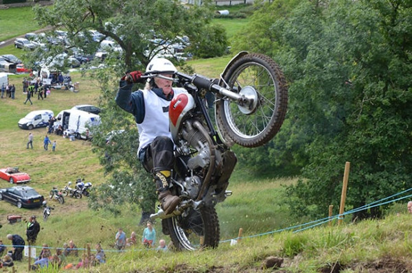

Hello Lee, You have to watch out for those early VHA/VCH motors they get a bit feisty even with a Concentric on.
Posts: 5568
Re: Vch replica
The short frame is not good for hill climbing. Nev

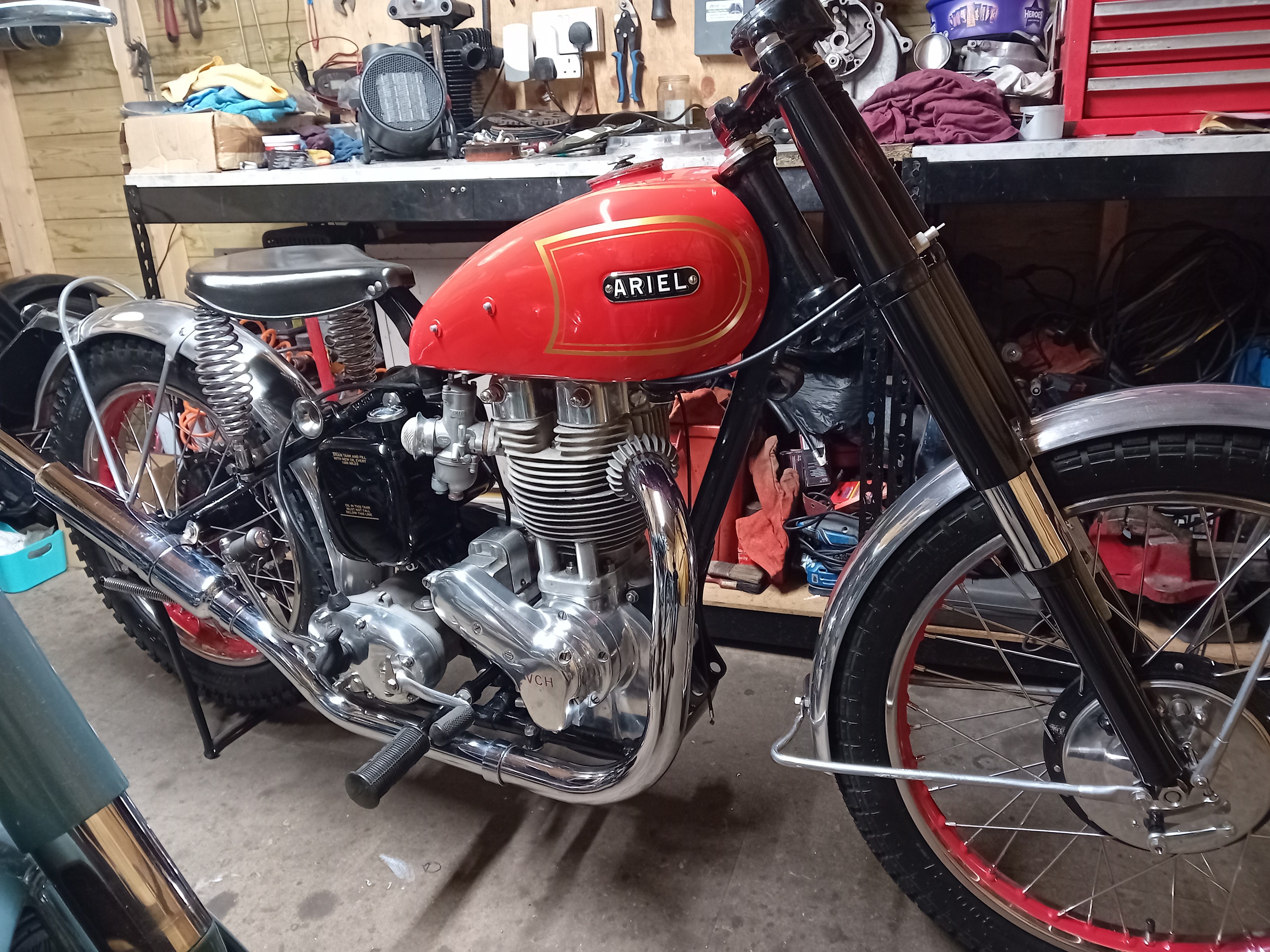

Post by Leejm »
Getting there!

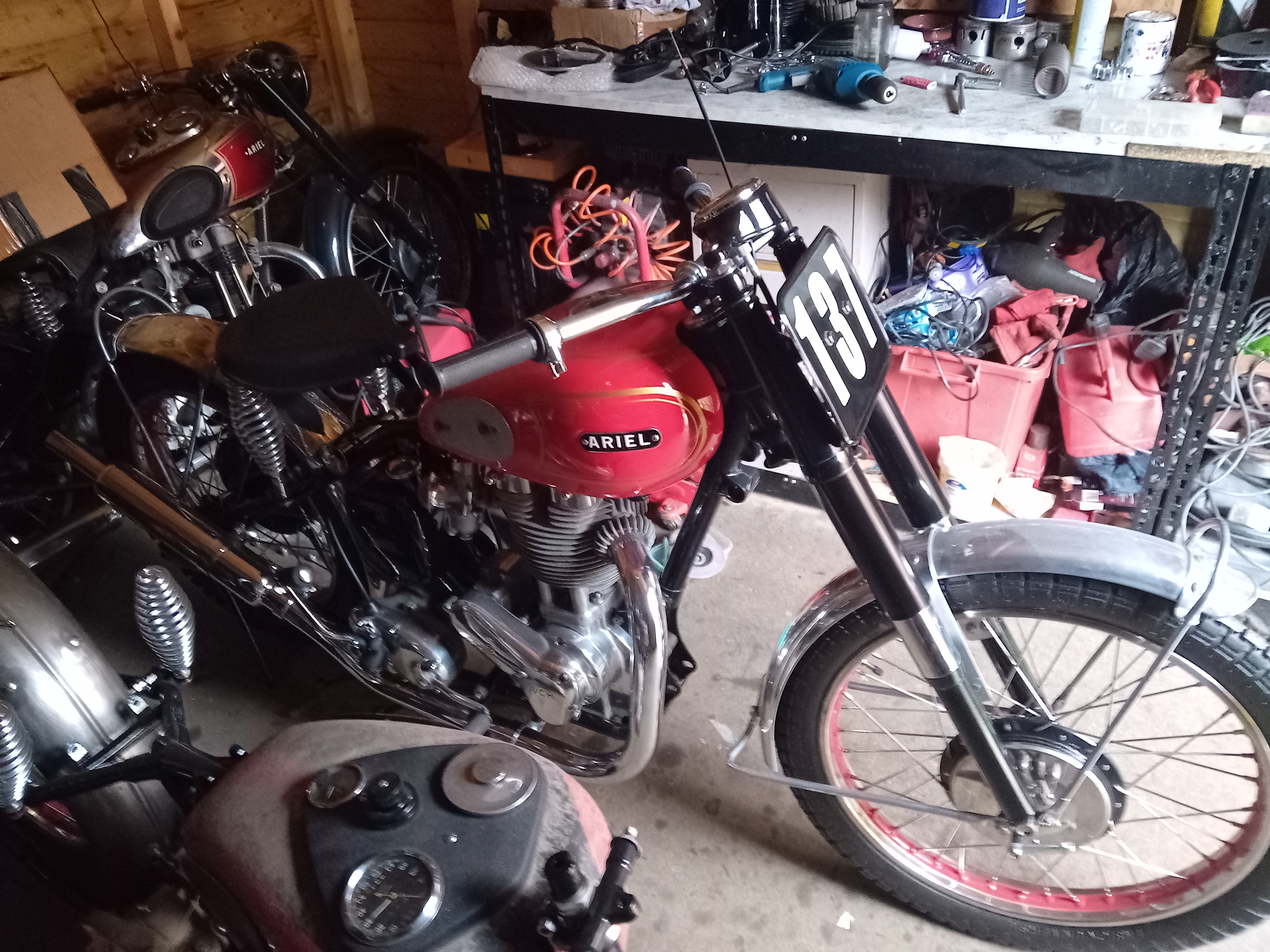

Post by Leejm »
Very close to the finish line

Well the vch is now finished, and running. Which wasn't as easy as it should of been .
The problem was down to the brand new carburettor. Amal never drilled the pilot circuit correctly nor was the pilot jet either! With theses issues sorted the bike kicked into life .
