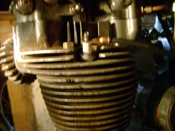

Hi all,I have measured the thread depth again and it is 1/2" depth why I don't know but it is the same plug for both bikes which makes it easier enclose some photos it's on the VCH but I cannot see why that should make a difference I have a photo of the plug in place to see if the depth is the same on other alloy heads,Regards Clive.

Hi John,I measured the thread with a double piece of bent wire and also when the head was off a short while ago checked the plug in the thread and saw it was a good fit in the threads and not sticking out so it is a 1/2" thread depth so Ariel's must do different depth threads in alloy heads, never having had a alloy headed Ariel before only iron it didn't strike me as odd till I ordered some recommended plugs on the forum site for alloy heads and realized the depth of the thread was different regards Clive.

Your plug thread is recessed a long way down.

hi i can be a aftermarket head or it has had the plug hole depend for some reason :?: all the alloy heads i have use B 5 ES plugs witch are a bit longer thread than the H S plugs

Hi Bob,Thanks for the info yes for some reason or other it does seem that my head has a deeper inset than yours where the plug fits in going on your photo for what ever reason, I don't know why,the previous owner is beyond asking as he is riding Ariels in the sky but I know Chass had a dropped valve a long while ago but I see no reason to reduce the thread because of that,But as far as I know it's the same head as it's had a lot of work around the exhaust guide welding etc.,so I am sure it's the same head which has been on all the time Chass had it, thanks again regards Clive.
