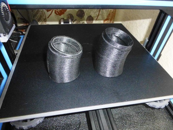

My '62' Leader didn't have a carb air-tube, & I know that they're available, but at over £30.00 I thought a bit pricey for a little bit of rubber, so since I already have stuff at hand, I thought I'd have a go at making one, if unsuccessful, THEN i'd buy one!!
Had a measure-up, drew it up on 3d cad, then 3d printed it in flexy-rubber, 1st attempt was a cock-up as I miss read my own drawing!!
2nd go was a bit different, I 'tapered' the inlet a bit & was 10mm longer.
Although 'flexible' its still harder than rubber & was a bit awkward to squeeze it it, fitted perfect, & now its on, it ain't coming off in a hurry!!
