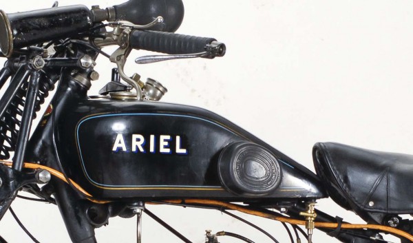

Hi all,
I am in the process of getting my tank ready for paint and am not to sure of the factory pinstriping that goes on this model, i have seen light blue and gold on the side running right to the front of the tank, but also seen it stop short of the front and come down and join the lower pinstriping.
Also i have seen the same pinstriping going around the top face of the tank.
One original tank i found had the gold and light blue pinstriping on the side with the light blue on the outer and no pinstriping on the top face, most of the restored tanks i have looked at have had the gold on the outer
Interested to hear what people think

Here the remaining stripes on my 28 B. There is a danish document around with measurements.
Markus
N.b. the horse sticker is not correct.
Markus

Thank you for your input Markus, interesting, great original looking machine you have

Photo's attachedM.Bagshaw wrote:I was going to show you what I've done with mine but cant upload pictures?

So nice.....there's not much on my wish list anymore , but a Black Ariel......Oooow

Since I will be doing my 27 OHV over the next couple of months,how thick are the pinstripes?.What paint did you use,one shot?.That is one stunning Black Ariel.

Thanks for uploading my pics and educating us all, or at least me! with regards to the paint unfortunately i'm not that good at painting so had John do it for me.http://www.vale-paints.co.uk
He did all the tin wear including much tin bashing on the rear guard; his black paint you could lick!
