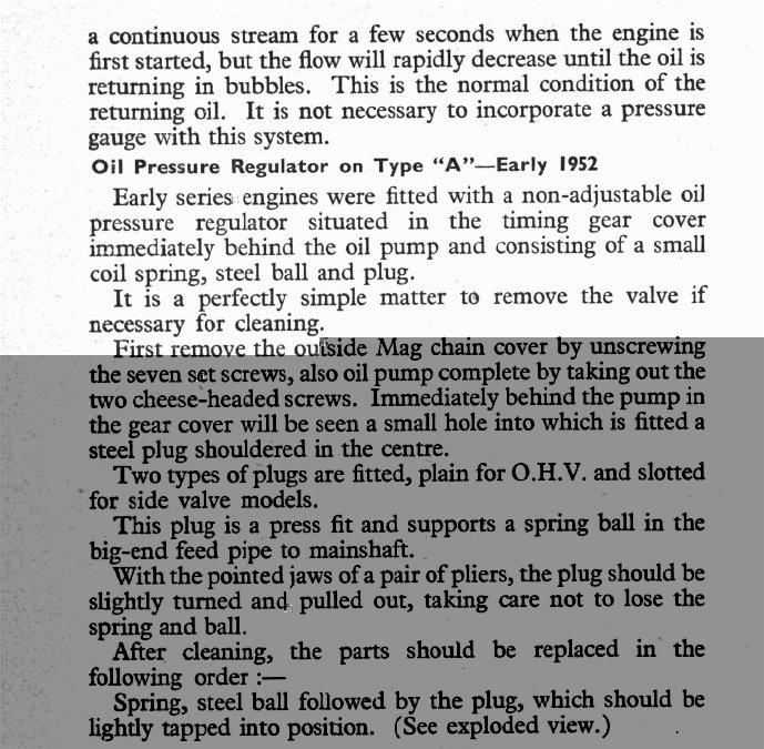

john.nash
Posts: 1196
Re: ariel ht 5 trouble
Post by john.nash »
Hi,
This is from an owners manual.
Do you have one ? There are a couple in the library:
http://www.arielownersmcc.com/members ... Guides.htm
oilpressure plug.jpg (132.81 KiB) Viewed 8119 times
The plug should come out with a air of long nosed pliers. Just grip it and wiggle it. Catch the ball bearing and spring.
Maybe replace the spring with a new one ? Clean replace. Replace the plug the same way, i.e. push home with pliers - should be an interferance fit.

nicolas.carrie
Posts: 5
Joined: Mon Apr 11, 2011 8:26 pm
Post by nicolas.carrie »
thanks
i've just removed the hole system.
after cleaning, the problem is that , once fitted again, the ball still blocks in the feed pipe when i pull on it through the plug hole...
morgo recommends to remove the secondary timing case check ball valve and spring...are they those ball and springs ?
nicolas

I fitted a morgo pump to my NH after last summers riding being ruined by the return side of the piston pump blocking whenever I tried to do a long run. I did remove plug , ball and spring. mine defied pulling with pliers so I drilled it out. (the inner caseing was off the engine so swarf was not an issue) Since then all has been well with the engine.

well that's the way i'll go, i think.
i'll try without ball...and see.

My 51 VH had the return side of the pump block via the ball in the crankcase. I was riding my bike to a job in the wrong direction and did a u turn in the road and wondered who had that big bonfire!! it was me. Anyway I removed the ball and had no problems since

Hi all, this ball in the crankcase was that a later fitment intended to keep oil in the engine in case of oil problem ??? I seem to remember reading that somewhere a long time ago. Could be that it is in Waller.
If all is o.k. in the oil pump department there is no reason to have it in there.

hi
well i rode the bike yesterday on pre 65 trials event, and everything works fine!
so , many thanks for your help
