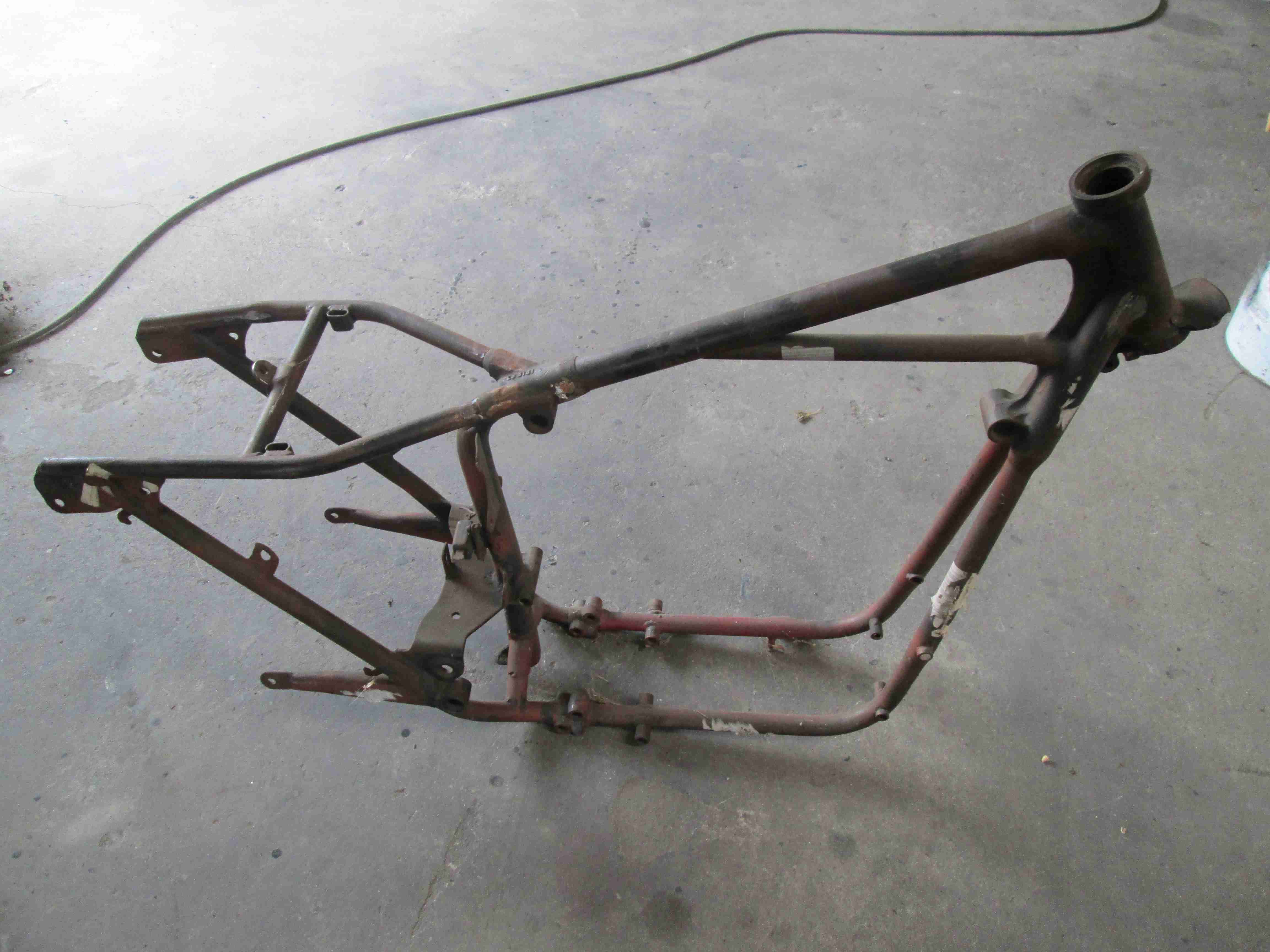

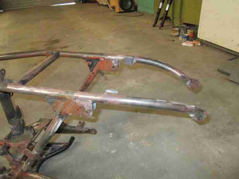

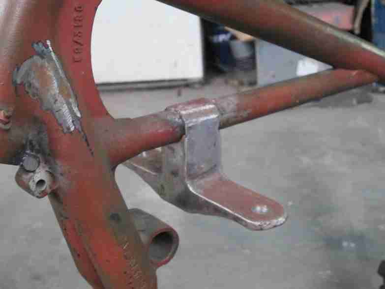

On this swing arm frame someone thought it would be good to cut off the petrol tank supports as well as the frame tubes that support the rear mudguard. I fabricated new supports and welded them on but have not bored the front to rear holes for the front petrol tank support in it as they serve no purpose and if not mentioned no one would know.
new mudguard supports, just need to reduce the width at the rear and bore the holes David

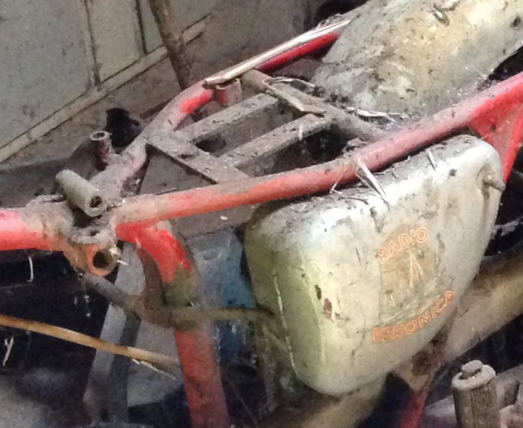

Latest barn find, I think this welding job was a way to fit a single seat to this swingarm frame.
I did not yet figure out what the vertical piece of tubing on the right hand side was meant for.
And why not fix that wobbling toolbox for once and for all !
