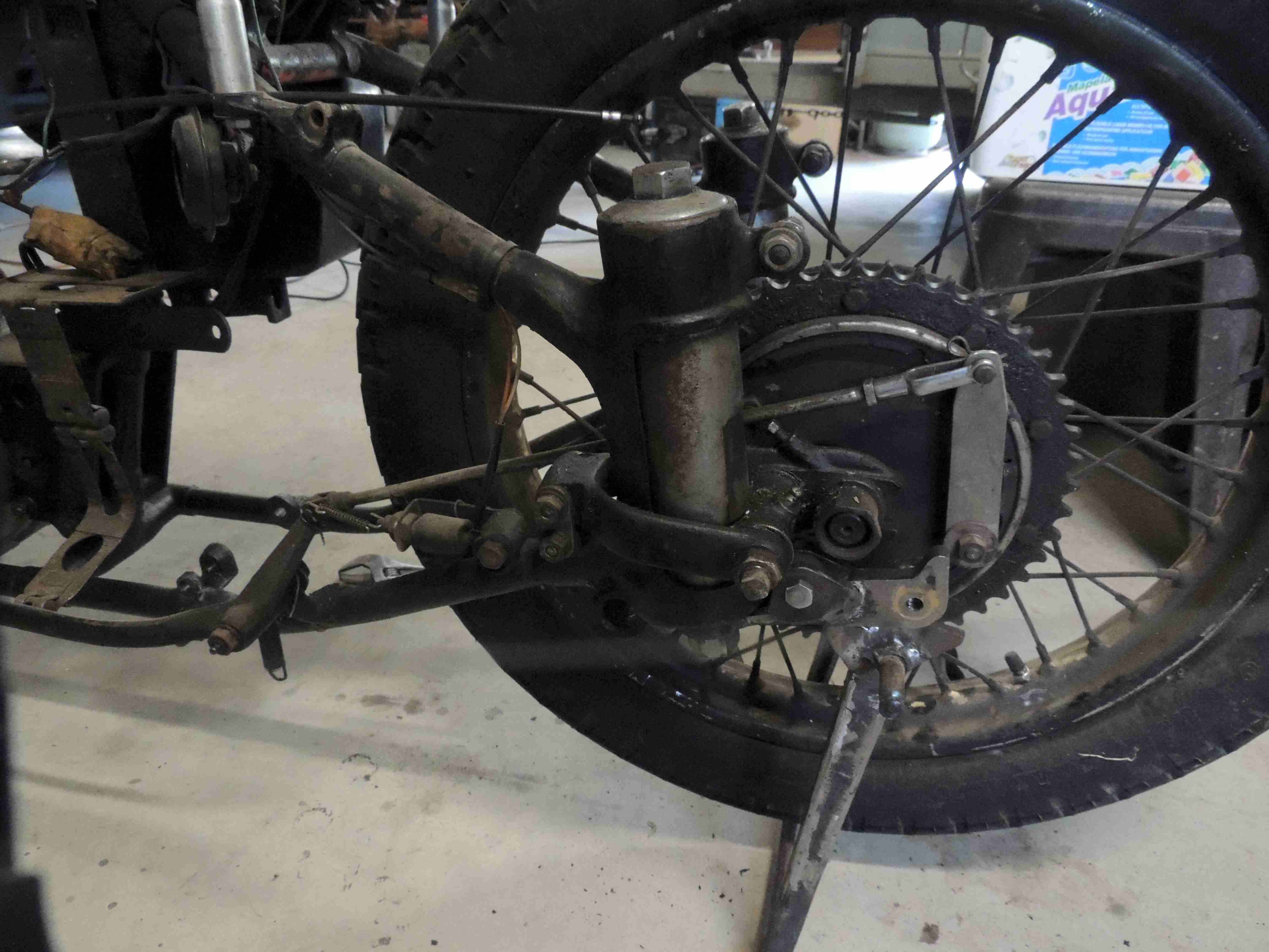

There were no stands for the bike. The previous owner used to lean it against a post or wall.

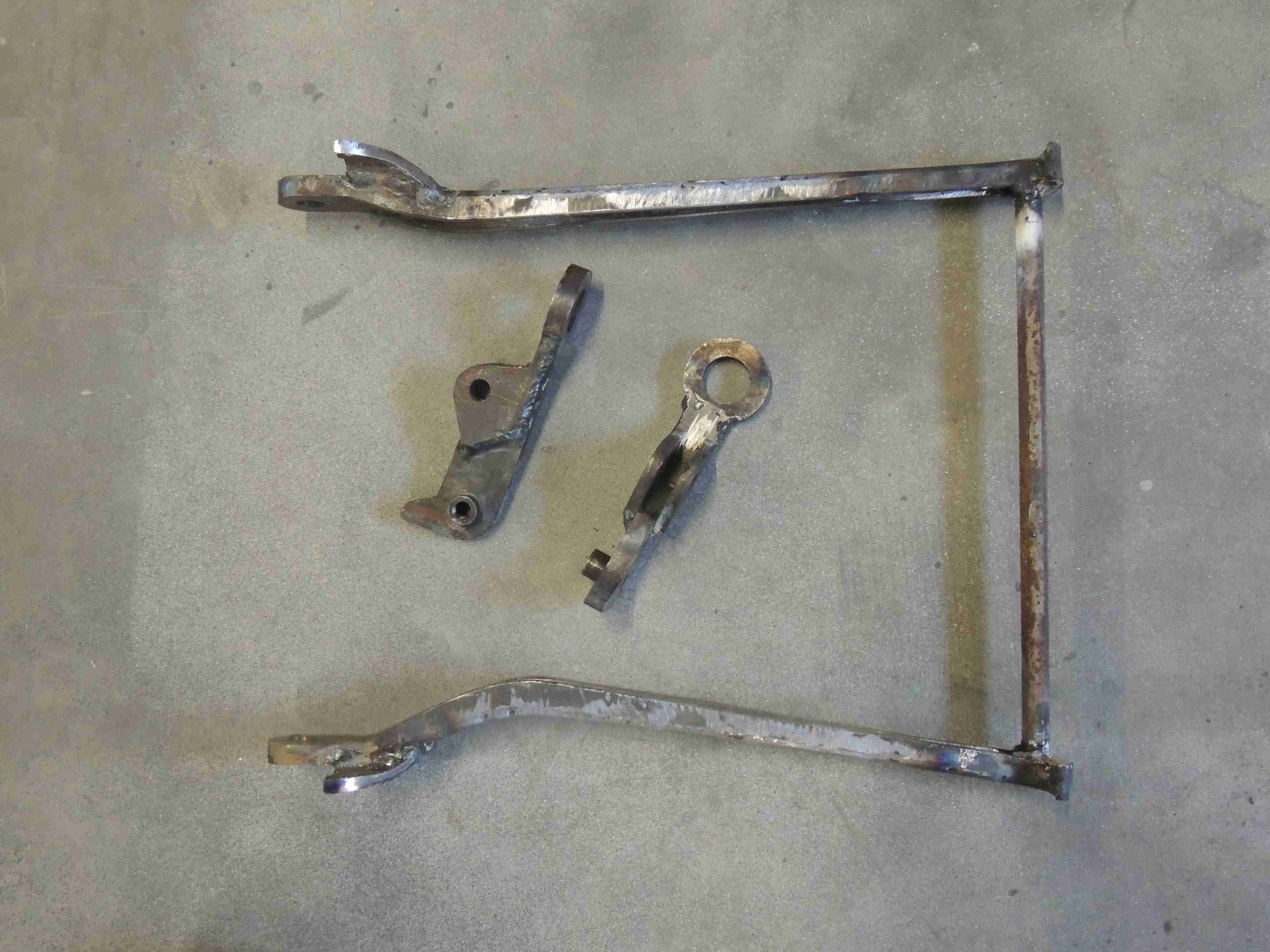

While there was no rear stand, the brackets to attach the stand to the frame were also missing. The sleeve nut on the bottom of the suspension normally holds the 3/8” thick stand bracket in place. Without the bracket the central bolt is too long so the bottom sleeve nut was tightened until it bottomed out on the bolt and the final result was that the suspension guide tube was never tight in place and the suspension caps stood up about 3/16” higher than they should, and the suspension guide tube could obviously move up and down. I fabricated new rear stand and stand brackets

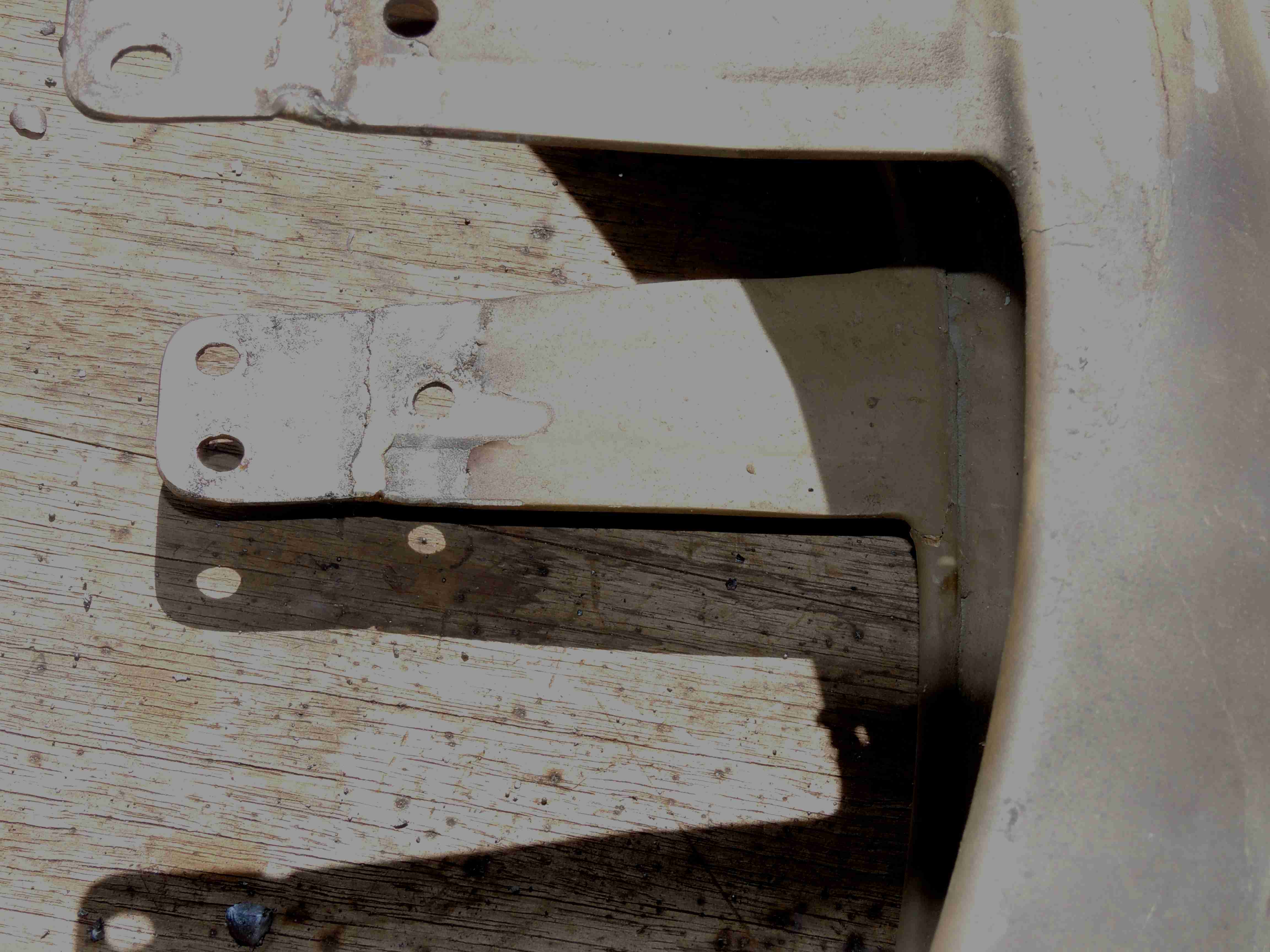

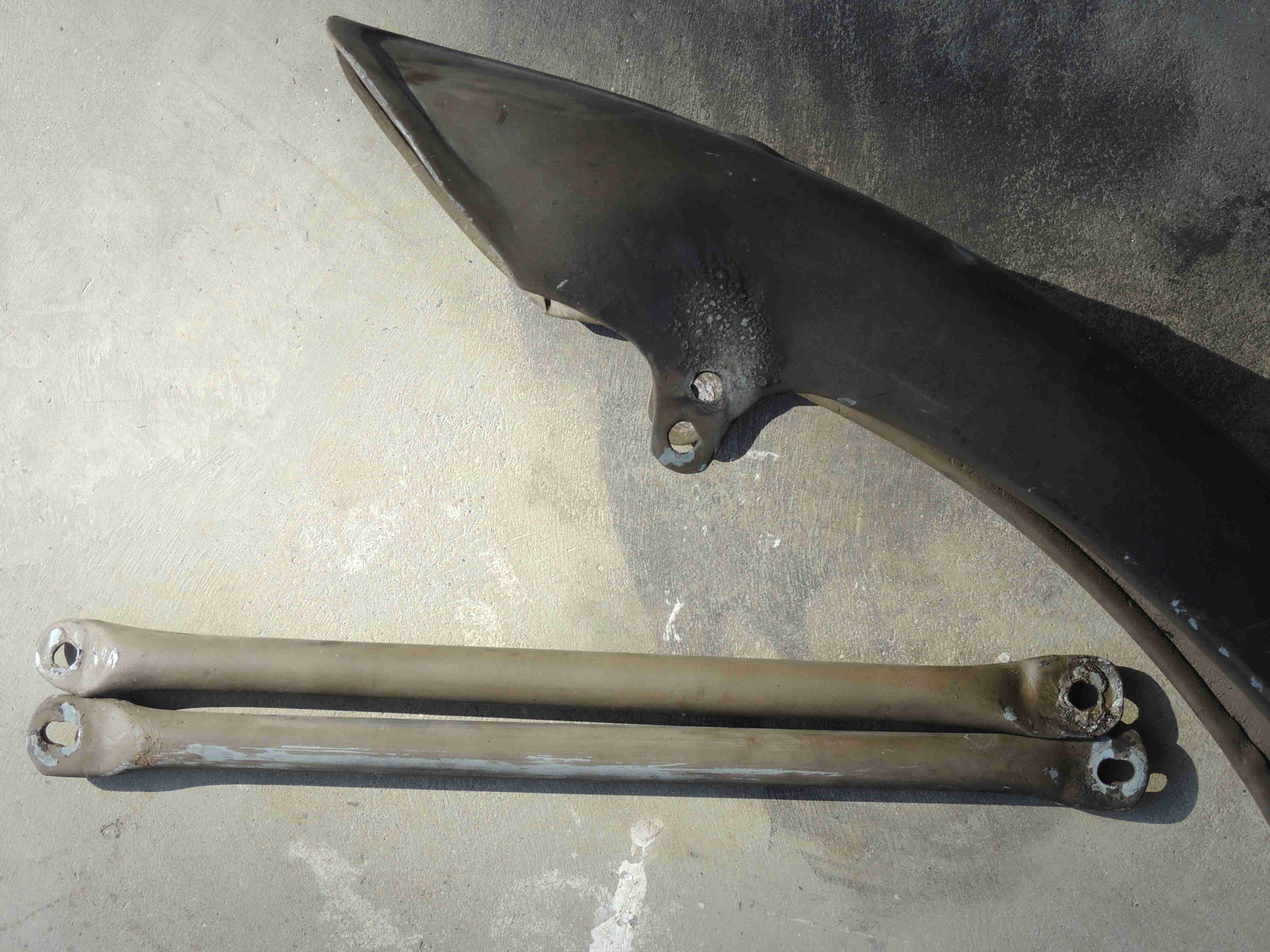

See the different lengths between the front mudguard stays. As one is too long just bore a hole through the mudguard above the fixing tab and bend the tab out of the way.
The mudguard centre stays have been cut and then a piece has been welded back on. But they are of course still shorter than original.

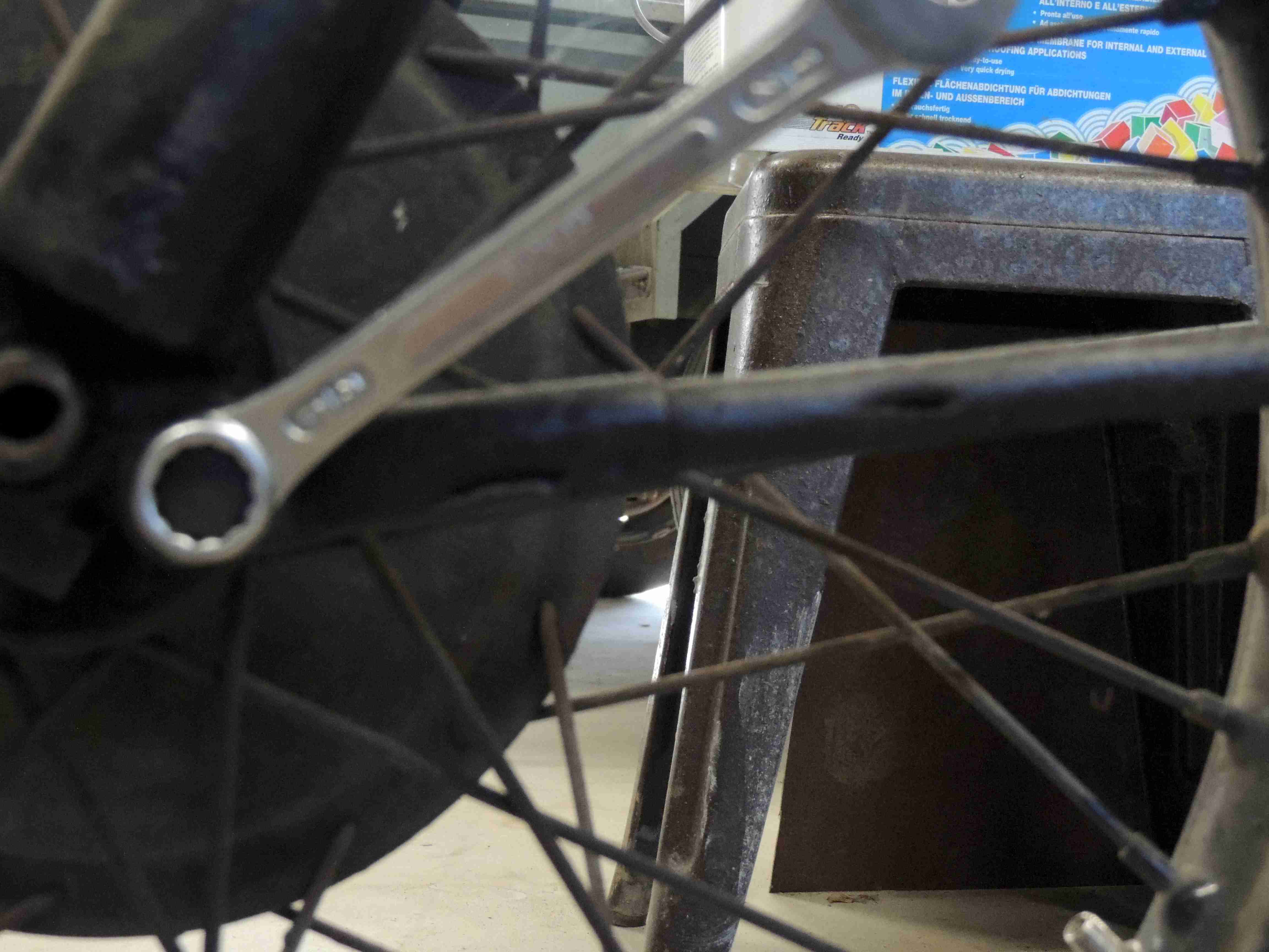

Front wheel stand fixing bolts. A Whitworth spanner did not fit. Yes the prior owner screwed in a pair of unf bolts. 1/2" unf spanner.
The previous owner had the rear wheel lock up with the downward pointing brake drum arm. So make an extended upward pointing brake arm and don’t worry about the return spring that should be fitted to that arm. The weight of the footbrake pedal alone has the rear brake permanently applied even though lightly. I will bet the drum ran very hot if ridden other than round the block. The brake rod is also just in contact with the rear wheel adjuster bolt so don’t try and bring the rear wheel forward after fitting a new chain.
Both front and rear brake drums were full of grease which was doing a good job of lubricating the linings. So they will have to be replaced.

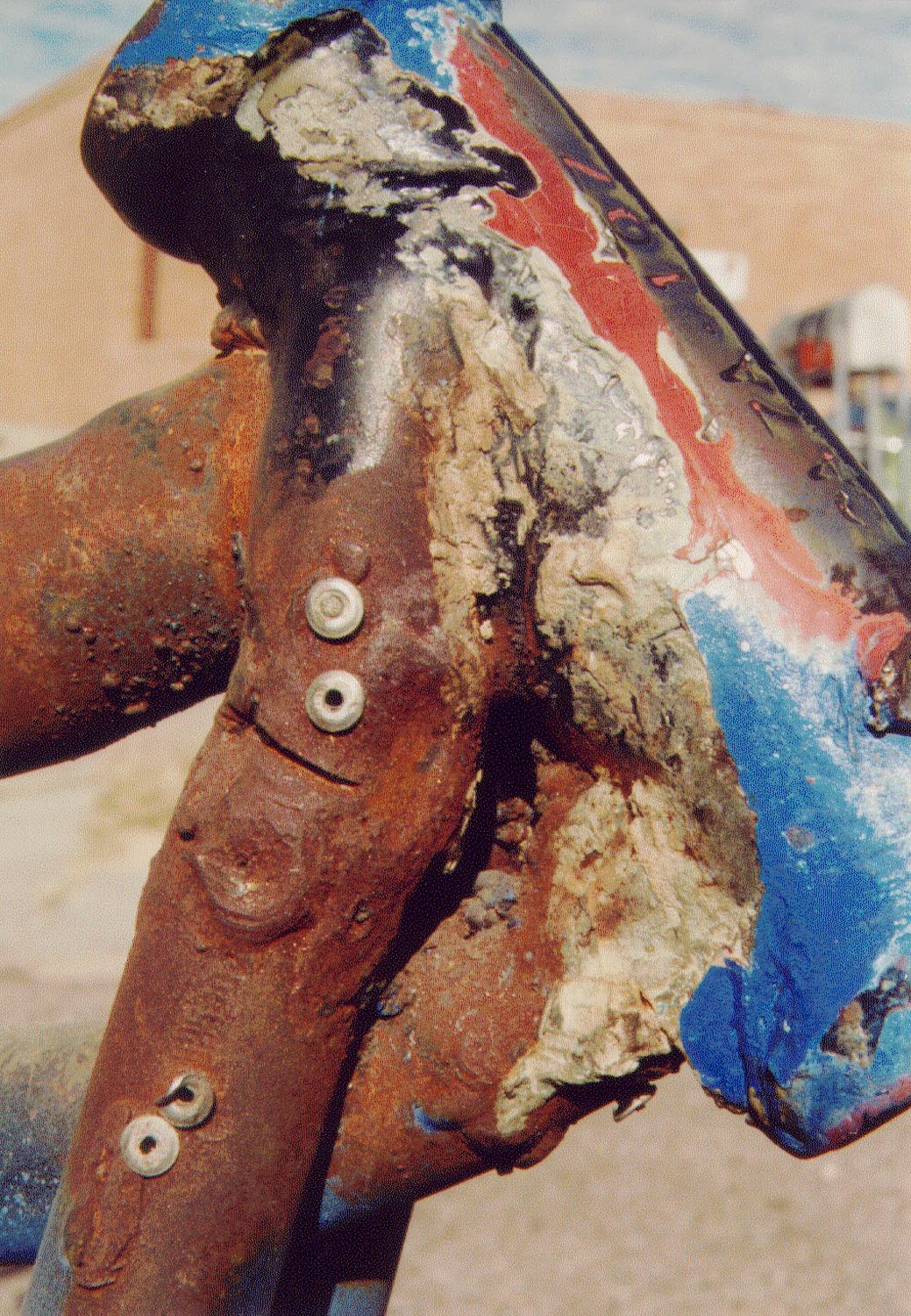

In a lucky purchase, I bought sight-unseen a bunch of BSA parts that turned out to be the world's first BSA Spitfire Scrambler (serial #1). However, some previous owner had started to make a chopper from it by changing the rake. When I removed the Bondo from the front end, I found that had he finished his project he would have been riding with a front end held together with pop-rivets.

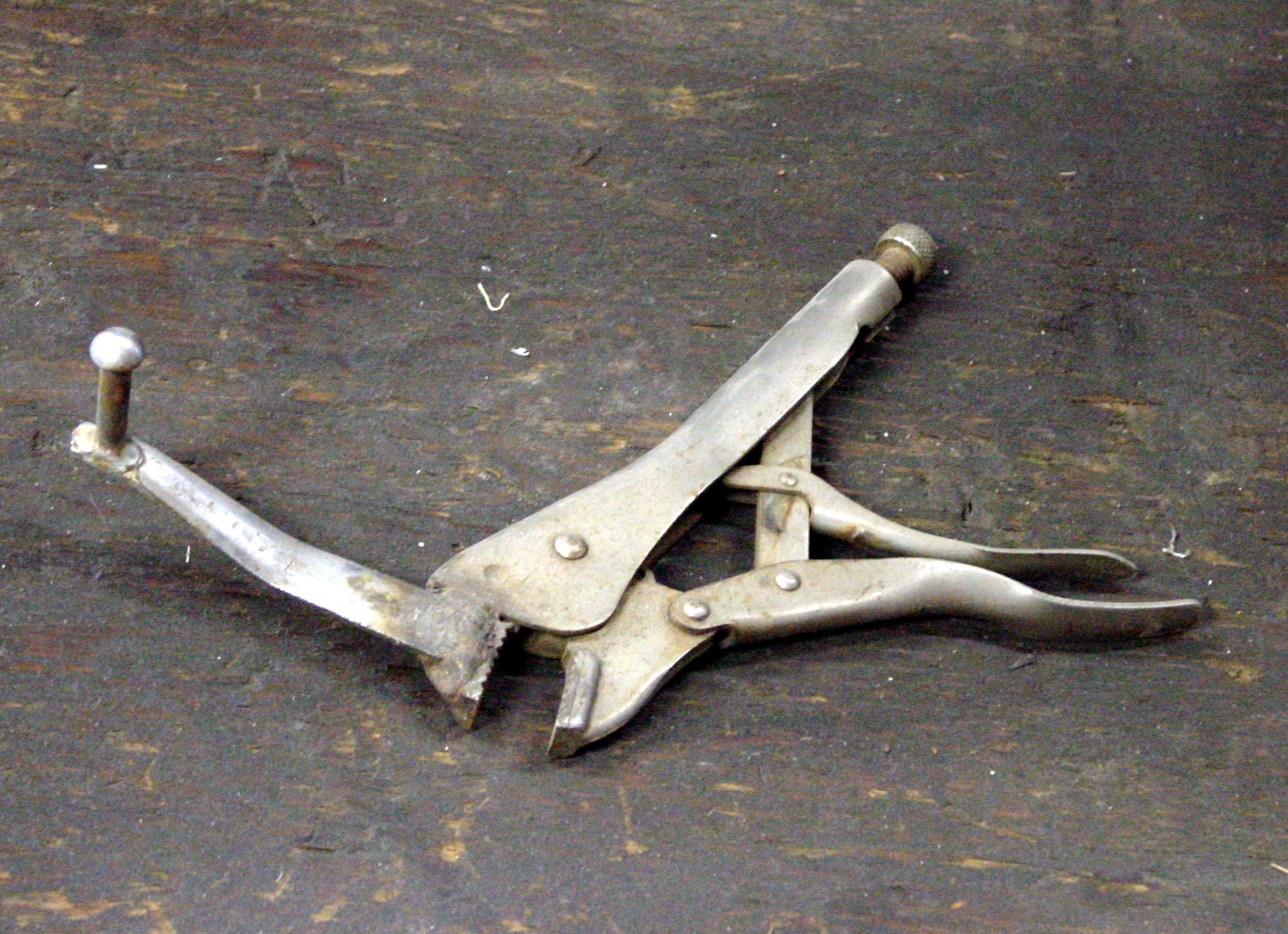

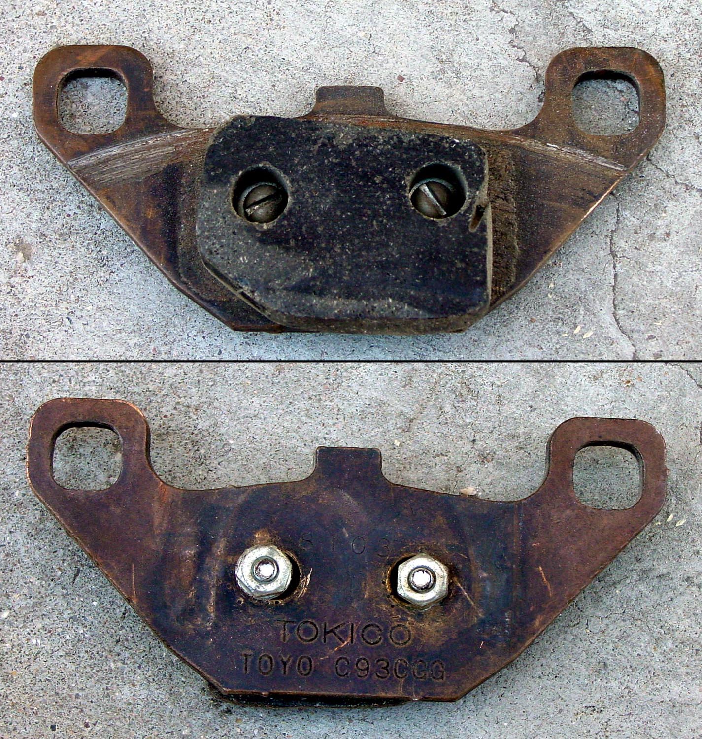

A friend who owned a motorcycle shop had a "Wall of Shame" where he kept examples of bodges he found on bikes that people brought in for service. I have photos of 40 examples, so I'll only show two.
It's common for off-road riders to use vise-grips (mole-grips) to temporarily replace a broken shift lever, to get them back home. Someone who hadn't quite grasped the concept had welded a shift lever to the vice-grips, which he then clamped to the gearbox as a permanent fix.
The second example is a disc brake pad where, to avoid paying for a new pad, someone placed their life in the hands in the shear strength of zinc-plated screws from the hardware store, holding some unknown friction material.
