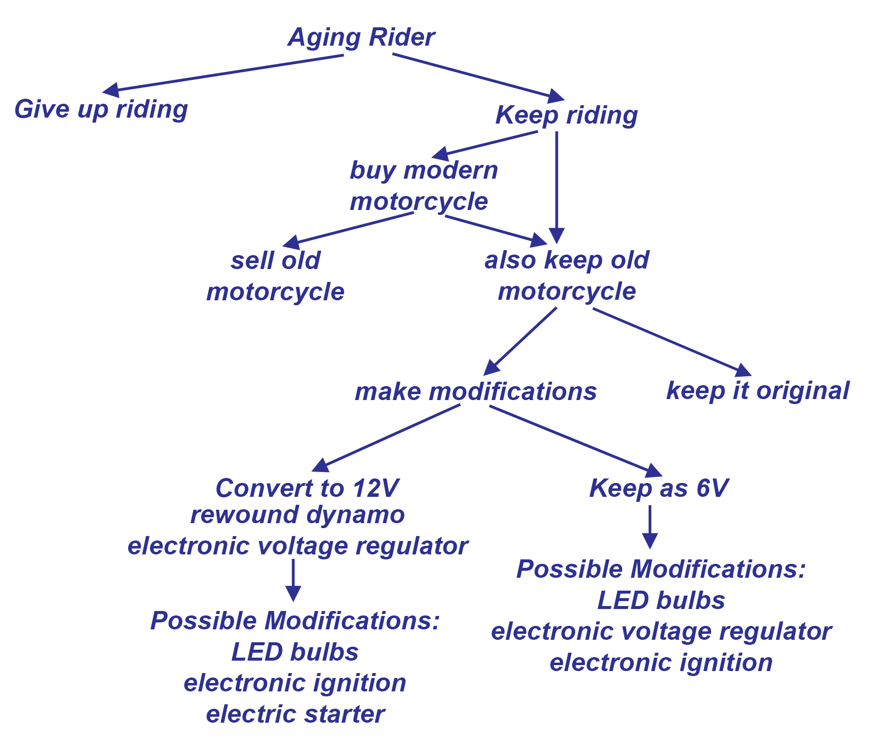

To somewhat broaden the discussion, the fundamental issue being addressed here is aging electricity. No, electricity isn't getting old, we are. A person's retirement years go through three stages: go-go, slow-go, and no-go. Many (most) of the people reading this likely are in the transition period between riding motorcycles like hooligans, and being relegated to rocking chairs by arthritis, hip replacements, and heart stents.
With the above in mind, I made a flow chart that shows paths we might take, and the requirements for some of those paths (e.g. conversion to 12 V if an electric starter is to be added to an old motorcycle).
The disadvantage of switching entirely to a new motorcycle is the cost. However, the advantages are a ~1 kW alternator, electric starter, fuel injection, heated seat and handgrips, disc brakes, …
The disadvantage of any electrical modification to an old motorcycle is having to rely on aftermarket components. Further disadvantages of adding an electric starter are the cost of the necessary 12 V conversion, still-low output of the generator, crude appearance of the addition, …
Of course, no matter what choices are made, it's only postponing the inevitable. Still, irrespective of the original reason someone had for riding motorcycles (e.g. inexpensive transportation to work or school), it's a good bet that at this point something else motivates the small minority of us who continue to ride when most people have opted for the comfort of automobiles. But, small minority or not, for people who refuse to age gracefully, postponing is a worthwhile strategy.
