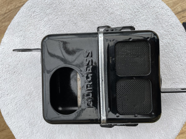

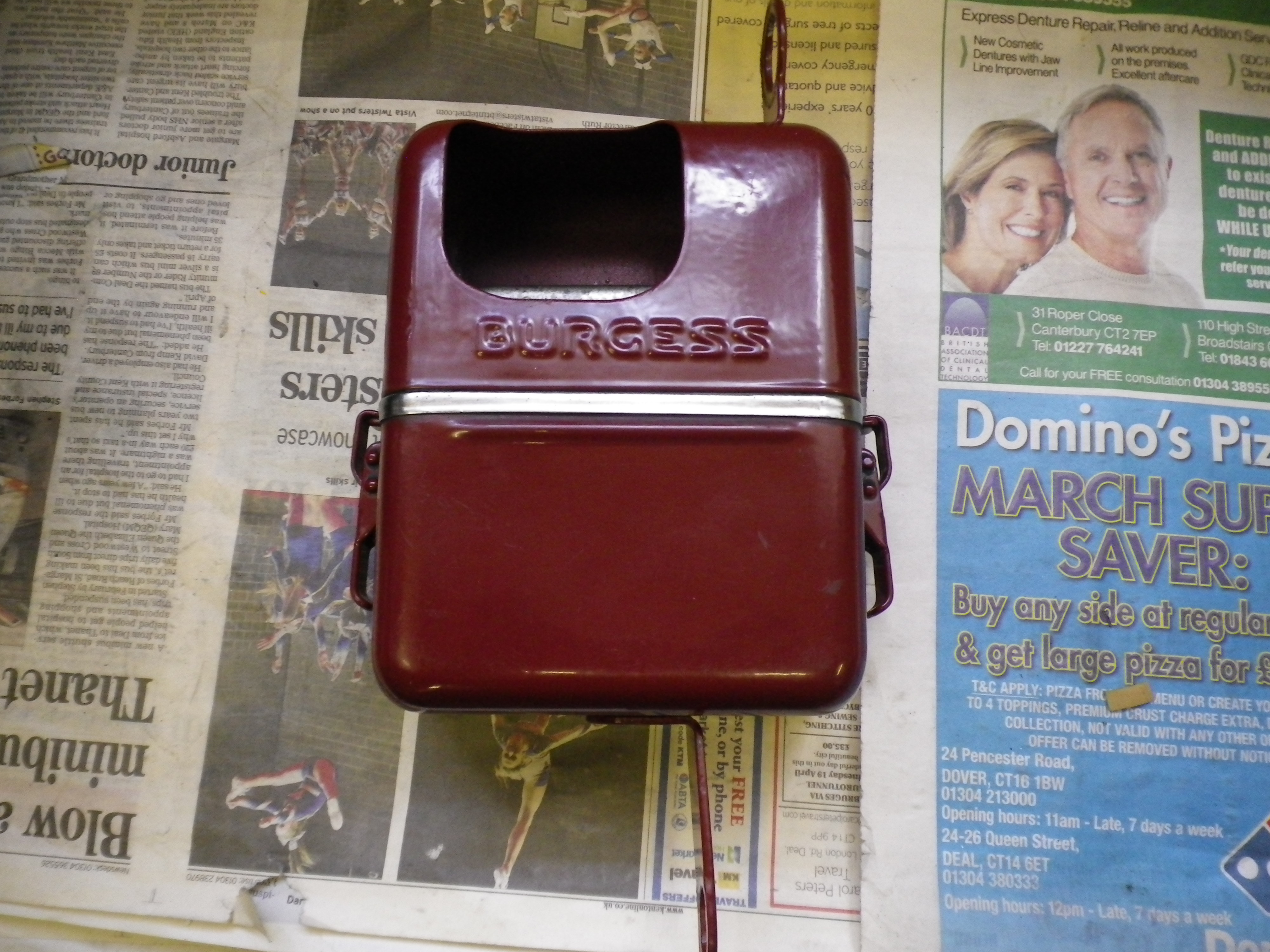

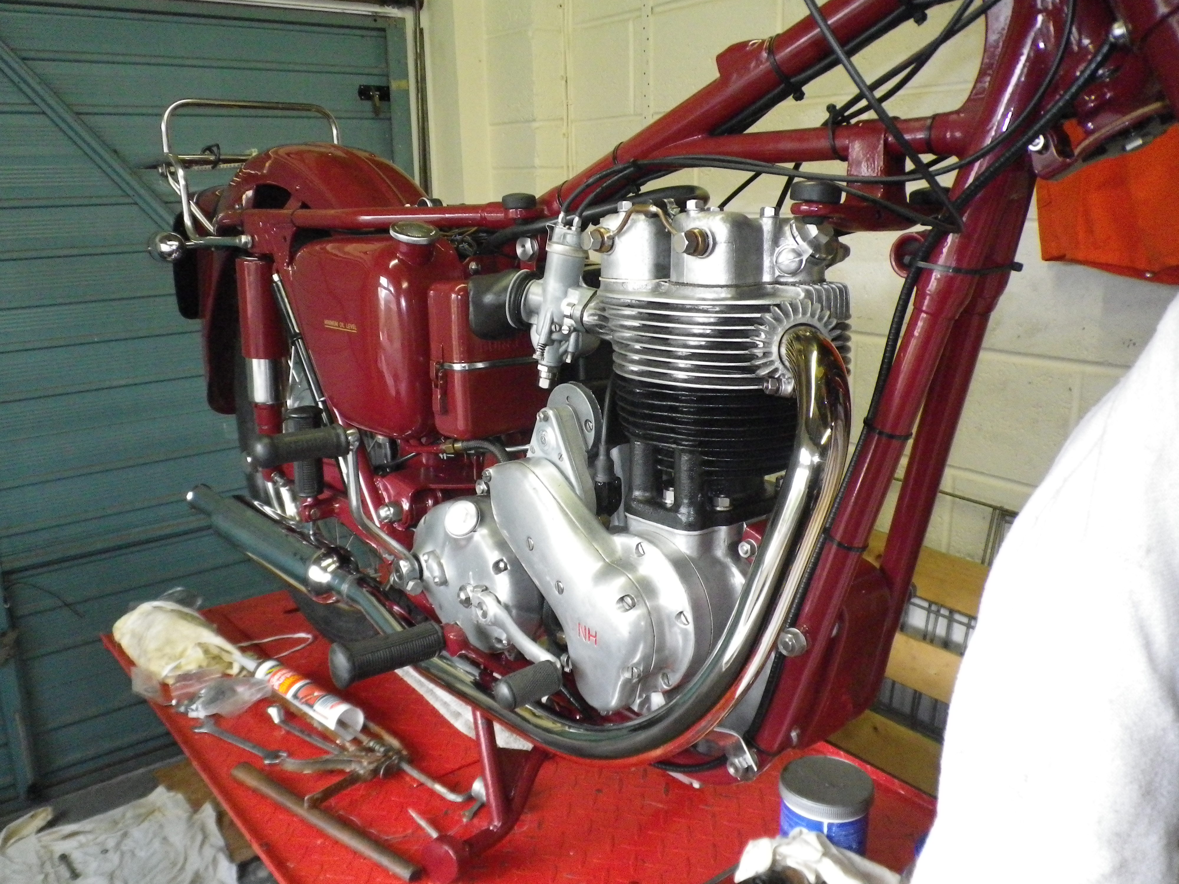

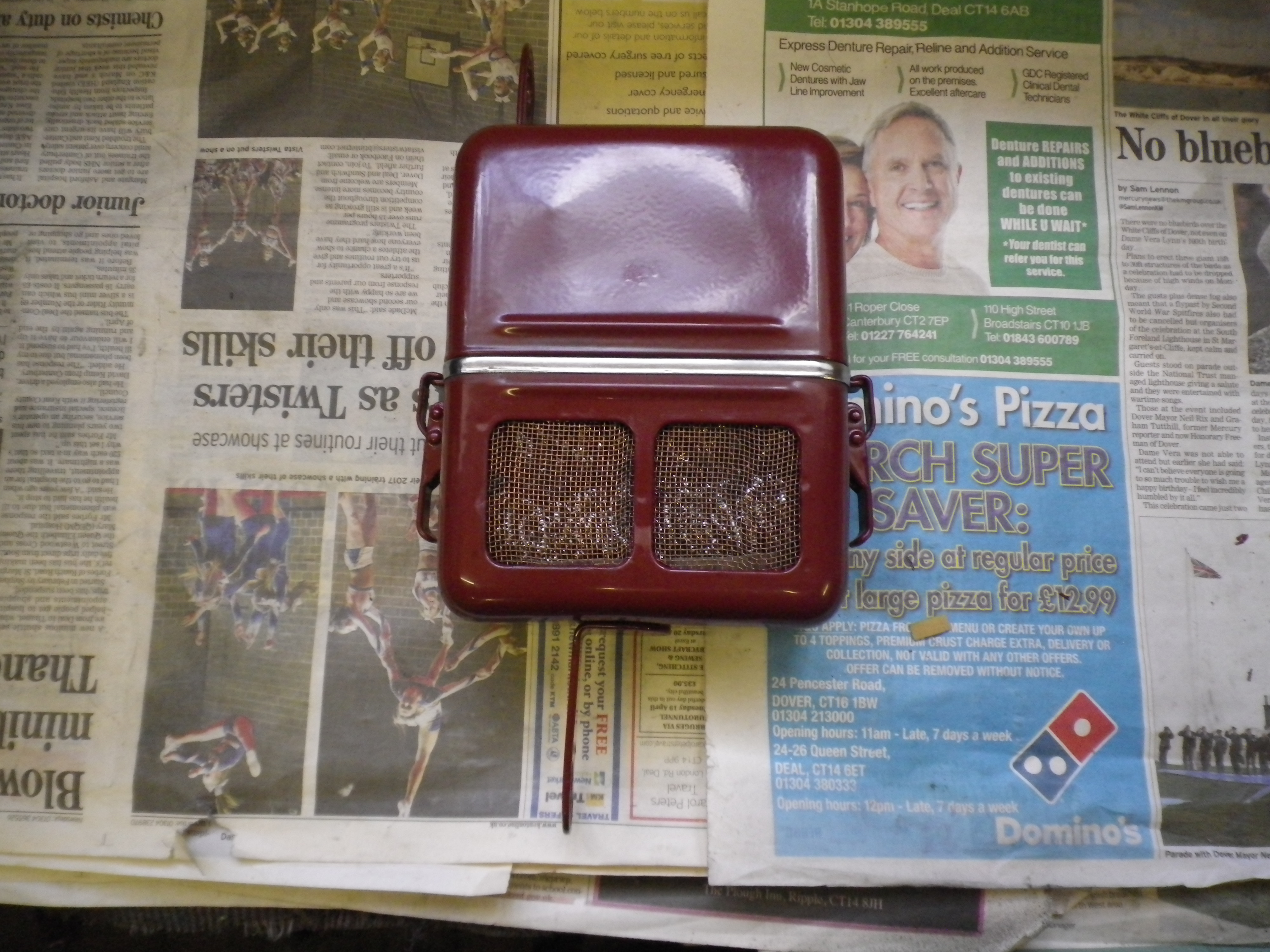

Be careful when buying the correct Burgess air filter box Paul. The late NH one is specific to those models I believe. I have attached a couple of images of my 1957 NH filter which will be what you need for your 59 NH. Take note of the cut-out where the air filter rubber connects as it goes up and over the top edge of the top part of the box. Bottom of the two section box should be the same across the late 350 to 650 model range and is interchangeable.
