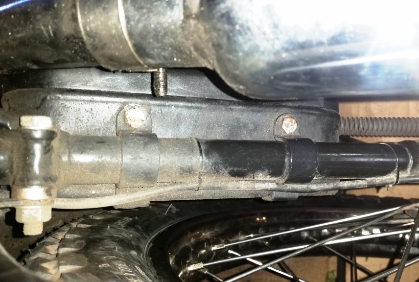

Pete.Silson
- Posts: 389
Re: Rigid Toolbox fixing
Keith,
These pictures are of the original toolbox on my '49: The mount is quite close to the ridge. Possibly your pattern box is narrower than the original so maybe you could pad the rear mounts out a bit to take up the difference.
Pete
Pete

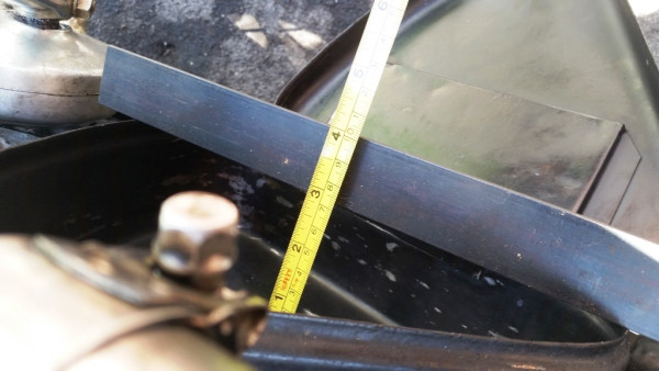

- Keith.owen
- Posts: 1237
Hi Pete,
It looks like I have a minor challenge here. Could I ask how deep your box is (measured on the inside from the top to the back)?
I suspect that the ones that I have, although from different sources and both pretty much the same, are possibly not as deep as the one on your bike.
Maybe I'll have to improvise the fixings.
Thanks and BR,
Keith
Thanks and BR,
Keith
Keith Owen
Past Editor - Cheval de Fer
1950 Rigid Ariel VH
1951 Rigid Ariel NH
1952 Plunger KH
1950 Rigid Ariel VH
1951 Rigid Ariel NH
1952 Plunger KH
Pete.Silson
- Posts: 389
Not a challenge - a learning opportunityIt looks like I have a minor challenge here.
- Keith.owen
- Posts: 1237
Ah,
That explains things!
The boxes that I have are 2.5 inches high, which is why the bracket doesn't fit, as is. A spacer will clearly be needed.
Looking at one of the boxes, it looks to be 'left handed'. Interesting.
pete, thanks for taking the trouble to get back to me. Much appreciated.
Keith.
Keith.
