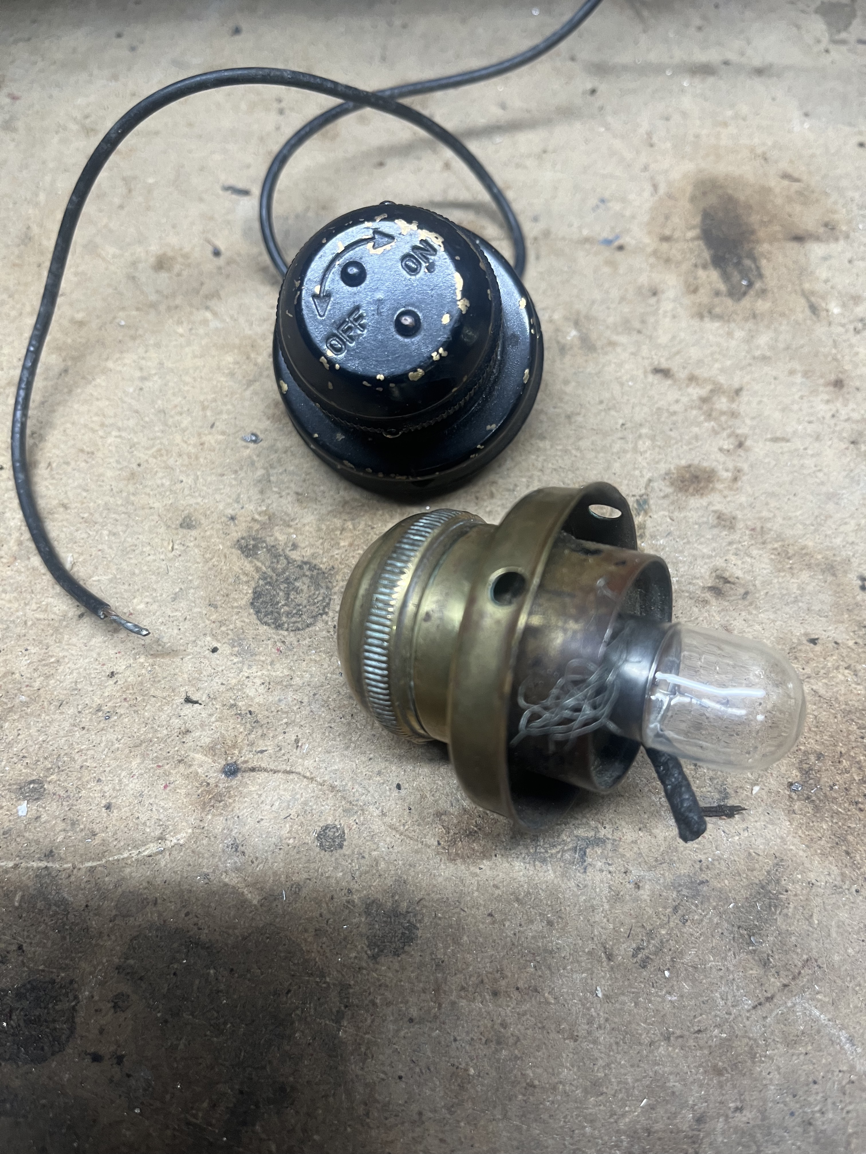

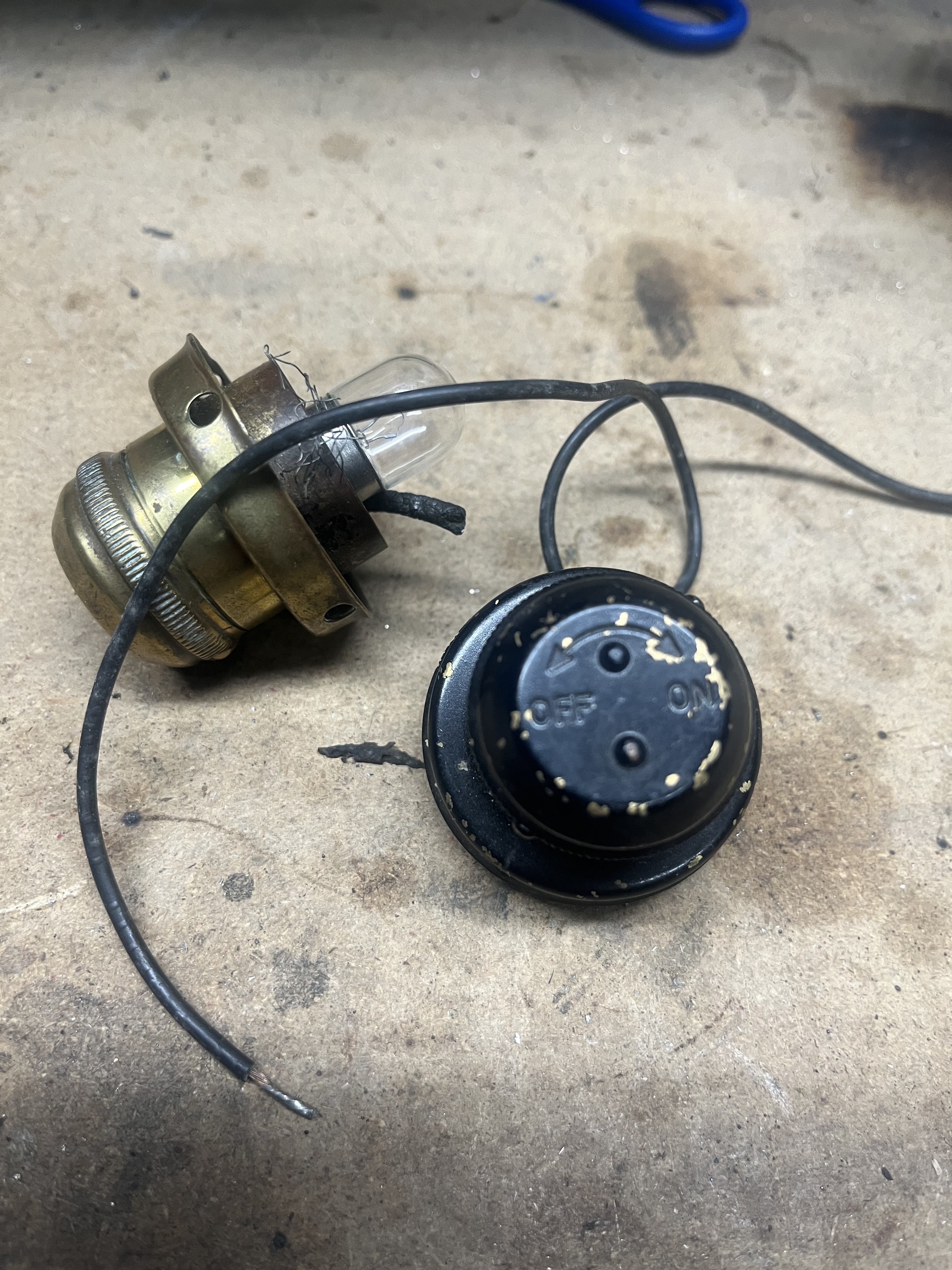

An original and a club copy

Thanks Mark - it appears that I have an original lamp as well.

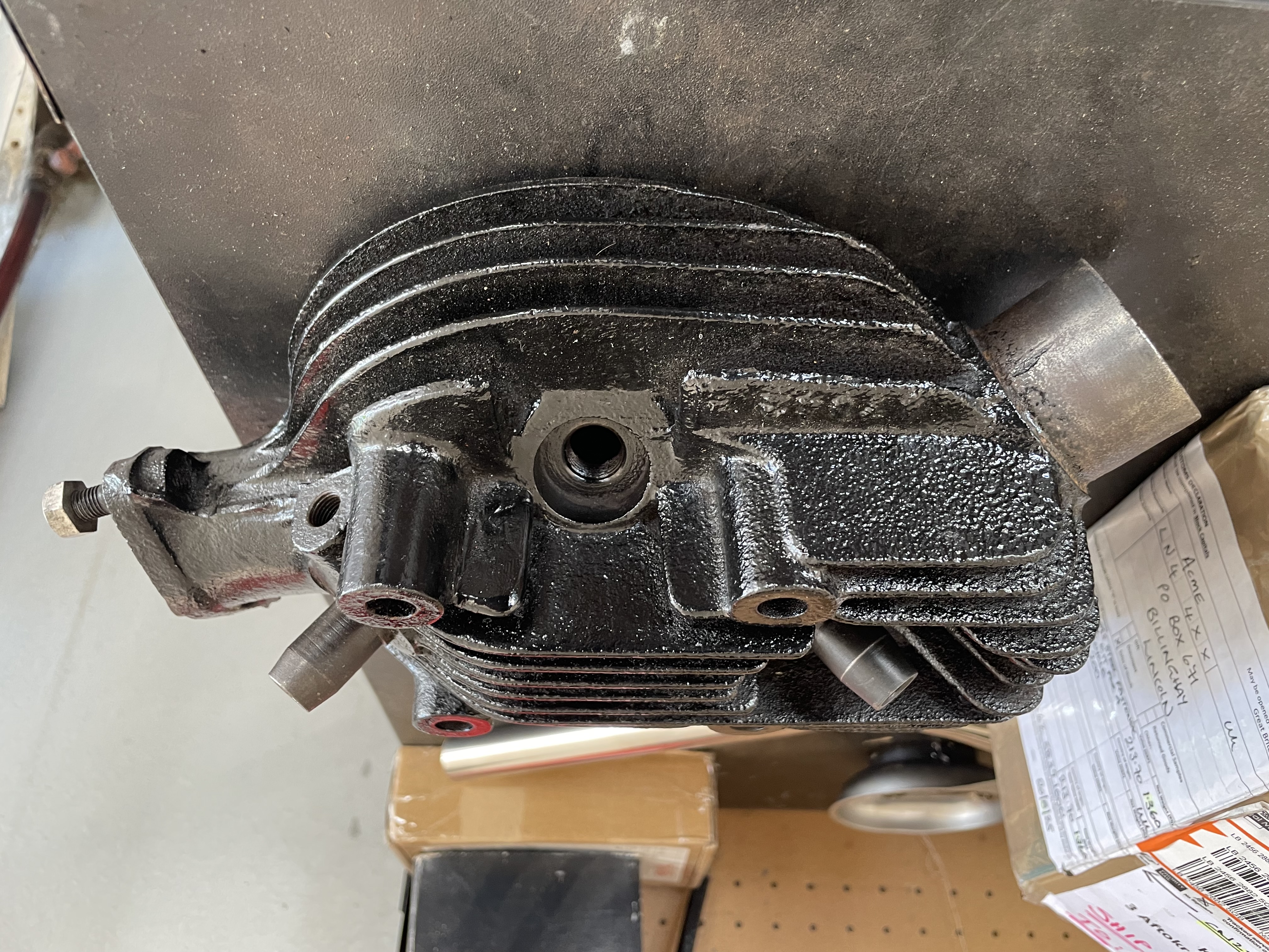

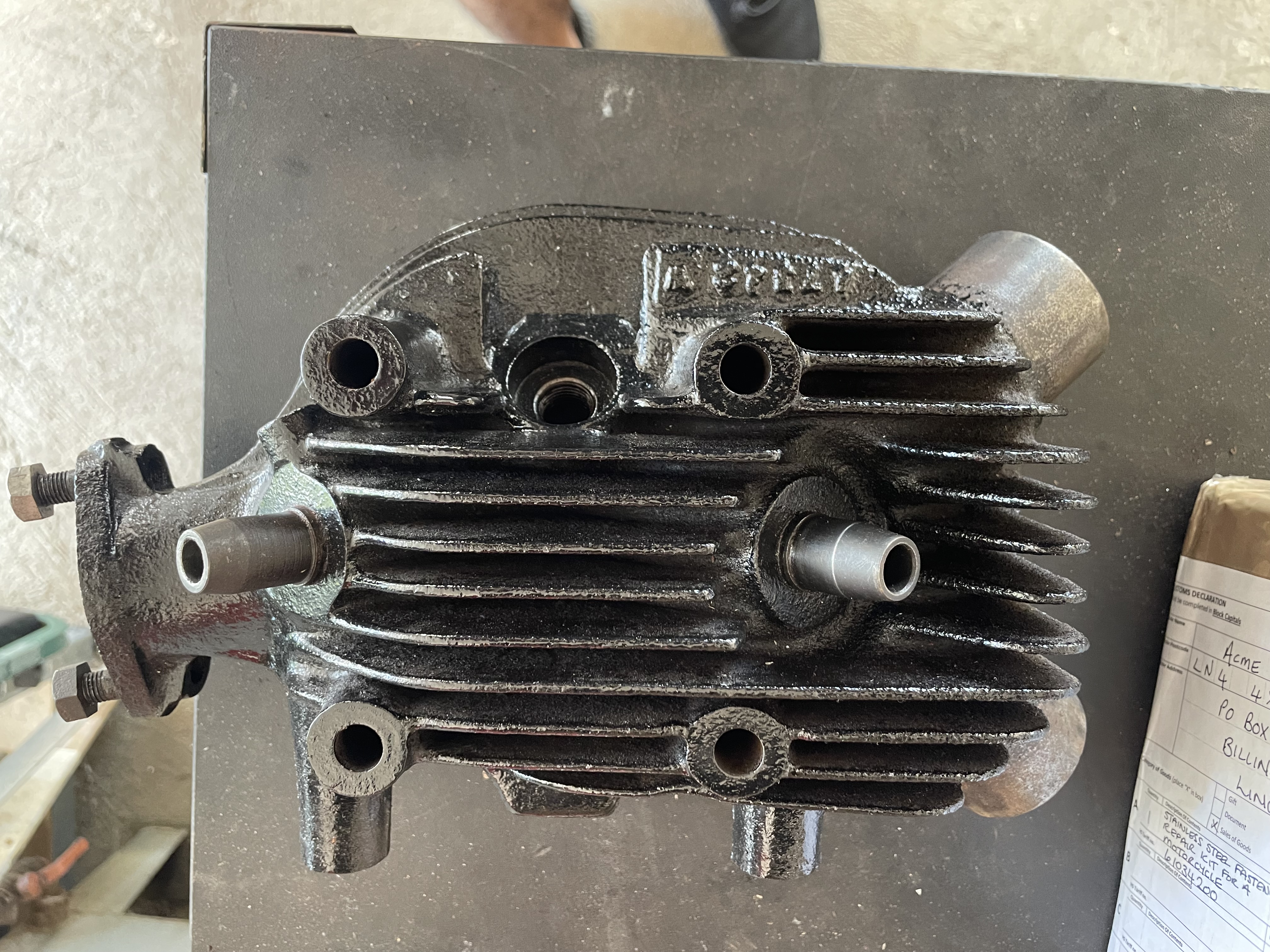

So after a few rejections from some machine shops to fix my cylinder head, i found a local guy who installed steel valve seats at 0.006” interference fit. He did machine slightly one valve guide though to get his tool there..
Let’s see if it works and for how long.

Looks to Have 1 Bronze Guide? Why is that? I presume the Inlet is to the Left in the Picture. Looks OK to me. Nev

Hi Nev, it is not bronze it’s just shiny due to the photo angle and the other one also new but machined a bit on the end (looks like broken off).
