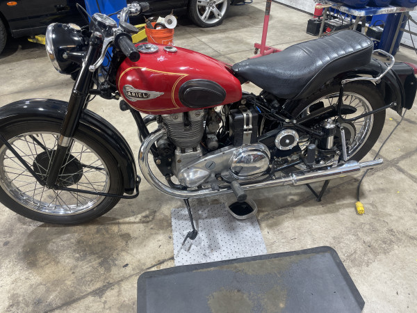

Hi Folks,
This is Rob in Canada, with a new to me '53KHA.
I first saw this bike in the early '80's at a local British car and bike shop. The bike caught my eye, and I took a picture of it in the shop, next to 3 wheelers being worked on. See picture.
40 years later, I bought the bike!
I got the old girl running after figuring out the no-key, emery cloth and set points.
It has been restored so it ran well, with oil circulating back into the sump tank.
But, I'm getting leaking of oil out the drain hole of the chain case when running.
What's happening?
Thanks,
download/file.php?mode=view&id=40937
Rob
download/file.php?mode=view&id=40938
Oil leak from chain case

Re: Oil leak from chain case
The level plug is too high only enough oil for the chain to touch
Dave
Dave
- Posts: 5590
Just undo the Large filler Plug and check how much oil flings round when the Motor is running. It COULD also Involve how the cushion drive has been assembled. It's entirely different from the singles set up which can't be used as the spline is not Hardened. Check before further use would be advisable IMHO. You Might Be able to see it with a well focused torch. Other wise off with the clutch and outer cover. Nev
