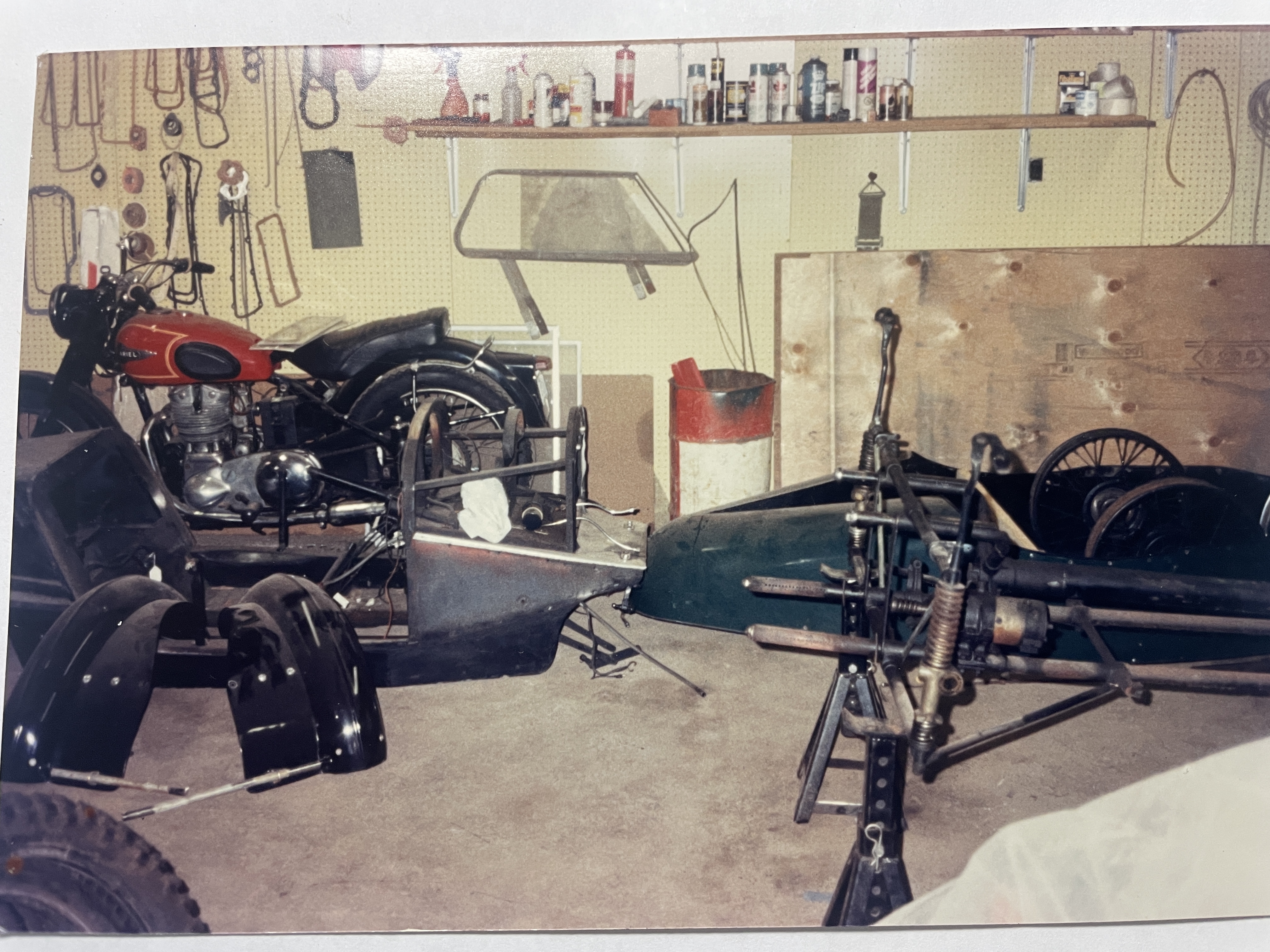

I first saw this bike in the early '80's at a local British car and bike shop. The bike caught my eye, and I took a picture of it in the shop, next to 3 wheelers being worked on. See picture.
40 years later, I bought the bike!
