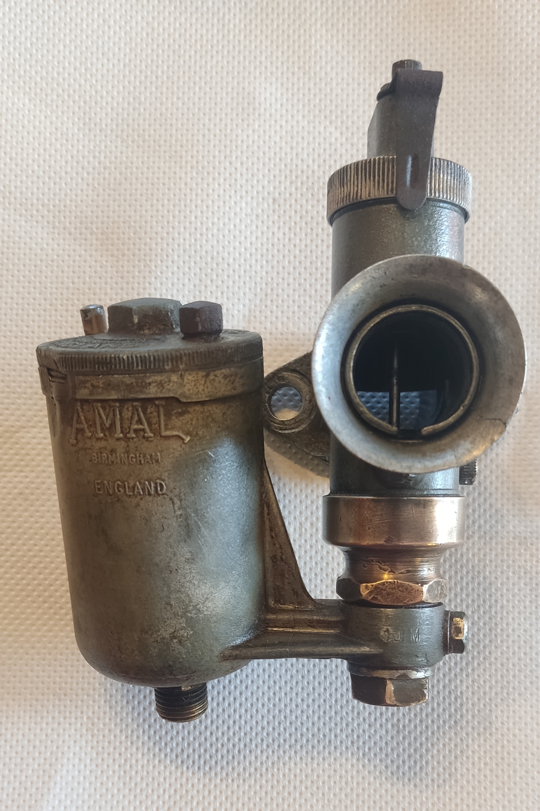

Hi, I am restoring a Triumph 3HW in which there was a carburettor Amal 275 014R/1J 7/8 bore. It isn't ideal for me so I am going to sell it.
Amal 275
Amal 275
