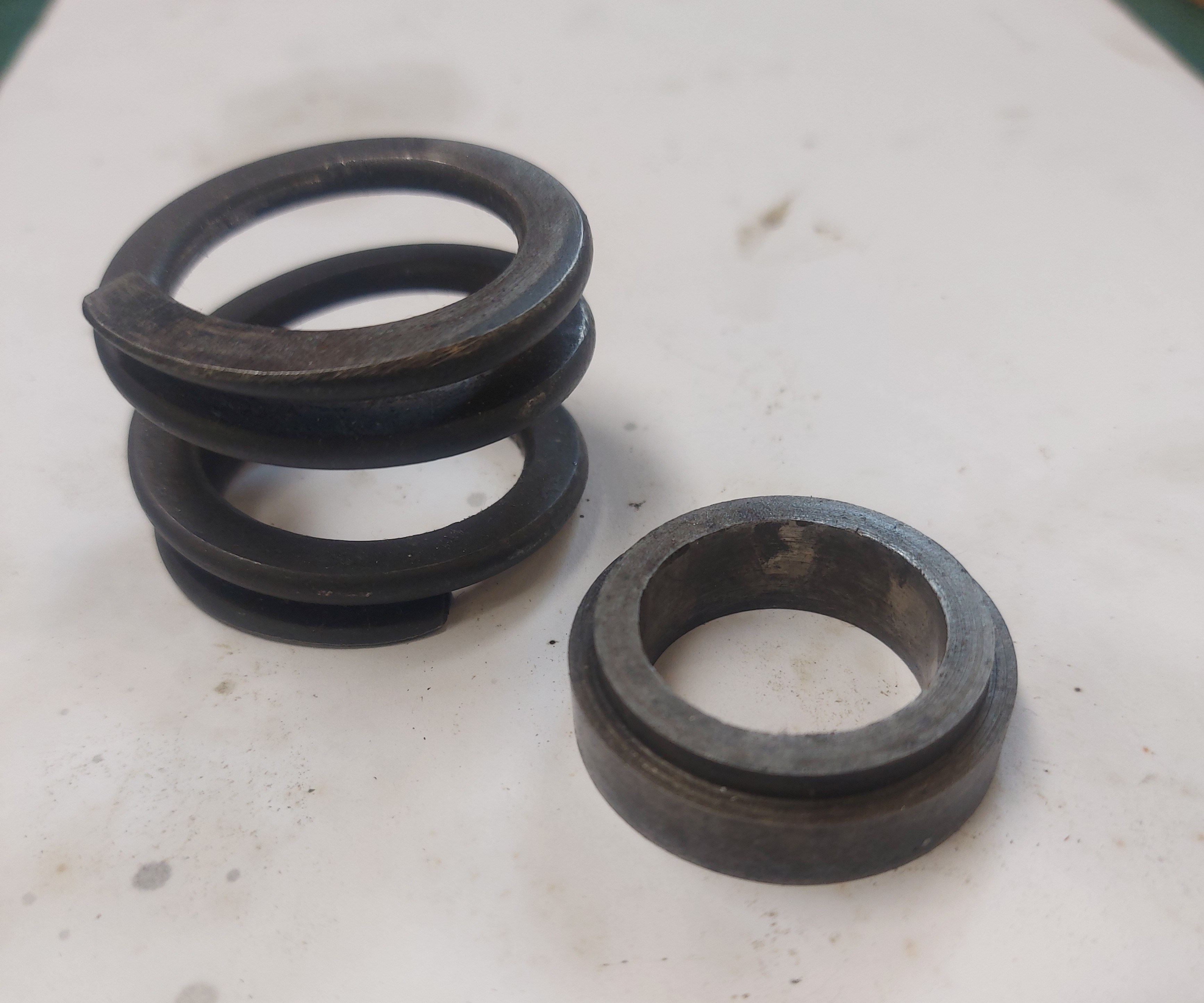

Need a bit of guidance...
The picture shows the bits of my 1930 Model A crankshaft shock absorber, as they came off (not the scabby footrest!) - the big nut was being used as a spacer.
The spring and its 'retaining collar' are missing. Lee suggested using a Lambretta spring, which is on the way, but could someone help me with a picture of the assembly (or pictures of bits) to help me make the collar?

Hi Simon
I have a Lambretta shock absorber in bits on the bench at the moment if you need any dimensions.
Regards Mick

That's a lucky coincidence! Would you mind measuring the ID and length of the spring?

Looks the same as on my '28
ESA spring sits behind the sprocket.
you mean the collar against the bearing?
I can make a pic from the collar, but perhaps Karol has one?

Hi Simon
Free length = 37.5mm
ID = 35mm
Wire dimeter = 6.85mm
Regards Mick

Thank you Vincent. According to the parts book, 28 is different but I'm not sure how yet - I think the dynamo sprocket is just sandwiched in there.
A picture would be great.

Lovely thanks. I'll do some measuring!Mick D wrote: Wed Nov 12, 2025 8:56 am Hi Simon
ID = 35mm
Regards Mick

pics from the distance piece, simple thing.

Lovely thanks Vincent. Presumably that's the bit that goes against the main bearing?
