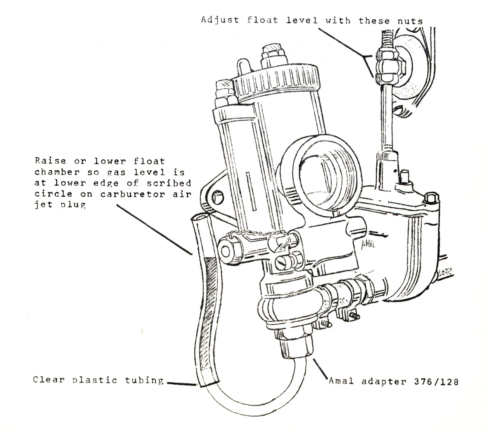

Since this thread originally was about flooding, I thought it would be useful to show the tool I made when I was preparing my 1928 Ariel's pre-Monobloc carburetor.
In case it's not apparent, the function of the clear tube is the same as is shown for a GP in a Gold Star manual.
