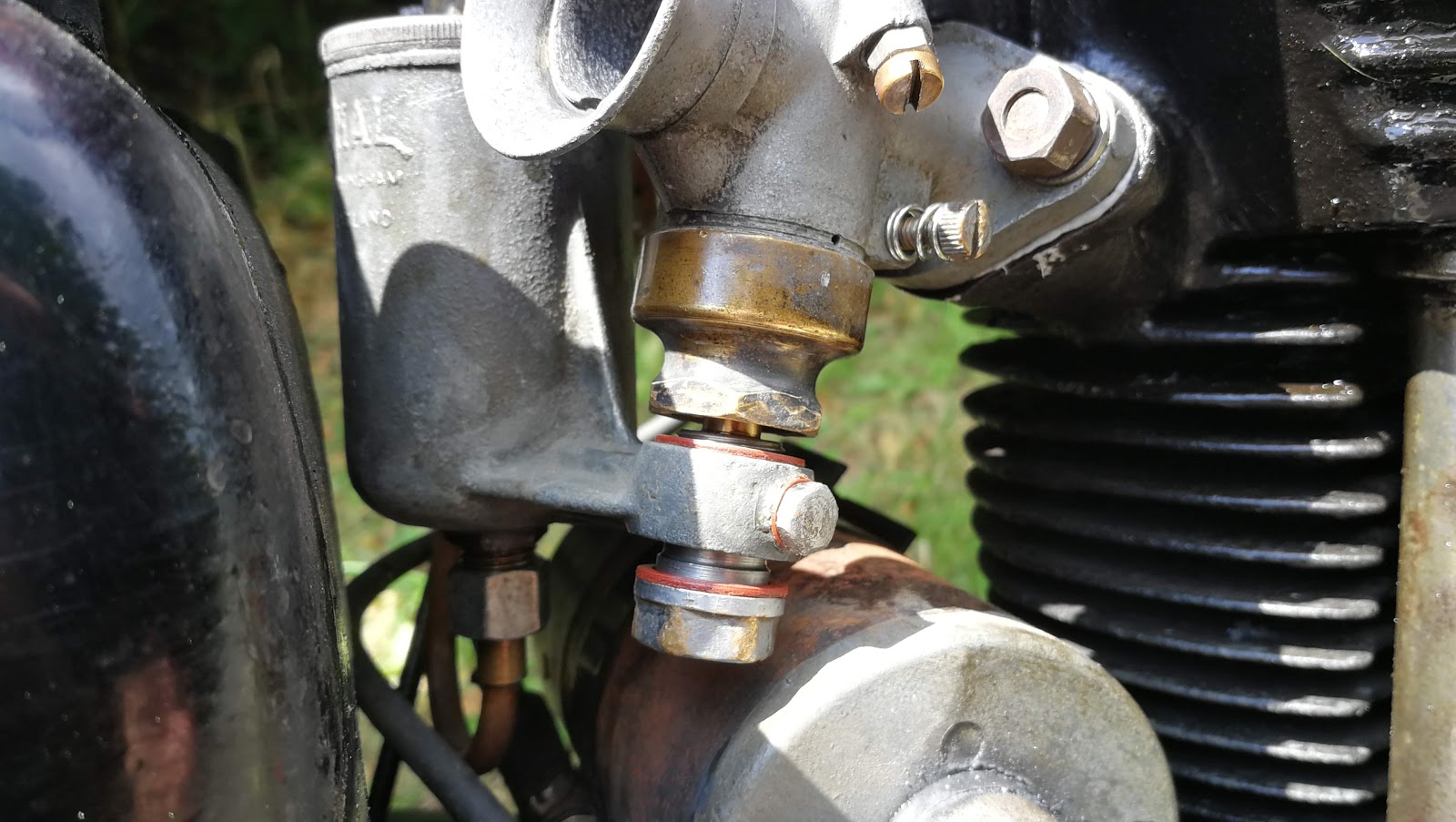

The thicker washer goes between the float bowl 'banjo' and the big nut on the bottom of the carburettor.
I replaced the upper of the two fibre washers in this picture with a dowty washer, which drops the fuel level by a couple of millimetres.

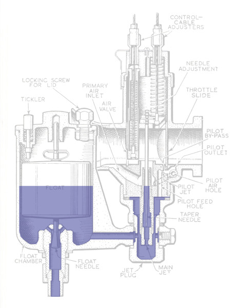

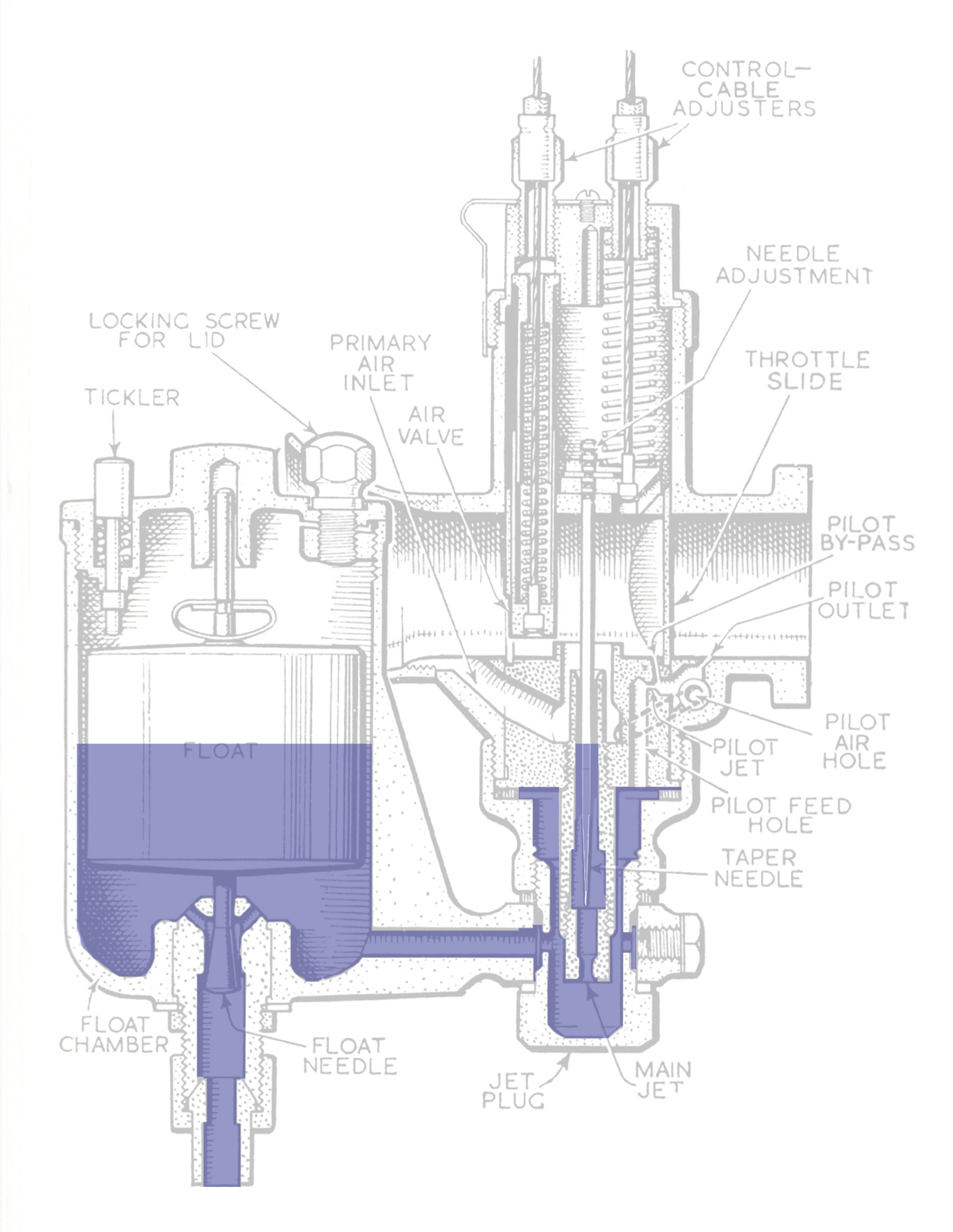

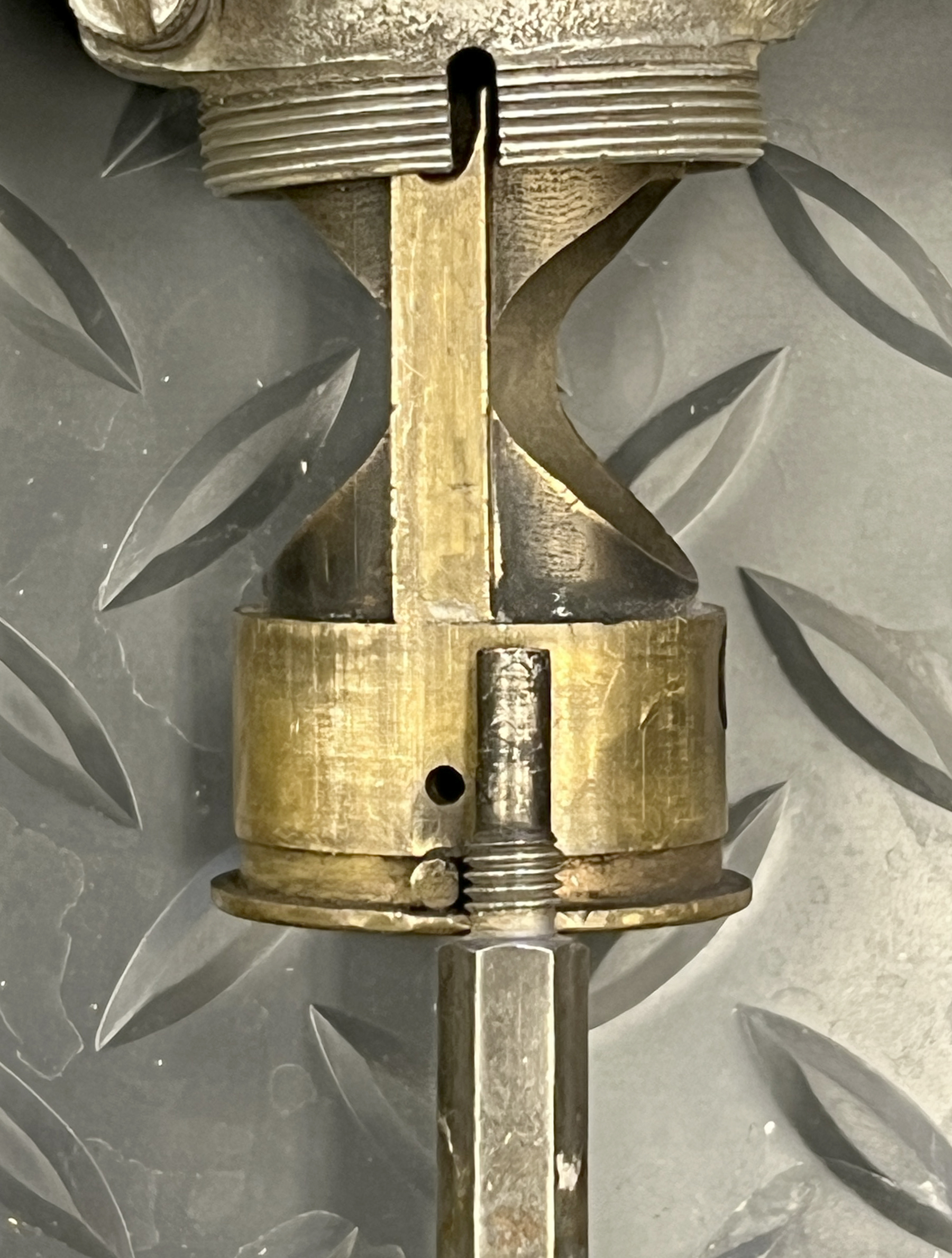

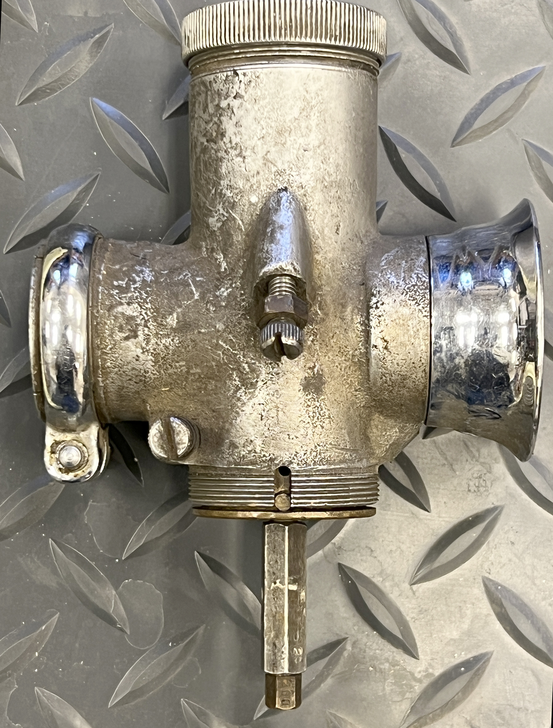

That depends on your definition of "just below." My definition would be that it is "quite a bit below." The first photograph shows a hole in the jet block that's at the top of the slot used for registering the two components.nevhunter wrote: Sat Jul 12, 2025 2:36 amThe fuel level should be just below the Needle jet top surface.
The next photograph shows the jet block after it has been withdrawn, and with the needle jet showing the location of the hole with respect to the top of the jet.
If the fuel level is any higher than the bottom of the hole, it will leak from the carburetor.
The final illustration of the the internal configuration of the carburetor shows that if the fuel level is any higher than the bottom of the Primary Air Inlet, it will leak from the hole shown above.
