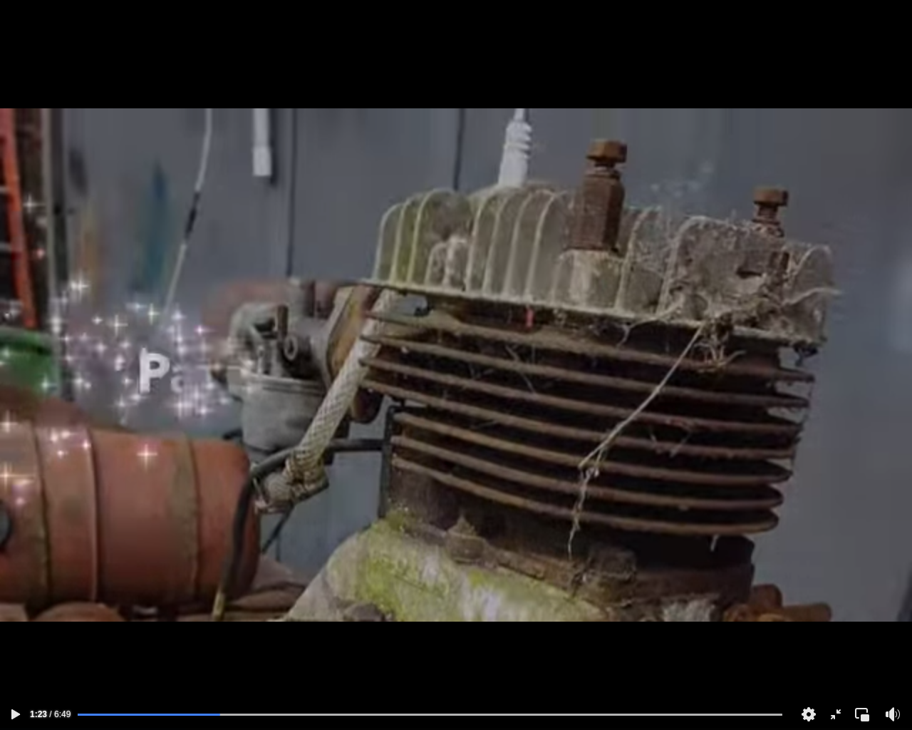

Thankyou l will look for Drags they’re for a 1954 BSA 420 cc that’s the power unit for the Trac Grip I’ve just bought l love forums like this as l find all engines interesting and the talented people that post their work.

The only 1954 BSA using shell bearings was the A7/10 twins, unless you have an industrial engine. Do you have an engine number? I think that number is for an individual shell, the sets have a different number, and was used on Ariel KH and SQ4, neither of which was ever 420cc. If so Draganfly part K140-47

Trac Grip - definitely not an Ariel (although they did once make various 'traders' machines!) I guess John's casting a wide net. :D
Engine looks to be a single-cylinder side valve.
There's a vid on FaceBook about a restored one (which is where I got the pic):
https://www.facebook.com/watch/?v=2637171076414865

I have never heard of a Trac-Grip. There used to be a firm in Sarf Lunnun that specialised in industrial engine spares, Meeton's I think it was, no doubt long gone. That shell number was certainly for KH/SQ4.

Thankyou all for the information, it’s an industrial engine that apparently shares the same big end shell bearings as an arial either 500 twin or sq 4 it’s early days of the restoration so everything is very new to me l really appreciate you taking the time to reply and help me with my seemingly never ending journey into the distant past.
