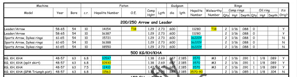

Inside I found at one side „Heplex 10930“ and C52
and on the other side „3447 AM 413“ and also a patent number
So it seems to be a Hepolite Piston as Dragonfly sells them
Ariel KH 500 Twin 1954 (Modell 55)
- Posts: 5701
Re: Surprises when lifting the 55 KH 500 Twin cylinder head
That's a "W" slot split skirt type. The crown runs much hotter with them although the twin oil pump is high volume and would help. Re ring and use as is? Nev.
This would of course be the cheapest option. There are no traces of jamming or similar on the piston. Only discolouration indicates that it has been blown into the crankcase via the piston rings. Martinnevhunter wrote: Tue Dec 31, 2024 12:45 am That's a "W" slot split skirt type. The crown runs much hotter with them although the twin oil pump is high volume and would help. Re ring and use as is? Nev.
- Posts: 5701
There's life in them still. I always use the solid skirt, unless the Motor is going to get an easy time. That type requires more clearance to ensure it won't nip up. Nev
