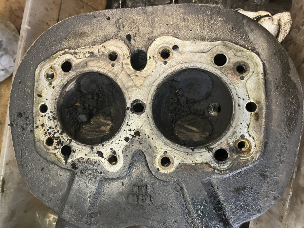

I have already read in the manual of my KH 500 Twin that the engines tend to carbonize and that the cylinder heads should be decarbonized regularly, but I didn't expect to come across a carbon mine.

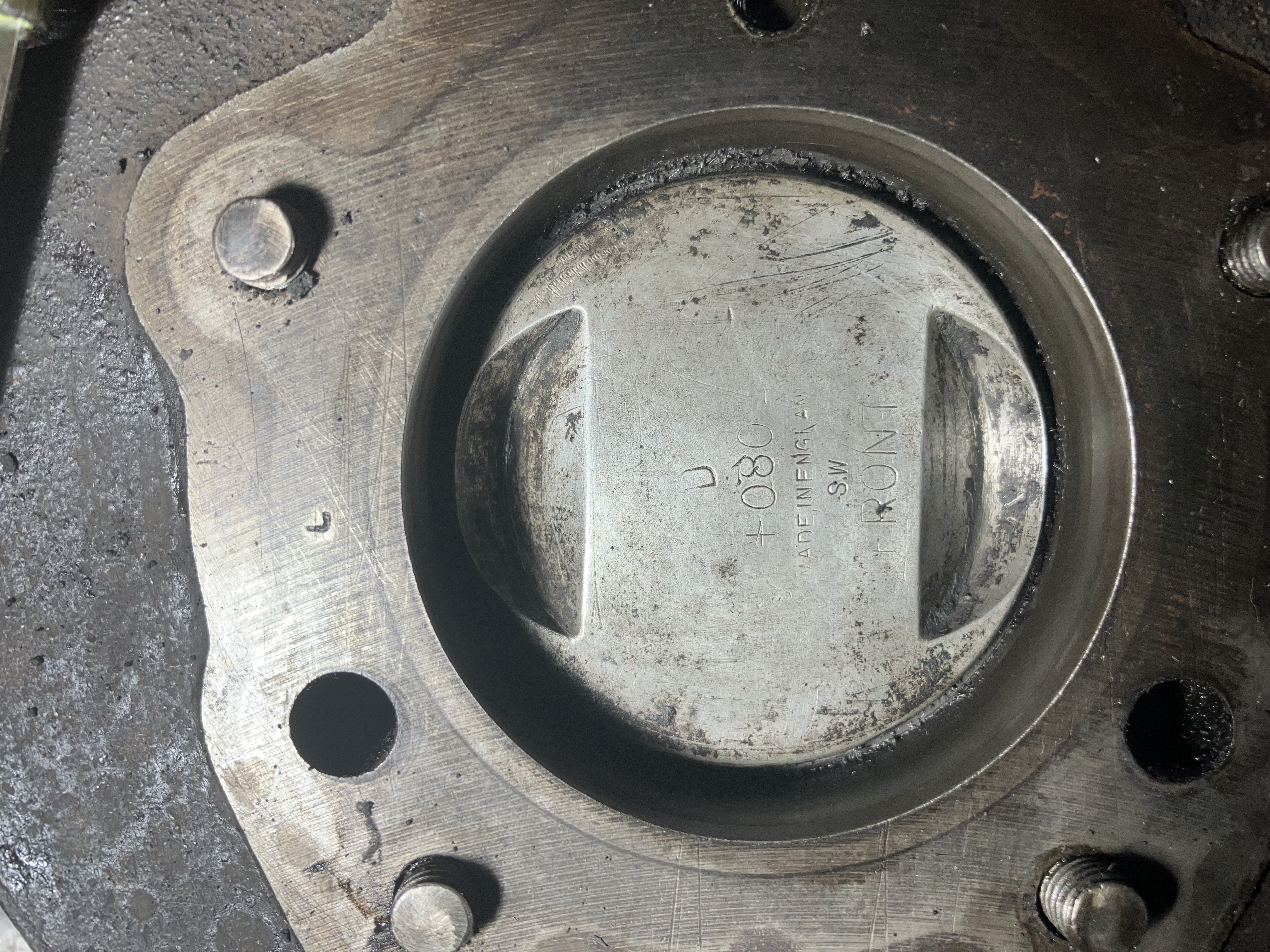

Where does the tendency of these engines to carbonize come from? How much carbon can be normal and when it might be caused by an problem? I also did not expect a piston with an oversize that I have not seen on offer at any dealer so far. Does anyone here know the pistons with + 0.80 oversize? That would probably be the 4th oversize for the cylinder. Could that be the case?

Could they be triumph pistons?

De-carbonising used to be a regular chore but modern oils and fuels have stopped all that amusement. I have never seen such carbonation before, which is nothing to do with old technology but rather to do with something seriously wrong with the engine. Has it been run on scrap wood? What are the numbers from inside the pistons? +.080" pistons have been made for a few popular models that have thick enough cylinders so they may be Triumph ones, as Dave says. The KH is not really popular enough.

Pretty sure JP Pistons AU will supply Pistons and rings made to special oversizes where you might hone that bore and go up ONLY +003" (as an example. Don't rebore metal out as by the time you set it up, you might have to take another +020" out. The pistons might be OK for more miles as they are. Check the top groove Wear. Check valve seat wear also. (Pocketing). Might need new inserts. Best put in with liquid nitrogen. Like with Porsches). Nev

Take piston off and check the number inside

Alloy rods fatigue more and that can't be reasonably checked by non destructive methods. Detonation loads up engine innards. Use colder plugs with High Compression, high speed or sidecar work. Make sure there's not a lot of carbon build up.
I had a look 500cc twin cylinders I have and the extensions below the Lower mounting flange should cope with +080. Clean carbon carefully from the ring grooves and check wear particularly in the top one. Clean holes where the Push rods go. Putting the head back on can be a little fiddly re the Push rods. Nev

I've never seen an engine so heavily carbonized. I think you might be burning oil, or you have a very poor mixture. Under normal conditions, you can't accumulate that much carbon. For comparison, the photo shows the KG engine head that we removed due to a damaged gasket after 10,000 miles (I have no idea how many miles the previous owner had driven). I bought the motorcycle already refurbished.
