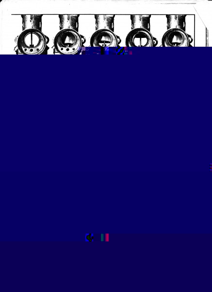

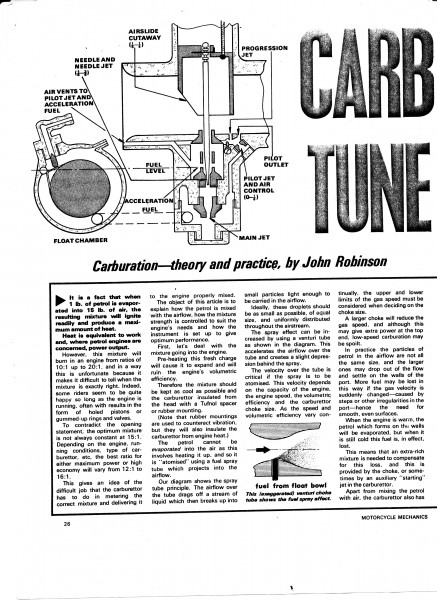

Hello,
These two pages from a 1960's Motorcycle magazine may help.
Brian H.
