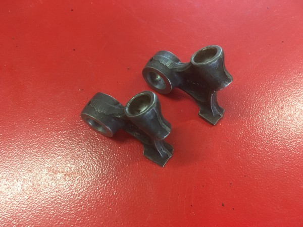

Can one in this forum tell Me what bike this followers fit on?
In advance thanks.
Jorgen
Followers.

Hi Jorgen
They are from a 1932 Sloper either SB or SG. The extra lump on the side is for the decompressor push rod to push on. I believe the decompressor was only ever fitted to those models for one year. A shame they are worn out.
Paul M
