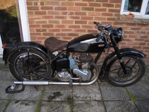

Hi all, I am a very proud owner of a rigid Ariel vb600 of 1954, It used to be my step fathers since the early 70's, and was passed down to me when he died late last year.........i am not attempting to do a show room restoration as this is not how my step father would have wanted it.......more just to keep it going in its original patena........So my question is this, does anyone know how rare these bikes are now?, are they something that will be seen at every classic motorcycle show?, is parts availability fairly good? and lastly are there any members on this site very familiar with this bike? as may need your help from time to time......lol....

Nick, Your VB is an unusual one. In 1954 all the singles and twins went to swinging arm frames except the VB. That went into a swinging arm frame in 1955. So that tank desinged to fit the rigid frame but with the chrome flashes was only for 1954. I think VBs generally are getting rarer since people keep fitting ohv top ends to them. I like my VB, it is relaxed and easy to ride. Good luck with it.
