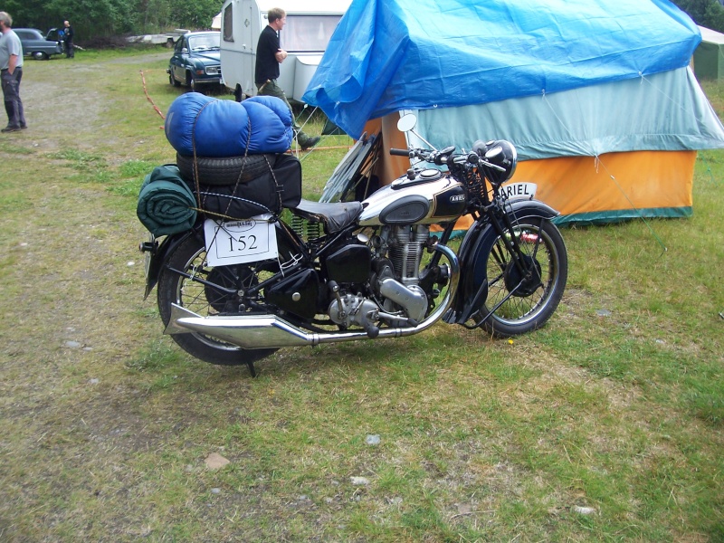

Attaching five photos of UK owned VCH bikes.
Would it be possible to get more info about these bikes?
Better photos, info and engine numbers?
I would like to update my old VCH article with more pictures & information.
/Ralf Arvidsson, Sweden

Non of these frames are COM just a CO engine in a frame, as far as i can find they started at CO 101 and ended at CO 160.
You can find info under "fourstroke" - "search" -VCH.

The lowest image has the shortened frame. You can see how close the rear guard and wheel are to the gearbox. It also has the muffler mount lug on the upper rear RH frame member. If you look carefully at the correct frames the rear wheel mount forgings are quite different to the "normal' Ariel rigid frame. They should also have a folding cranked kickstart lever (to clear the muffler) they also run the "small" oil tank, similar to the W/NG tank There's no room for the larger 500 tank. I'm told they use a lightweight rear stand fabricated instead of forged but I have never seen one. IF anyone has info on such I would appreciate it . The roundbase magnesium engines definitely went above 160 then used the VHA cases I later models. and even had iron cast flywheels in the later models . Good O'l BSA policy no doubt. THAT didn't help Ariel's reputation. Nev
