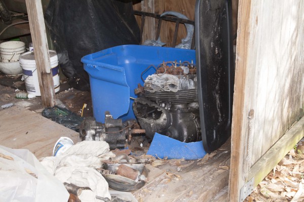

Some of you may have noticed my absence from the forum for the past 3 weeks. We have been in Florida, to package up and ship the next project back to the UK. It is one of the dozen Healey 1000/4 machines built in the 1970s using MKII Square Four engines and gearboxes. This one was burnt out on the back of a pick up truck many years ago so it will be a long difficult job to do.
The photo gives an idea of what greeted me when I opened the shed door in Tampa.

WOW and I thought my 31 VF was tough.You do indeed have a challenge ahead of you

You like a challenge don't you Paul!
So what have you bought? I see the engine & gearbox, but what else is there?

Strewth, that'll be a tough one. Who said Square fours don't overheat
Good luck

You can't beat a good challenge, but I do have somewhat easier projects to go at if I get fed up with this one. The best way to describe what I have bought is all the engine/ gearbox / primary/ etc plus all the special Healey bits which didn't melt in the fire. So, alloy rims, hubs and fork sliders melted which means I need replacements. The petrol tank is alloy so that melted as well but if you look carefully at the gearbox adjuster and on the top of the half melted exhaust you can see some of the melted petrol tank remains. Obviously, the fibreglass seat base and side panels burned but I have moulds to make replacements. When I sold my previous Healey I had this project in mind so I took a huge number of photos with many measurements to match before that bike went. Over the years I have had many conversations with fellow Herefordshire resident Tim Healey who has given much guidance on quite what they used on the bikes. The centre stand is early BSA Rocket 3 for instance and the handlebar switches BMW. So a lot of bits are easily available but I will need to have a few items cast if I can't machine them up out of solid. Just don't expect an early completion date.
