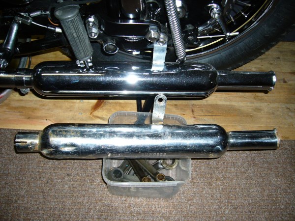

I bought my silencer set from Armours (5 years ago).They fit quite nice except the brackets were about 15mm too far back.
This makes kickstart to hit silencer sometimes , just a bit.
These silencers are also little bit shorter.

I attached a picture , can you people see it?
It doesn't open in my view.

Yup, picture ok for me.
