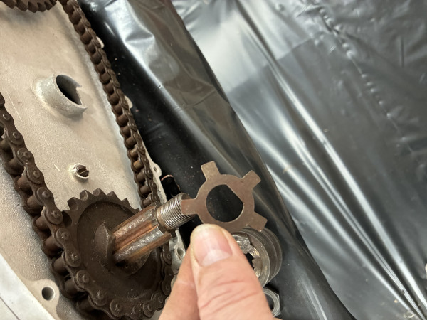

I am rebuilding a 1939 VG 500 ohv.
I had the engine rebuilt by someone else over 10 years ago.
I am finally putting the bike together and have come across an anomaly with regards to the mainshaft and the spare parts book.
The bike was bought incomplete so there may be some parts not original.
The spare parts book shows a locknut washed with a straight edge to go on before the mainshafg nut. The trouble is, my mainshaft is completely round and the straigbt edge locknut won’t go on it.
Attaching pictures if it helps.

That style of washer is designed to go between the two nuts. Put the first nut on and tighten it up and then put the lock washer on followed by the second nut. The ears of the lock washer bend alternately over the flats of the two nuts.

It may be the angle of the photo but it appears that there is a flat on the shaft at 7 o'clock.

Thanks for the replies.
Simon - Noted on the locknut washer. Interestingly the book makes it look like the locknut washer goes on before the 2 nuts, but between and alternating the tines makes more sense.
Roger - I am a blind idiot! there is a flat at 7.
