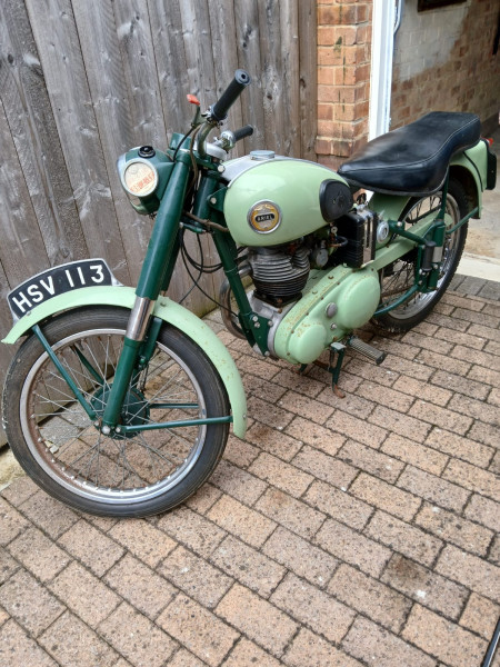

Hi all. Many thanks for access to this forum. I have an Ariel Colt 200, which has an electrical fault. No ignition however I have power to the horn which works ok. I don’t know where best to start. Any advice would be appreciated. Also looking for advice on where I may be able to get hold of a workshop manual and where if anywhere to buy spares please. I have been told that many parts from the BSA C10 will cross over to my Aerial, is that correct? Many thanks in advance for any help and guidance.

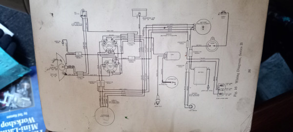

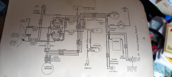

This is a page from the Wipac catalogue - it might help you learn what was originally fitted to your Colt.

There are 4 wiring layouts for 5 years of Colt, details are at the bottom of this page https://draganfly.co.uk/product-categor ... ment-colt/

It doesn't appear to have an emergency start system. The Battery has to have charge. Nev
Re: 1954 Ariel Colt 200
Both ignition switches have an EMG position on the diagrams
Regards Mick
Regards Mick
