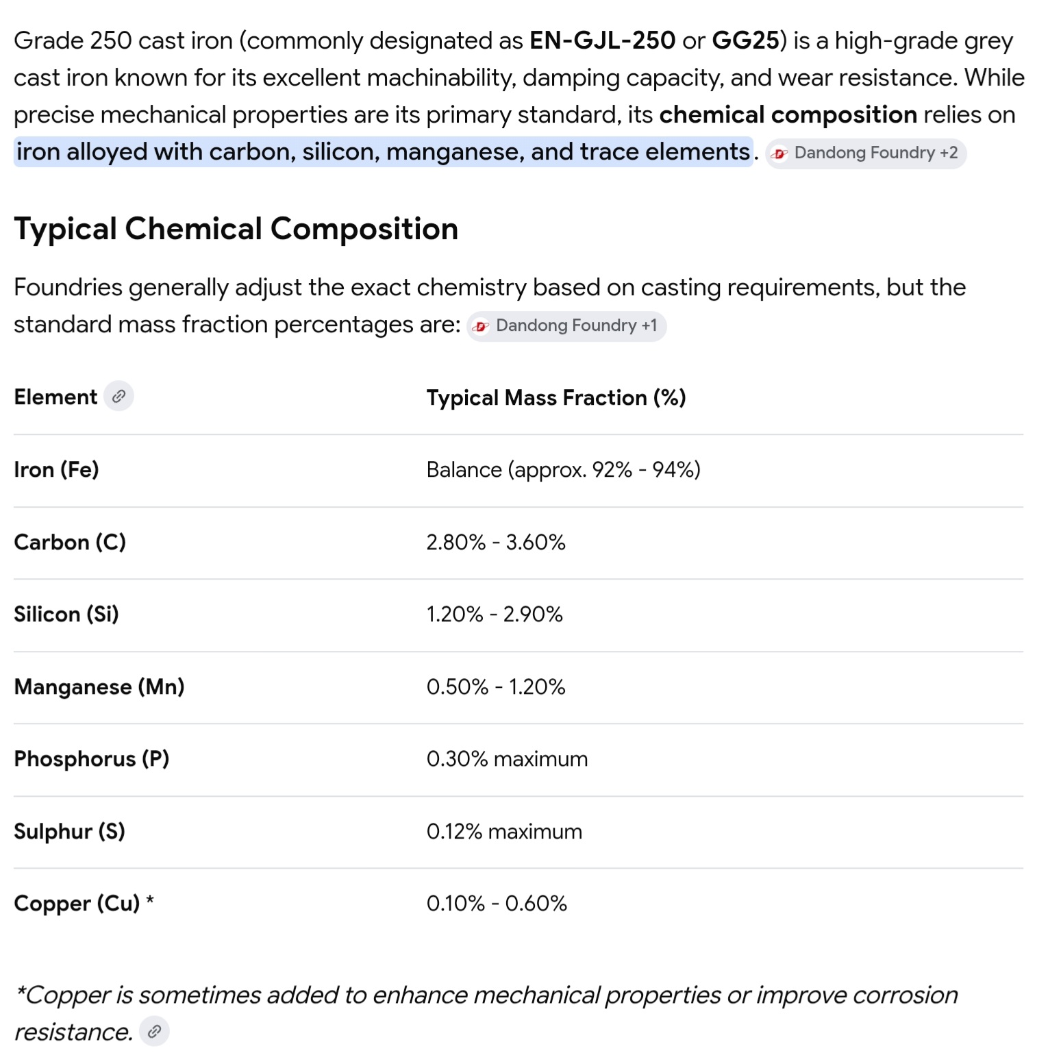

Hi folks,
I'd value some feedback as to whether the attached specifications could make this material a good valve guide choice for an engine with exposed valves and next to nil lubrication. G2 grey iron has been recommended, but is not available anywhere in Australasia as far as I can determine.
Thanks,
Bevan

It's not just the chemical composition . it's How it's cast .The carbon is NOT alloyed with the Iron which must not be steel. Cast iron is Like a fruitcake with bits of free carbon here and there and the fe is not hard. The tensile strength is quite Low. Don't use anything like window sash weights as they May easily have some scrap steel in there and Hard spots called "diamonds" that will blunt your drills and cutting tools. The free carbon Helps to stop Galling of the valve stems which is chronic if they are of stainless steel which has not been nitrided. If the stem galls it will wear out in no time flat. Nev
