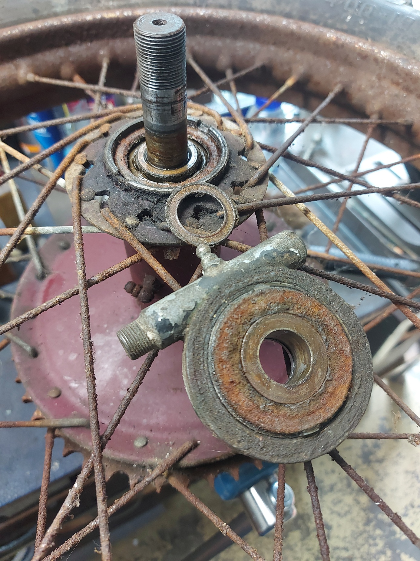

- Posts: 4814
Re: HT5 Rear Wheel

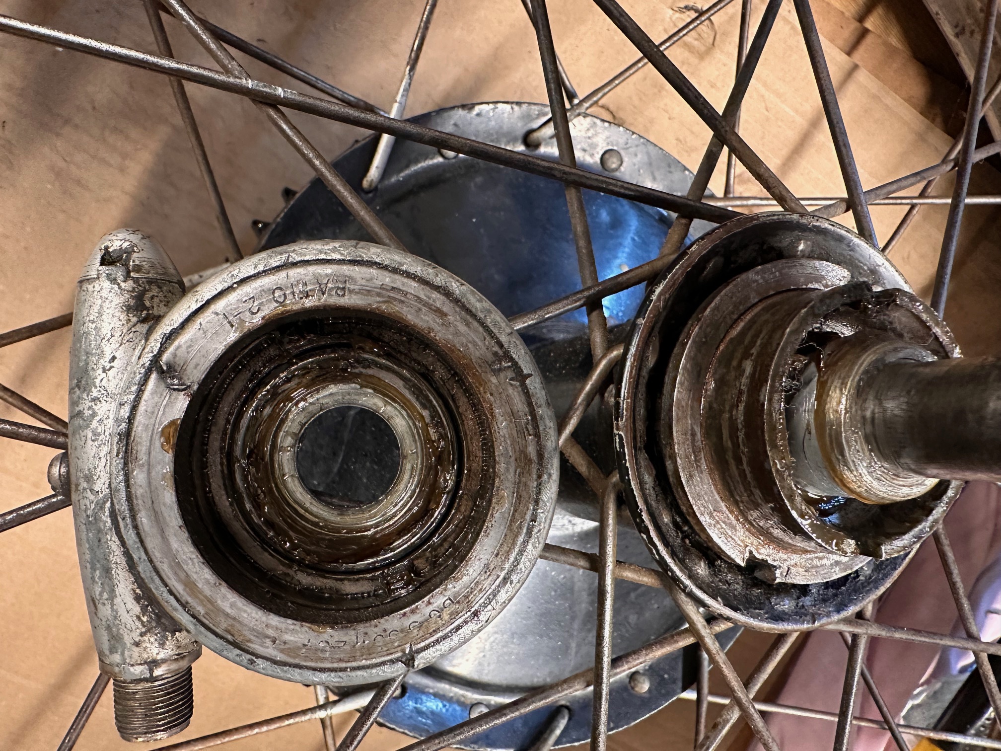

This was how mine looked when taking apart.

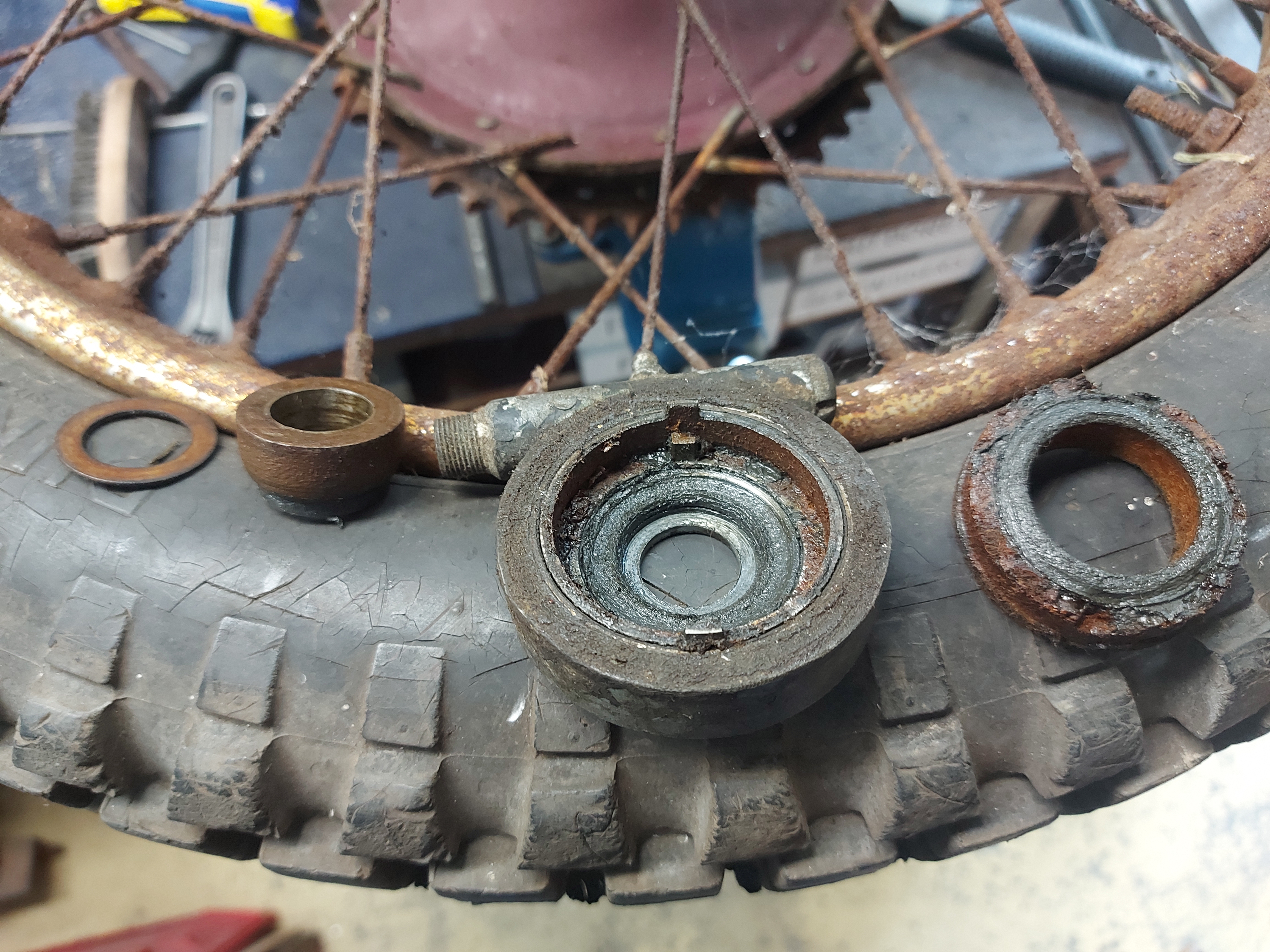

Re: HT5 Rear Wheel
This is mine - '56 to '58 (Type 16)
The spacer butts straight up to the speedo drive

Hmmmm, that set up looks very different, dished Ariel spoke flange and newer(?) type of speedo drive that has it driving cogs further inside.
The hub I have is a mix of Ariel drum and BSA slotted small flange, but I have seen the type you have also.
Perhaps the competition department used anything they could lay their hands on
