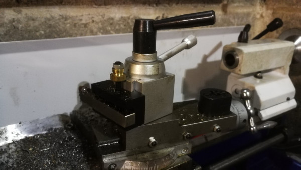

On to quick change tool posts: I had one of these for a while; the 'quick change' bit works fine, but the 'toolpost' bit less so - they are aluminium and have a smaller footprint, so they do wobble especially when parting off.
I'm currently using this all-steel 0XA toolpost, which is much better:

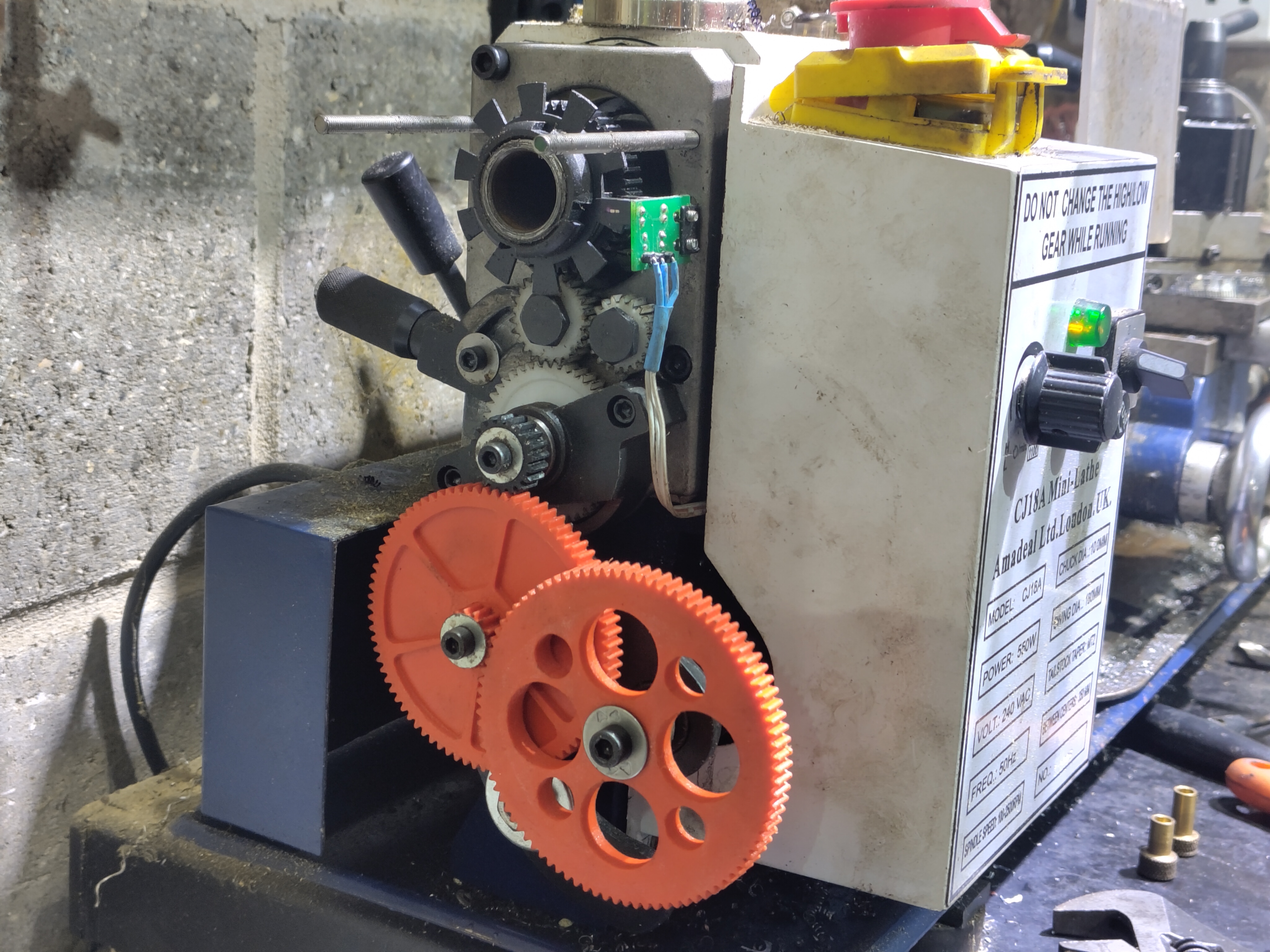

Ted's book is one of the best reference works for users of these lathes - I've done his recommend torque upgrade recently, which is basically a larger motor pulley & works well. I've also changed my feed gears - not quite in the way he suggests, but using some 3D printed gears I had done locally, reducing the minimum feed by half.
