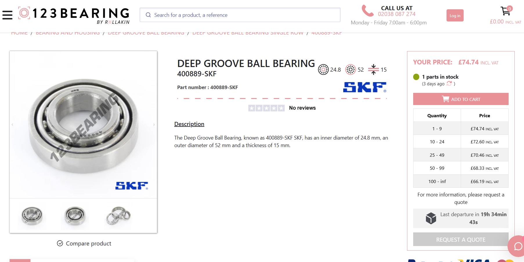

Thanks Jess for the support. I have been discussing this with Jess, and Richard T in the Forest, and the conclusion is, If the crank goes at the moment the bike is pretty much scrap. At the moment, the approximate cost of rebuilding a crank is around £750 to £800. So, as Jess has indicated, I am trying to source a solution that is both a "good fix" and at a reasonable cost, to the bike owner. At the moment, the biggest issue is the main journals wearing, causing the mains bearings to be sloppy. I have found a supplier in the UK who can supply a reduced internal dimension bearings of 24.8mm, instead of the normal 25mm. This would prove to be a good low cost alternative, and keep the bike original, IF the rest of the crank is ok. The roller bearings for the CON ROD can be sourced and if the existing con rod, looks to be sound, the entire crank assemblty can be taken apart and rebuilt. Then, the smaller I.D bearings can be used, to good effect. I attach a screen shot of the bearing supplier but the bearings are over £70 plus vat plus postage. Incidentally, the cost for machining the journals, replating them to original spec, is about the same. With help from club members, Richard and Alan, I have found a couple of guys local to me that can do the above BUT as usual, it takes time. Possibly 3 months delay! I have spoken with the ARIEL OWNERS CLUB COMMITTEE and I am hoping that they can fund the first batch of 10 cranks to be done and put into stock. The real problem is, the stock of original con rods is running low, so what alternative do we use? and what knock on effects relating to different con rod lengths cause. AND will people accept a single solution to this problem as the last thing we need, is different requests for different con rods to be used. I think for general bikes NOT racing bikes, the single agreed approach would be the simplest and keep the cost down. Well, what are your thoughts on this?
