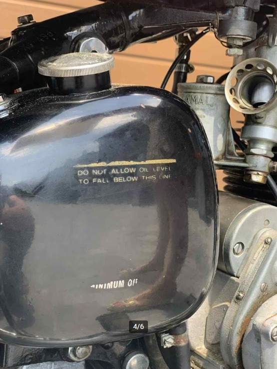

Looks o.k. few parts from a later date as the oil tank and GB box.
Forks look to be WNG, those are up to 1947 I believe.
Handlebar looks like a WNG or early postwar as no rubber mounting.
I think the front brake is the prewar 7" 'floating cam' type,
cant really see but I think the spokes come from the drum, so much earlier.
Chronometric is with trip meter and in the position of a WD one.
Panel tank with a DIY panel, you can see the filler cap protruding .
Proper horn in the proper place :D
A bit of a mix but it looks as a working bike.
