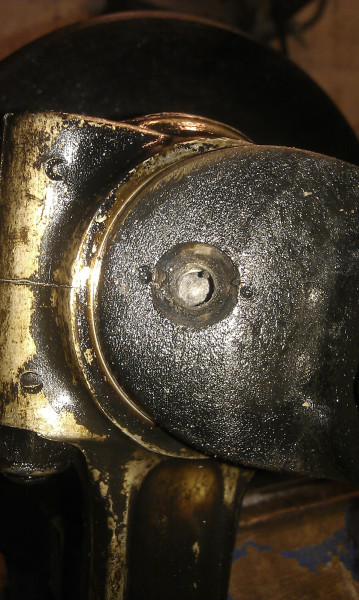

Posts: 5158
Re: Going back to the way it was
This is what it looks like. That black clay-like plug goes all the way to the #4 big end oil way - fortunately, this engine was stripped and cleaned following advice on this forum and has performed beautifully ever since - about 4500 miles now.
Posts: 4814
is this a before picture ?
as it looks like there are no rocker spindles...
(pic on top of this thread)
Posts: 5582
That plug is staked in. Easier to remove if the staked bits are ground away first so the thread is not fouled. Drilling them out is not fun. Avoid the need if possible. A sharp crack with an engineers Hammer on a brass drift on the face of the plug can help to start it moving. Nev
Posts: 5158
Vincent.vanGinneke wrote: Fri Jun 06, 2025 11:05 pm is this a before picture ?
Are the barrel flange nuts missing as well?
Posts: 5582
I'm confused. That's an alloy Connecting rod fitted to a crank throw. Nev
