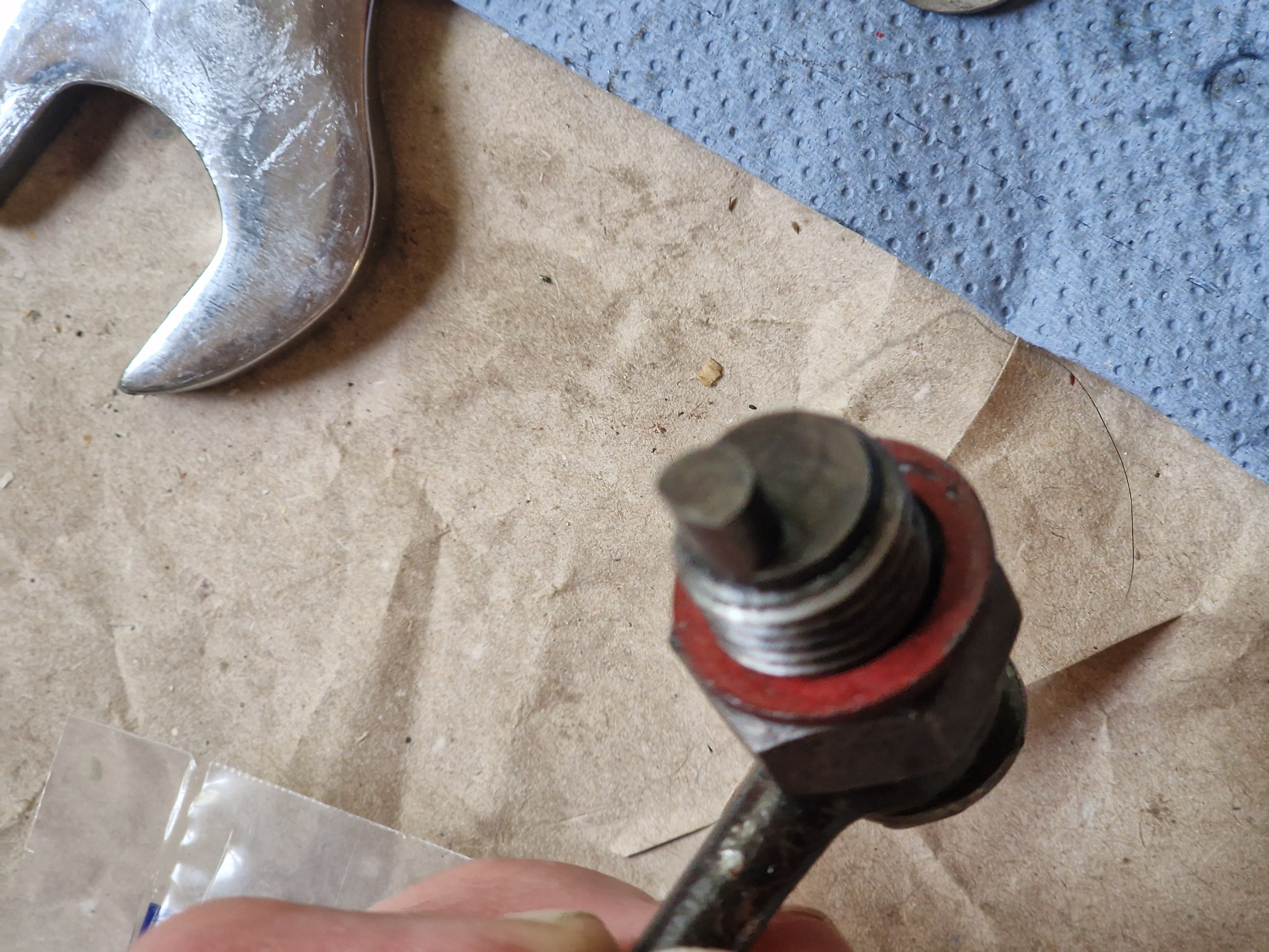

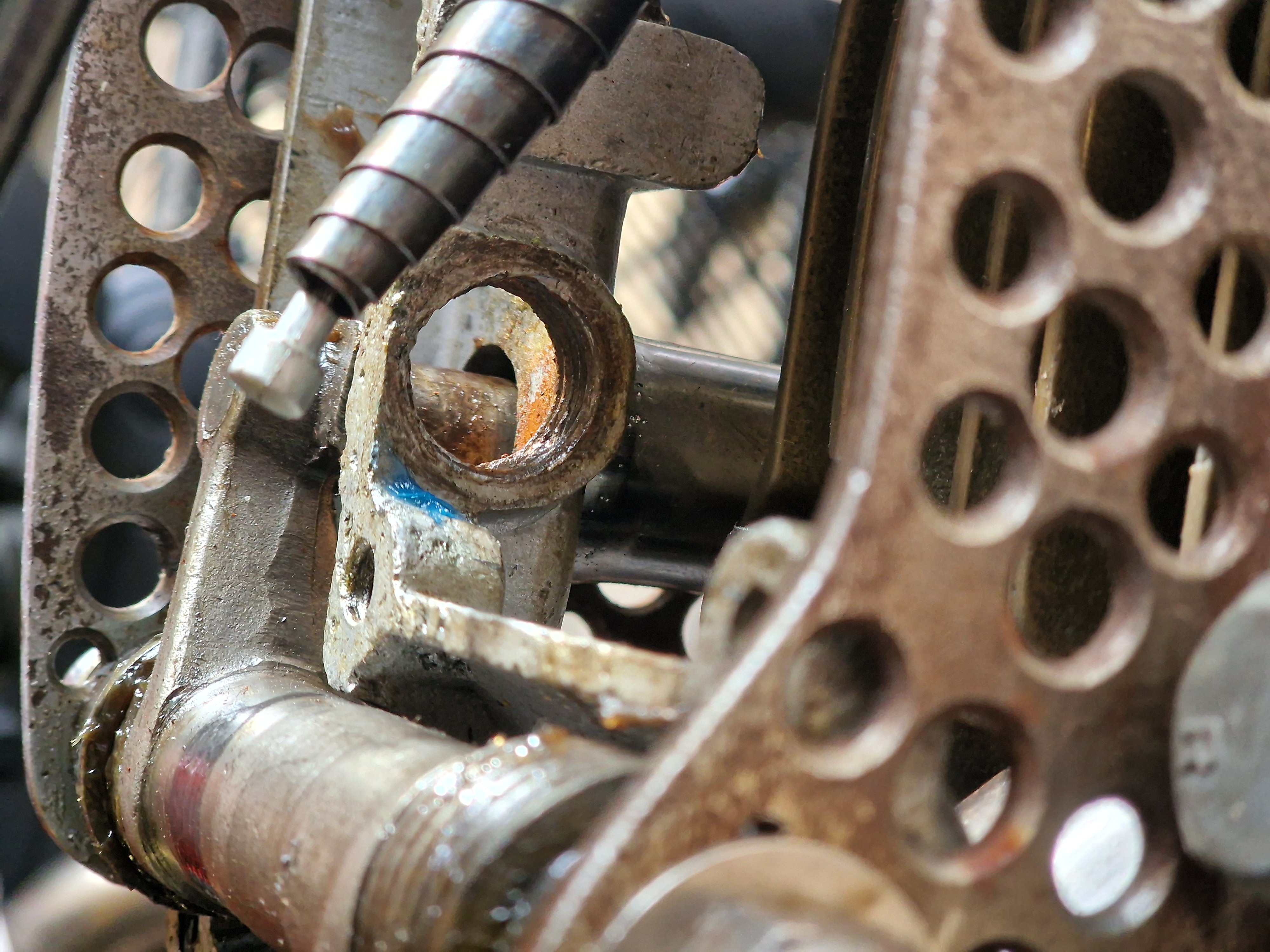

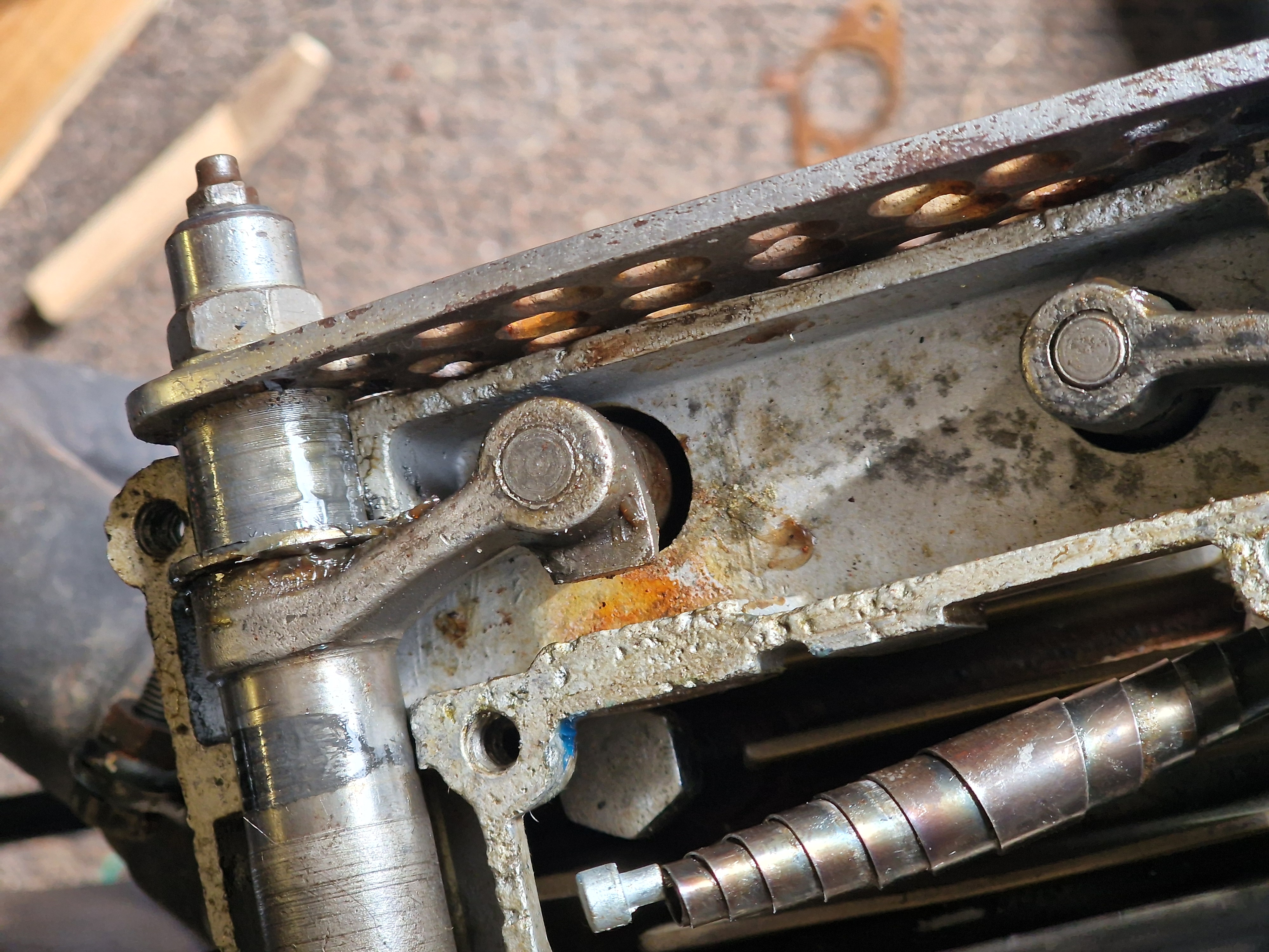

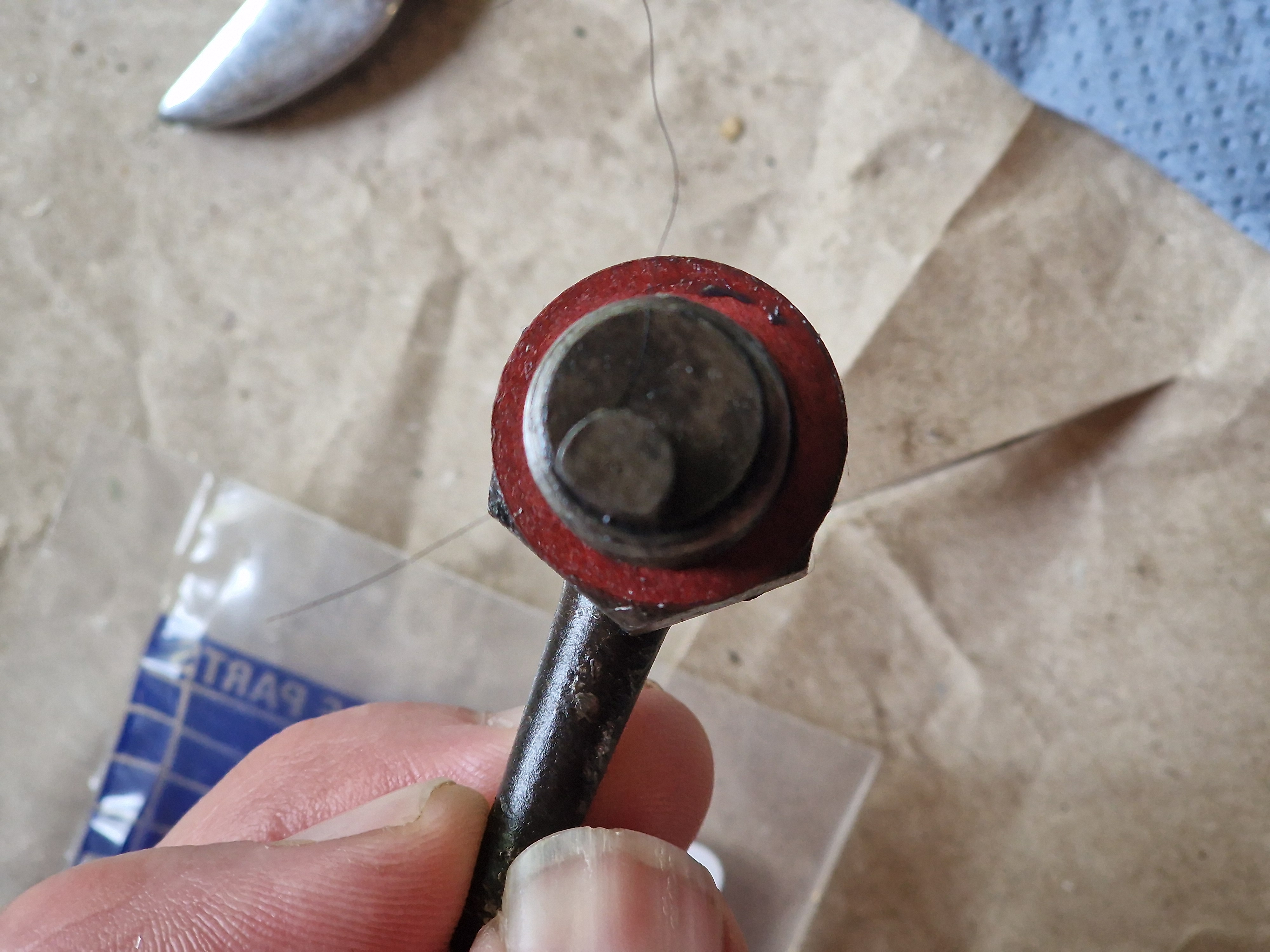

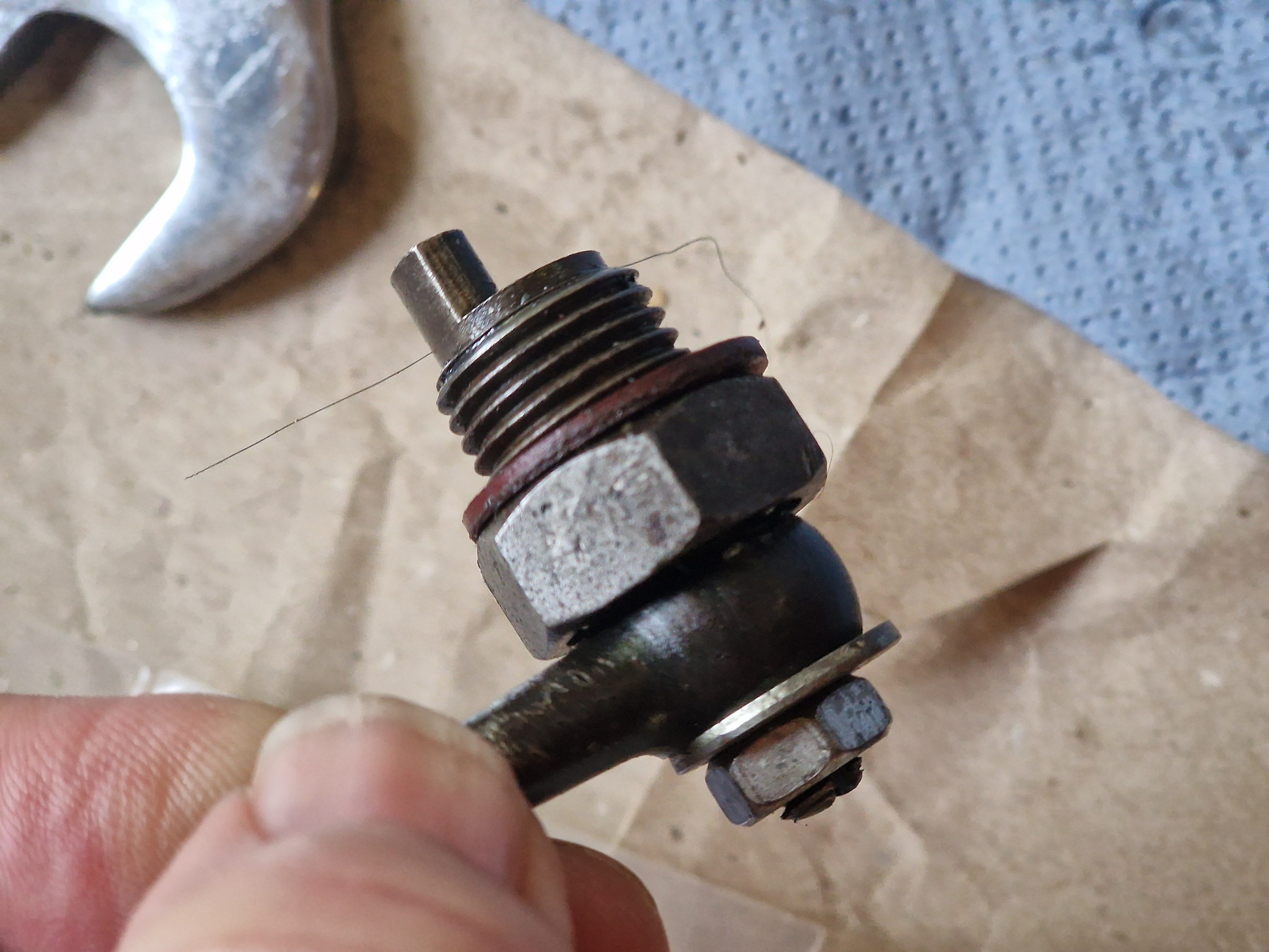

Afternoon all, having played around with setting the lifter against the rocker and tweaking the angle of the actuator arm I have managed to get the valve to open a fraction enough to decompress, this may be enough though I am concerned that the lifter cam is engaged on the rocker arm permanently!
Please see photos attached of the head and the valve decompressor, I would welcome thoughts on if it is significantly worn, there is a little 'play' when I actuate it.
I have a bronze head on it, which I believe is closed - there is a rocker cover over the top of the push rods and on the valve gear.
Thanks for all your help
Regards
Graeme
Posts: 5567
Re: Exhaust Valve Lifters
Has the valve end got a cap on it? The valve seems too short. When the valve is 1/2 open does the valve axis meet the contact point and pivot point at a right angle, 90 degrees? Nev

Post by paul.jameson »
You have what is known as an open valve head, correct for 1937. Looking at the valve gear for my 1937 open valve head I see no obvious difference in the amount of wear which should mean it should be possible to adjust your valve lifter satisfactorily. But Nev's point is very relevant. A bronze head and rocker side plates drilled to resemble swiss cheese tell us that someone has been tuning the bike. They may well have fitted a non-standard exhaust valve which could be shorter than standard, hence Nev's question about the valve stem end cap which if present would effectively lengthen the valve stem.
The other possible item to question is your valve lifter cable. At the Long Distance Run last weekend we had trouble with another 1937 open valve gear 500 being reluctant to start. I found that the valve lifter lever had to be pushed much further round to lift the valve than I would have liked, suggesting that the cable inner is too long. If you are operating at the end of the adjustment of the cable, it might well contribute to your problem. I don't know whether the valve lifter cable for an open valve head is different from that of the far more common enclosed valve head but that could possibly be the case and explain the long cable inner on my friend's bike. On the open valve head there is a cable adjuster under the rocker cover which is difficult to reach but may give you the adjustment you need. An alternative might be to fit a ferrule similar to that on the twistgrip to effectively lengthen the cable outer.
Post by volker.halbach »
It also helps if the valve lifter is in line with the adjuster, so that the cable doesn't become kinked when you push the lever. I believe that the valve lifter for the open head is slightly different from that for the closed head. The nut on my valve lifter for the open head is narrower and the spindle shorter. You have the longer spindle. I assume that it should still work, but I tried the longer spindle and then returned to the old own spindle. But it should work even without the volute spring. If the pin is at the twelve o'clock position when it opens the valve, it will never come back. If that is the case, you need to change something in the valve gear. It is sensible to check the geometry of the valve gear first, i.e., whether the adjuster is centrally over the valve stem and in line with it when half-open. There is no point in adjusting the valve lifter if you later need to modify he pushrods, valve stems, cam followers etc.
