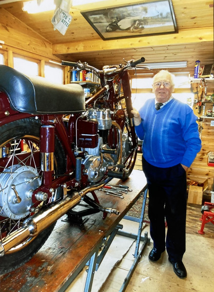

Its true.
The rear mudguard does unbolt to allow you to wheel the wheel out.
Depends how much of a faff that might be, and also getting that all lined up and back together.
Luckily, I have a hydraulic table to lift the bike up so I am not on my knees.
